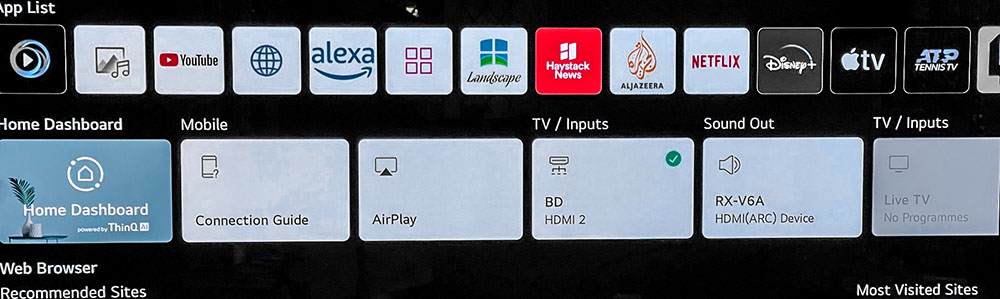

I've had an RX-V6A into an LG C1 for about six weeks now. It has an NZ My Sky connected to HDMI 4 and a Blueray player into HDMI 5.
HDMI 4 on the V6A (the Sky box) is set to 1.4 and Mode 2. I can't check that now because I am unable to display the V6A setup menu on the TV
The signal to the TV is from eARC on the receiver to HDMI 2 on the TV. It has been working fine until two days ago when I was unable to view the My Sky box or Blueray player. I also use MP4 files into the TV USB port and they play fine as does the audio via the V6A. Same with other apps on the TV like YouTube.
When I turn on the TV the receiver starts as usual, but it detects the Blueray (but does not play it. The TV constantly show 'No Signal'
I am also unable to get the V6A Setup to display on the TV.
Simplink is turned on on the TV.
Sound source on TV is set to ARC and to wired speaker
The TV input is set to the correct HDMI port which it is currently seeing as BD. It has previously seen it as Yamaha Sound Bar

The Sky box plays OK if connected directly to the TV
One possible clue is that if I disconnect the HDMI from V6A eARC to TV input the sky box audio starts to play via the V6A
I've tried a different HDMI cable from V6A to the TV
If I turn everything off and turn on first the sky box and then the TV, the V6A will turn on automatically but the TV will always show no signal.
I've been at this for two days now and I'm pulling my hair out. Thankfully my wife is away looking after her mum at the moment, because she would have lost patience long since. So any ideas where to go from here would be greatly appreciated. Thanks

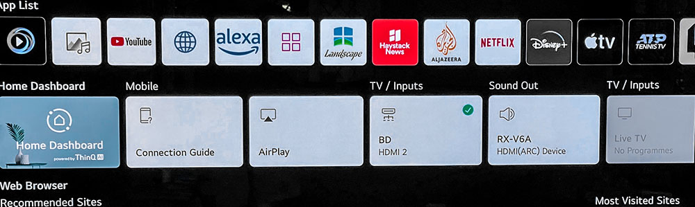

Hi guys
