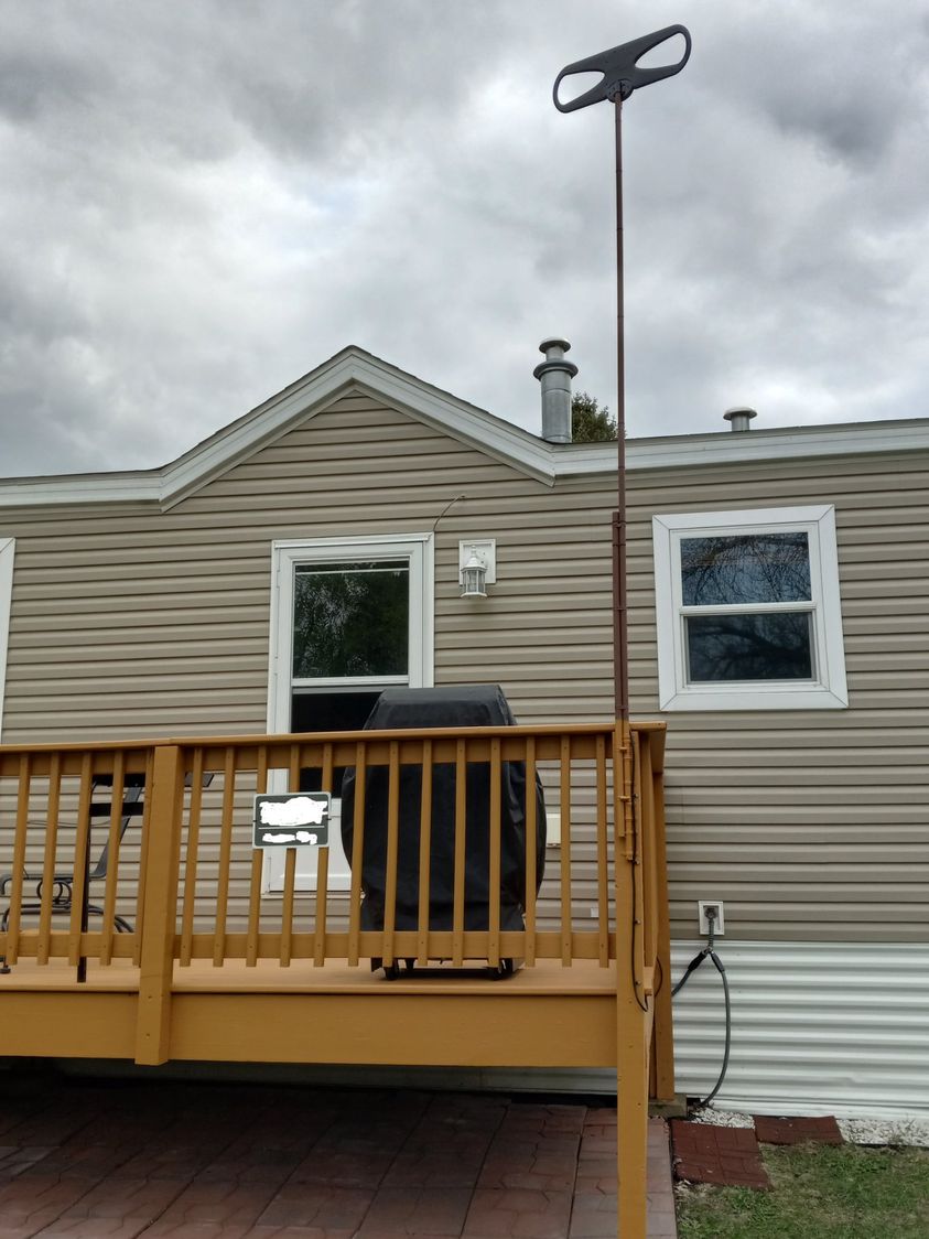

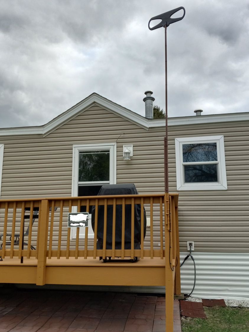

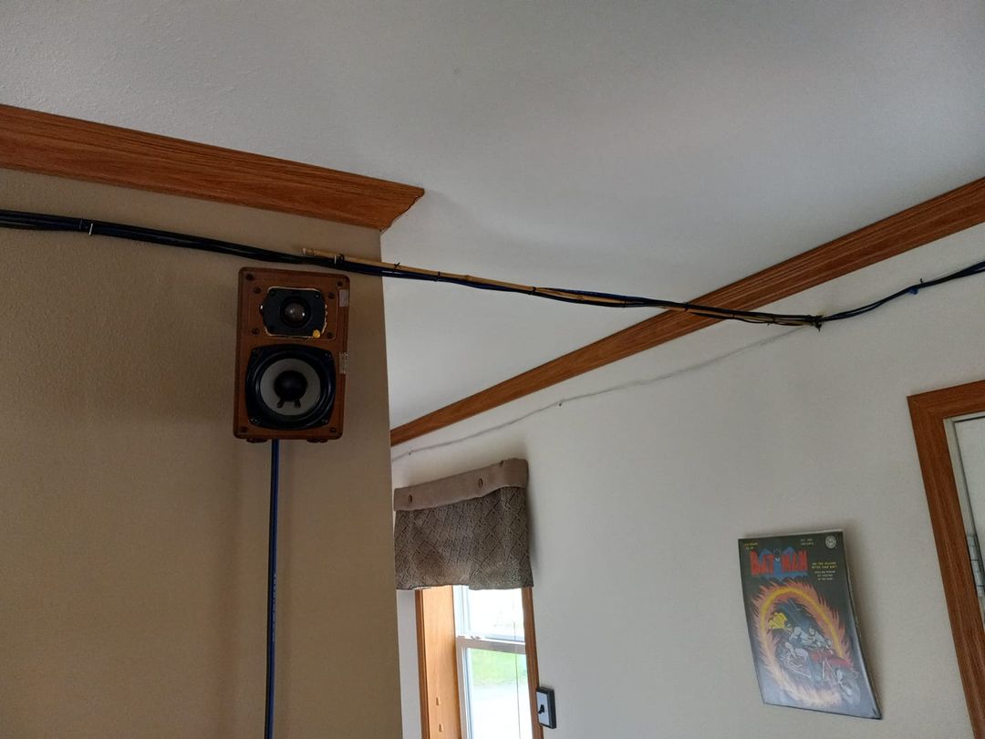

Waiting for Amazon with my compression crimper and terminals. Otherwise, it is done. It works great. After I re-mounted the antenna, I tried it with the new cable just out the door and before I snipped off one end. After running the cable exactly where I wanted it, it was around 48 or 49 feet from antenna to TV. So, good thing I only snipped off the end. I siliconed the antenna end terminal after tightening it. And siliconed around the grommet where the cable enters the house. The bamboo stick over the hallway is where it enters the house. Above the lamp outside, you can see the cable. Thanks for all the help! (Amazon just arrived).
View attachment 56175View attachment 56176
