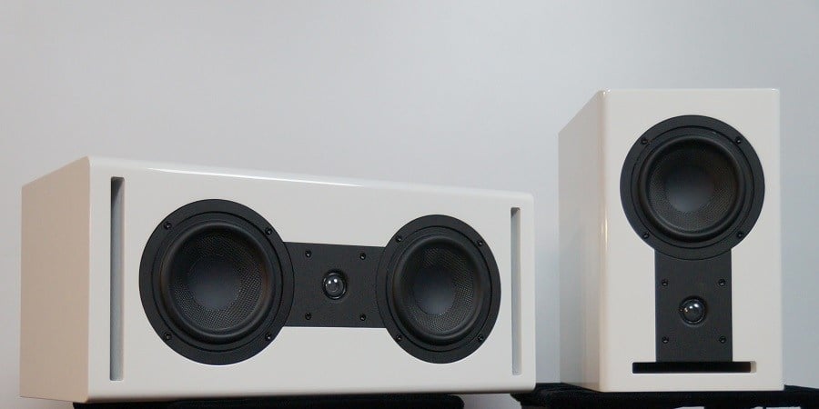

While RSL Speakers might not be a household name, audio enthusiasts who stay on top of noteworthy brands will certainly know about RSL speakers due to their reputation among hobbyists and the general acclaim they receive the audio community. RSL has been gathering a reputation as a source of affordable yet high-fidelity loudspeakers that have accrued an online buzz due to a plethora of positive remarks from professional reviewers and customer testimonials alike. Audioholic’s own encounters with RSL products have found them to be a solid brand, so we were excited to see them enter a higher price bracket when we did a preview article on the recent release of their CG5 and CG25 product line. These are the products that we are going to look at in today’s review where we ask if RSL can maintain the same scale of value and performance while entering a higher price point with their latest offerings.

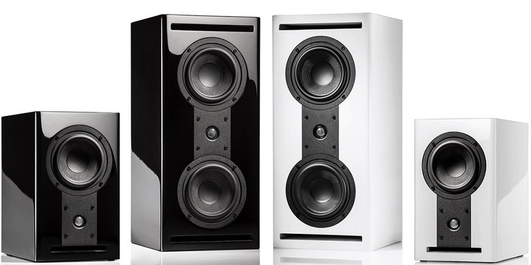

Very interesting Shady. If I were looking to buy I'd probably go with 3 if the 25s across the front and a pair of 5s for surrounds. It looks like they have 2 versions of the 25 for vertical and horizontal positioning?

There is only one CG25.

Oh! In the pic it's hard to see the second port/slot on the black one! I assumed they were different designs, lol.

Those speakers look gorgeous bro I love the look there on sale now too which really makes them a very intriguing option

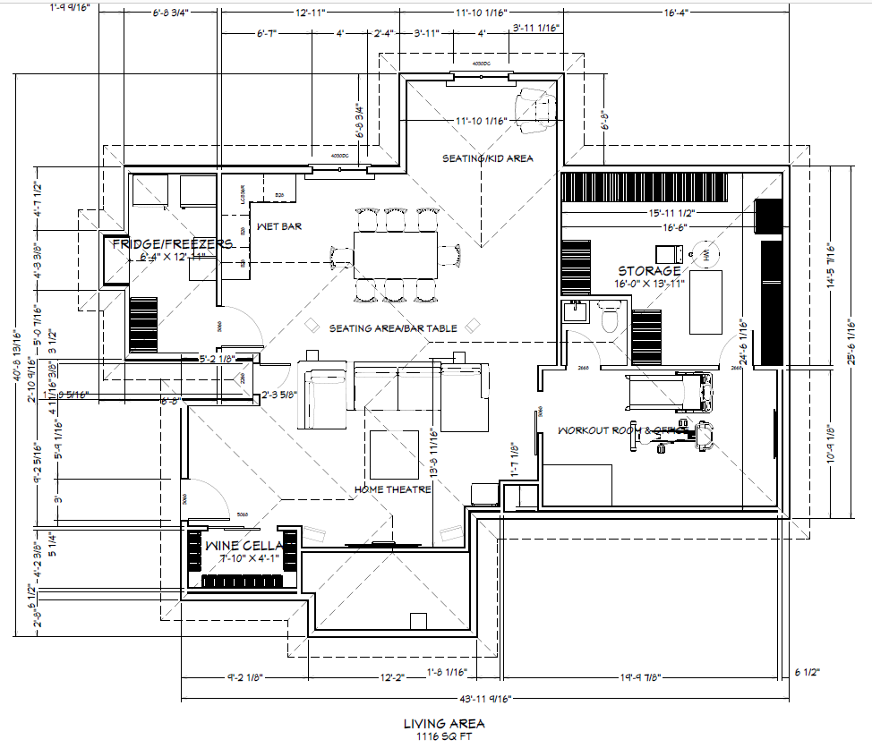

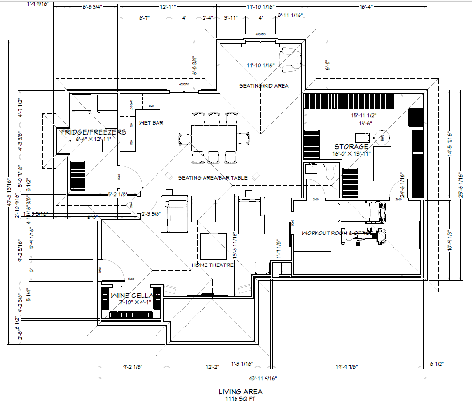

I am really like what I am hearing about these RSLs and they look great. I am leaning toward 3x CG25s for the fronts and I am debating about CG3s or CG5s for the surrounds in a 5.1.4. I will be using the C34Es for the 4 ceiling speakers. I would be using this system for watching movies, gaming and also listening to music. I would imagine that for movies there wouldn't be as big of a difference what I pick for surrounds. I am guessing that there would be a larger difference for music though? It's a decent price jump from the CG3 to the CG5, but I would do it if it's worth the performance jump. Attached is a proposed (this is for a basement that we will be finishing) layout for the area. I would likely have to mount them directly on the wall, about 3 feet above ear level and at 90 degrees to the couch with primary listeners on it. It's a large space that is open on all sides, so my primary concern is making sure that the system will fill out the space and sound as good as possible.

I would go for the CG5s as surrounds, and I would mound them such that the tweeter is below the woofer, and the listener is below the tweeter but not at an angle more than 30° below the tweeter, as is outlined in the review.
