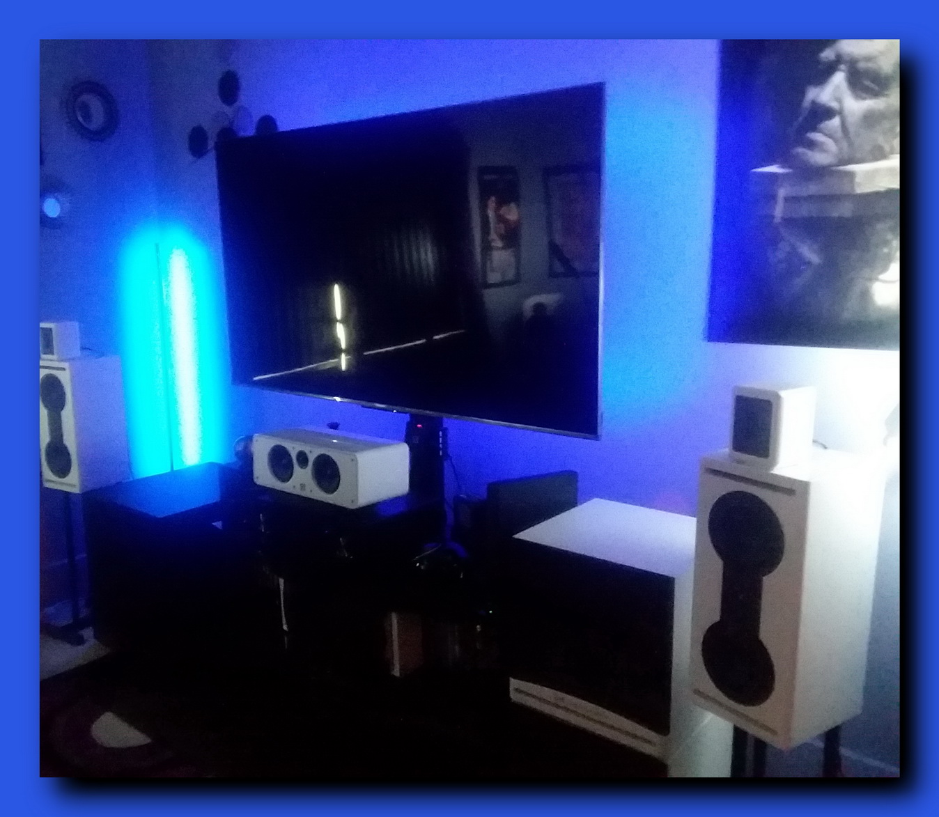

12S on the left...2 stacked 10S's on the right.
I use the high pass crossover on the 12S to feed the two 10's at a higher frequency.
This works exceptionally well...the 10E would work fine also.

Alright, that's what I was hoping for. I'm waiting for the 10E and my new 12S amp which died somehow. It was working fine and then not. Right now I have no sub at all. They immediately said we are sending you a new amp. Again customer service from RSL is out of this world. The guy has me so 1 test on the amp and said they are sending me a new one and then a test on the driver but that is fine.
Anyway now it's a waiting game January 3rd both are due to arrive.

Running the 10S and 12S isn't ideal. They have different port tuning frequencies. You generally do not want to mix ported subs when the port tuning frequencies are different, because you can get phase conflicts at band of the higher tuned sub, and you can also hit bottlenecks on the system below the port tune of the higher tuned sub.
