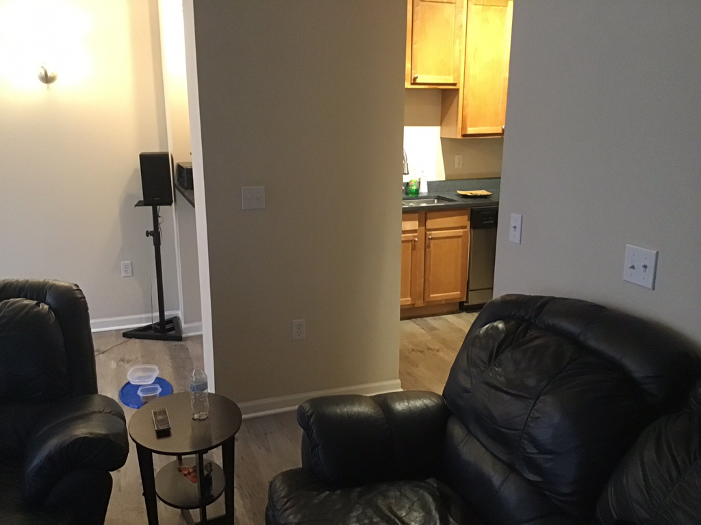

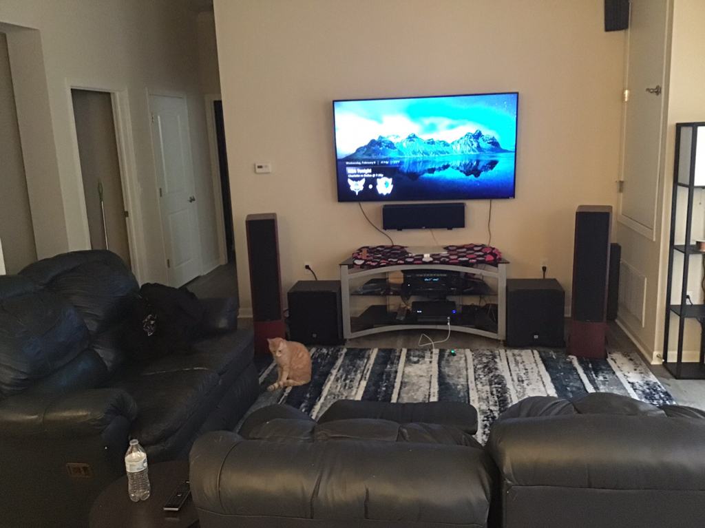

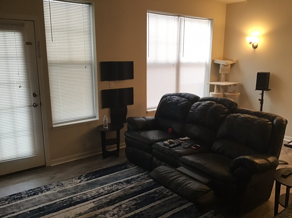

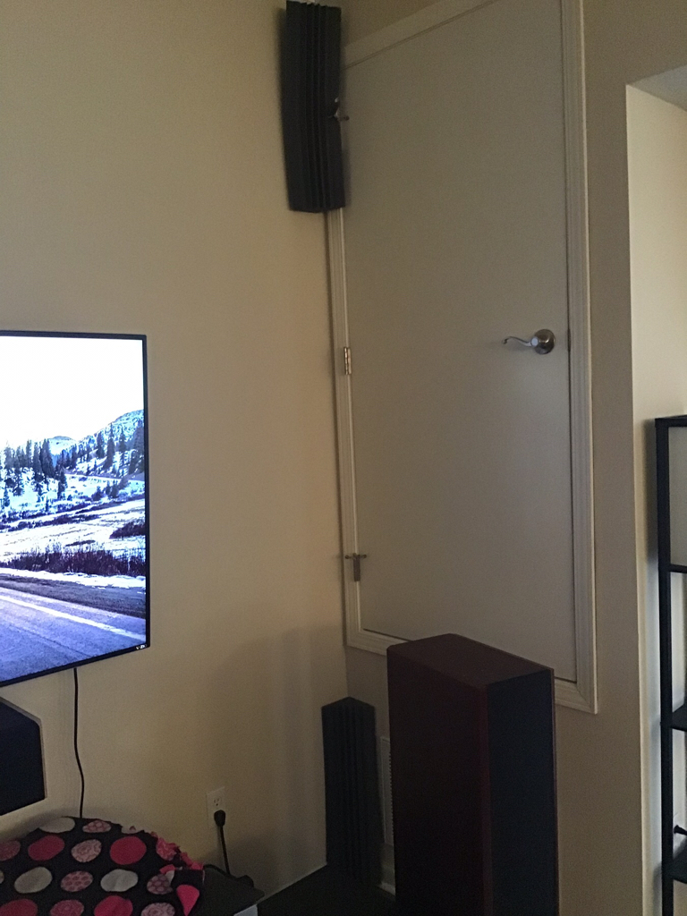

Yeah, it's a big living room. It's a two story house, and framing and concrete can get expensive, so they leave it as one big open area. I live in South Florida. We have to build out of block and concrete for hurricanes.
Top image is the view from the listening position. The subs are positioned on each side under a table. They're 12" subs. I've experimented with them inside and outside of the mains. I positioned the subs on the inside because I experimented with the mains on the outside and I noticed a tad bit of improvement with the mains. I may be building a new cabinet soon. I wondered if incorporating a sub from Dayton or something might be helpful or not.
Image 2 just shows from the main position to the left. It's hard to put a sub in that corner right next to the front door.
Image 3 shows to the right and the opening into the next room. Same issue with putting a sub in that corner.
Image 4 is from the from the door into the room. You can see the stairs. The recliner where my daughter is sitting marks where I have a reflection point. I try to keep something soft on top for what little help it gives me. That table in the back corner is probably going to go. It was in the center of the room but after taking it out to paint, the wife decided she liked the open layout and wanted it out of the way. I haven't had time to get it out of here. I've thought of putting one sub in that corner, but I don't know if it will affect the surround speaker right above it.
Image 5 is from the opening back into the room. Pardon the clothes. Saturday is laundry day. For a while when I only had one sub, it was in the corner behind the sectional. But with only one, i think I had to turn it up too loud and the wife complained about it being too bassy where she sat (adjacent to me in the listening position. I can put one there again easily. When we moved in, I ran a sub cable to that corner. I moved the sub to the front and added second one a while back after she kept objecting to the bass. The bass has improved much since I added the second. I haven't had much complaints lately about it, but with the size of the room, I think I'm missing out. I think I should be feeling it a little more.
The wife loves the home theater. She can't watch tv without it. We have sound panels all around because I told her it would improve the audio. She just couldn't handle the sight of bulky 4in panels, so we only have 2" ones though. Perhaps if the bass were set right she won't be as sensitive to it. Thanks for the help.

Yeah... Ya need bigger subs! ;) Like 2-3 15" monsters! That's almost 8000'3, with a lot more open area. Read this article too: bassaholic room rating. and before you add an extra sub, learn about using multiple subs! Always best to keep them matched for better performance and less acoustic issues. ;)
First things I see, with the amount of large reflective surfaces would be curtains on the windows. Diffusion might be better behind your LP, and can be done DIY, but shelves with nick-nacks might do as well. if you are getting a lot of highs... try some of those panels behind your main speakers. Your first reflection points are pretty valuable acoustically and its not always advised to put absorption there. Maybe some area rugs in front of the speakers... keep what you have on the floor by the couch but treat the floor in front of your mains.
For the subs... one by the chair and table under the stairs could be a good option, especially with that table gone, you'll have a good amount of space to experiment with.. I still think you could benefit with one behind the couch. I know, a lot to move, but if you can, pull the couch forward one day, and do the crawl... just see what it might sound like with a sub back there. In between the door and the sofa could be a good spot, but again, crawl it out. Its crude, but you WILL hear it if its a good spot!
Your sub will not interfere with the surround.
Beyond that, ask questions! like you are, but start your own thread. and don't put the emphasis on room treatments, some people tune that out. But you do have some really good space to work with, its just a matter of finding those balances.
One other thing I see that might help out in general, is with pulling the couch forward a little, you'll get some better imaging from your side surrounds. Ideally, they would be a little behind you and aimed at LP.
Hope this help give you some ideas!

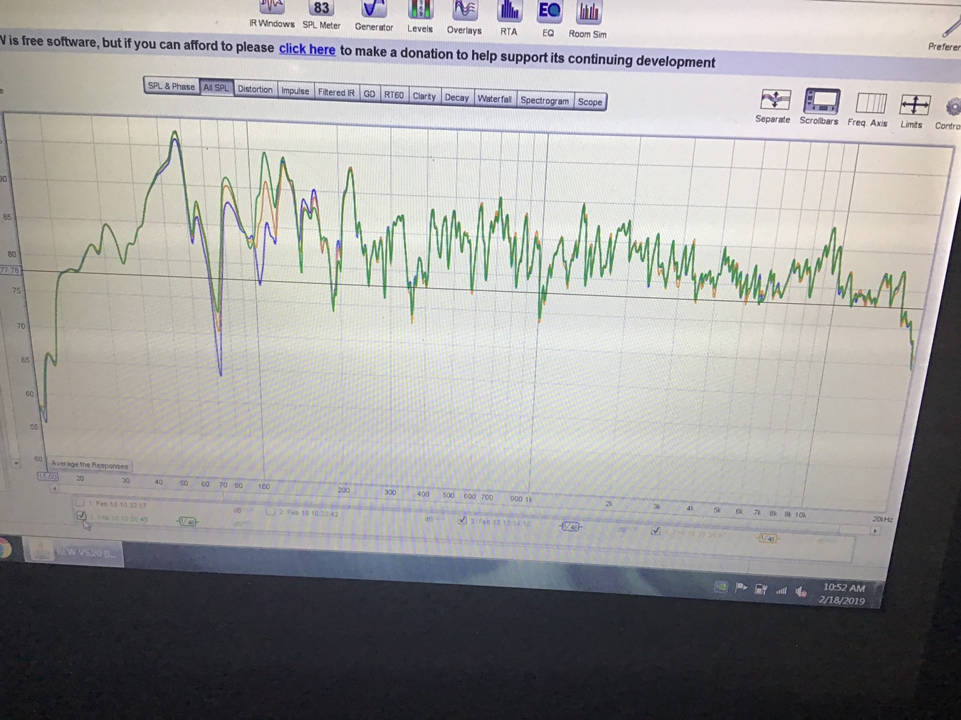

Will do. I just posted my graph , I thot I’d add it here too and see if you had any thoughts.its at 85db with Audyssey off. Blue is crossover at 80, orange 100, green 120
ryanosaur
ryanosaur
I'm not an expert with REW... not gonna get ut until after my real mains are ready in another month or two.
To make it easier to read, I know some people have talked about applying smoothing to the graph, but I don't know the proper setting for that. Theres also a trick to save the graph as an image that you can upload straight away.
Do a forum search on it, you should find some good help... Likewise don't be afraid to start a new thread for using it. There are some cool cats here that no the program and acoustic stuff far better than I. :)
What are your main speakers and subs? Don't recall if that ever got included here.
