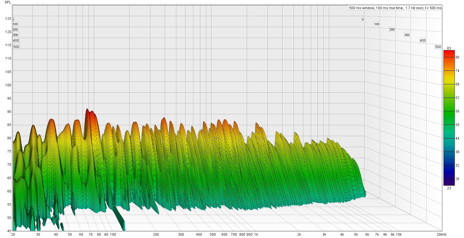

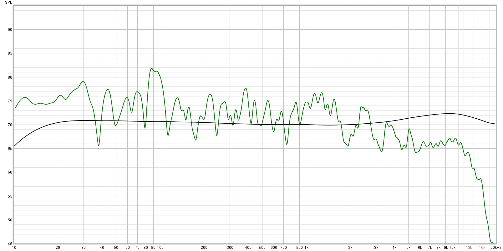

The bass decay time below 50Hz doesn't really matter too much. The wavelengths of those frequencies have an inherently long duration. That curve is very choppy though, it is almost as if there is some kind of comb-filtering, like there is a phase conflict. You need to make sure everything is playing together in phase.
That is good, but the Y-axis is still a bit wide. Limit the top of the Y-axis to 95dB.
Possibly the Fireplace reflections. It extends 2'9"x6'1" into the room floor to ceiling about 5'6" in front of the right speaker. My seating position is about 10' off of the back wall the 2.7s are about 34" off the front wall. It could be reflective wave cancellation from the rear wave reflected off the front wall.

Oops I lied. The graphs above were taken with just the 2.7s and the associated woofer cabinets. Below is with all subs turned on;

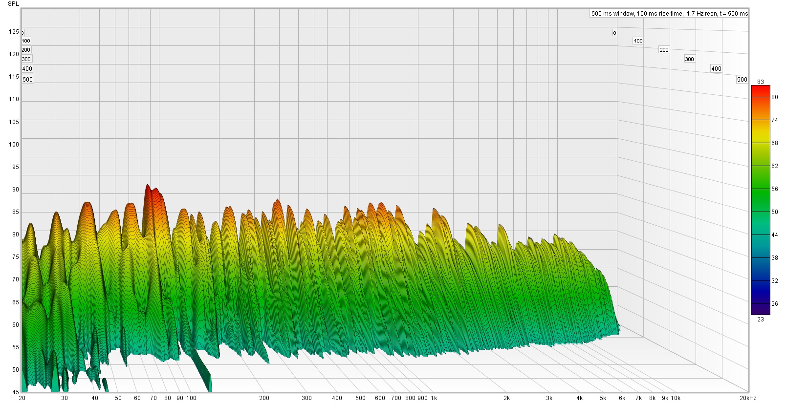

Treating sidewalls would probably be a waste of time with those speakers since they are so directional. If it were me, I would put some absorbers behind the listening position and behind the speakers. I wouldn't worry about ceiling or floor reflections with those speakers.

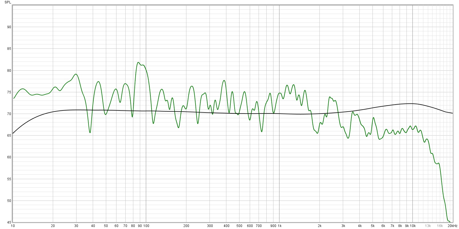

The waterfall plot doesn't really help much. A basic frequency response sweep with a 50dB window would be a lot more helpful. It looks like the bass is pretty rough in there though. You might want to think about getting an EQ system for the low frequencies.
I was thinking the same about the bass situation. There are some opportunities there for sure.
Yeah, you have a pretty jagged response. Have you experimented with room correction or eq? How about positional eq? Shady's right, the waterfall graph isn't really useful at this stage, but I will say it does look pretty clean. Just need to get that fr straightened out some.

I think the graph might reflect the fact that your speakers are dipoles, including the subs. That explains the comb filtering that appears to be going on. Trying to eq the interference out seems a fool's errand. With such directional response and speakers that inherently involve the room to a greater degree, I expect placement to be of utmost importance.

I think the graph might reflect the fact that your speakers are dipoles, including the subs. That explains the comb filtering that appears to be going on. Trying to eq the interference out seems a fool's errand. With such directional response, I expect placement to be of utmost importance.
I was thinking the same thing. If ShadyJ thinks there may be a phase conflict, speaker positioning is the first thing I would try. That fireplace might make the room a challenge but not much you can do about that.
