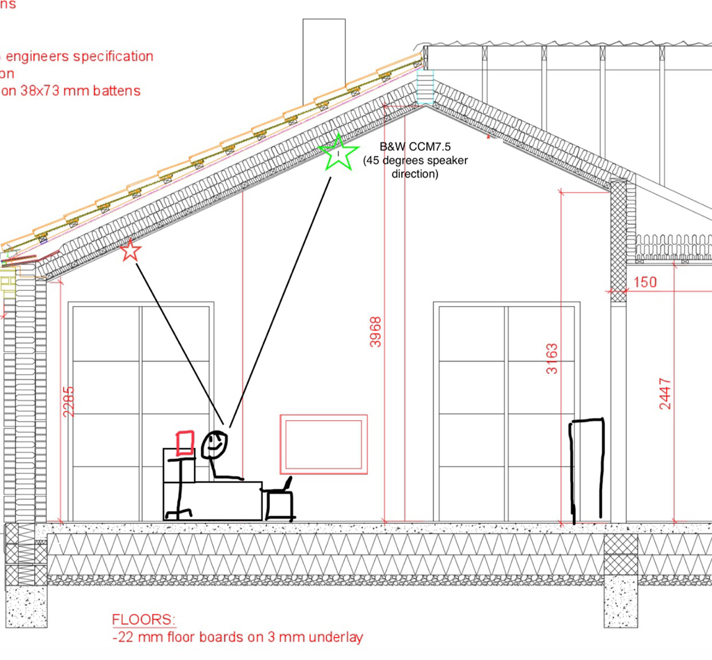

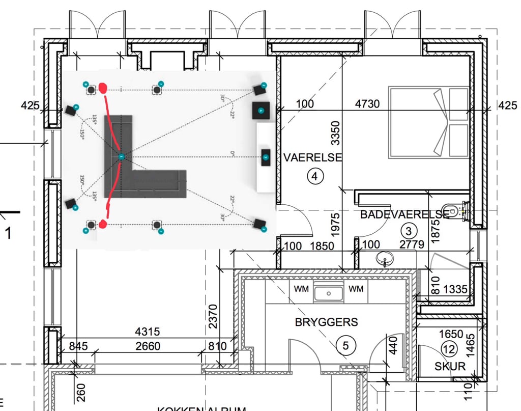

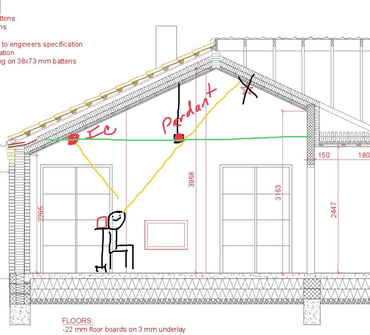

Hi All,
I was wondering if someone might be able to help me with some acoustic advice for a new home theatre setup in a new extension I am currently building onto my house. I want to setup a 5.2.4 surround setup. One of the key factors is also that the space remains a lounge area and not predominantly a home theater.
I have been doing a lot of research an can see that sound in a room with a vaulted ceiling can be challenging so I would really appreciate some help from any professional out there.
The room is a 40m2 room with 4 meter to the apex of the ceiling and a ceiling angle of 25 degrees.
I am a little concerned about the room acoustics due to the vaulted ceiling and was wondering what peoples thoughts were with regards to at atmos setup in this type of room? I am planning on putting 4 atmos speakers in the ceiling (Represented by the star on the cross section)
What are your thoughts about this? I would really appreciate any thoughts on this and recommendations with regards to sound optimisation in the room. We are planning on installing an acoustic ceiling to help improve the echo in the room using a category C diffusion ceiling board.

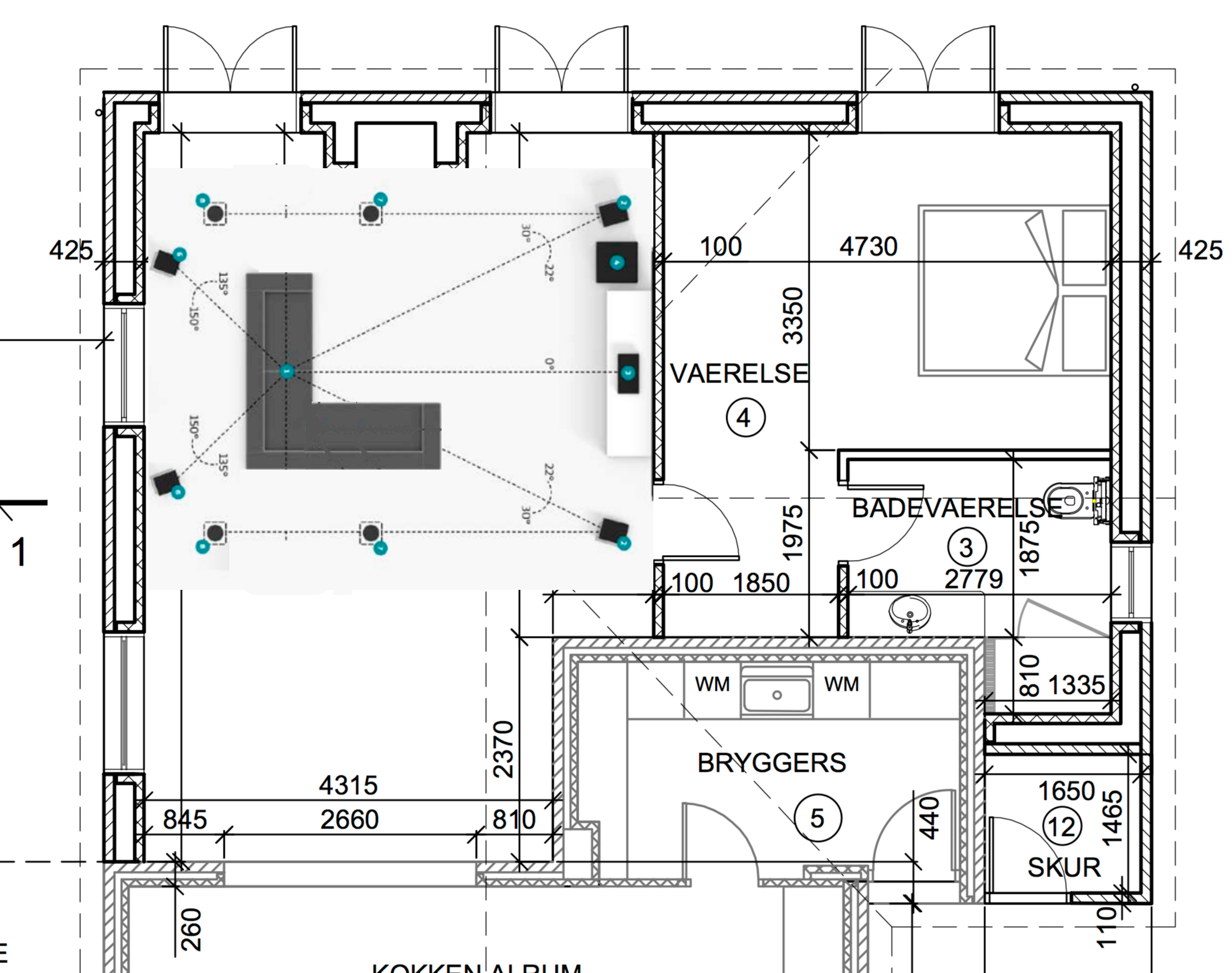

As for the surround setup I was planning on the below setup:
Speakers:
Left/Right:
B&W 704 S2 or 702 S2
Center: B&W HTM71 S2
Surround: B&W 707 S2 (Maybe B&W CCM682)
Sub: Arendal Sound 1723 Subwoofer 2 or maybe (2 x subwoofer 1)
Atmos: B&W CCM683
Reciever:
Denon X4500H or Marantz sr8012

Vaulted ceilings can actually be somewhat friendly too: it breaks up all the parallel surfaces.
One friend here has his Atmos set up in a large room with vaulted ceilings too. Totally doable! Hopefully @William Lemmerhirt will stop in with some input too.
More than anything, I would recommend making certain your subs are up to the task. LF soundwaves work differently than your standard speakers, where distance-from is more important. LFs work on room volume and will go wherever they please, so if you have a very open floor plan, you need to consider that, too. That said, you don’t need to pressurize the whole room, but s second sub, and proper placement for both is key to having good bass response for your listening area, not just your main seat.

@ryanosaur nailed it, with the lack of another parallel surface between floor and ceiling, smoothing out bass from seat to seat is made easier.
But when it comes to dealing with bass, the reality still remains, that the room is in control of what you can hear, when AND where. This is due to the size of the wavelengths of bass frequencies, and that reproducing them naturally induces standing waves (energy bouncing back and worth off walls, gaining in frequency with each reflection) between parallel boundaries.
These standing waves are the reason that each seat of a couch, may not be able to hear the same notes, at the same time due the large energy waves creating high and low pressure zones.
Since you want the space to look less like an HT, I recommend employing at least four sealed subwoofers. You can get them reasonably small, and depending upon their output, you may only need two to produce up to LFE crossover, and the other two may only need to produce the first octave 20-40 hz to give you the extra deep bass you would miss from a larger ported sub.

Funny story @ryanosaur, I read this post last night, and I woke up this morning looking to revisit my response as a refresher. Guess what? I never commented...fell asleep instead! Lol
@myatix curious where you are located.
Btw looks like a healthy budget, and what will be a beautiful room.
So as Ryan said, I also believe the angled ceiling will come to your advantage. If I see your cross section correctly, the ceiling rises toward the front of the room where the display will go. Assuming this is correct, I would make a couple suggestions. First, read this. https://www.dolby.com/us/en/technologies/dolby-atmos/dolby-atmos-home-theater-installation-guidelines.pdf

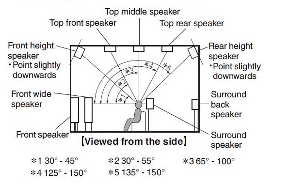

It is important to follow the angles of separation if possible, and it looks you have done this with the top fronts. IMO though, that looks to be too far away even though it’s more/less in line with 45°
Here are supported locations
I also like that you super imposed Dolby’s recommended layout onto your image. I don’t like where they have the surrounds though, and IMO should be closer 110°. Like here...

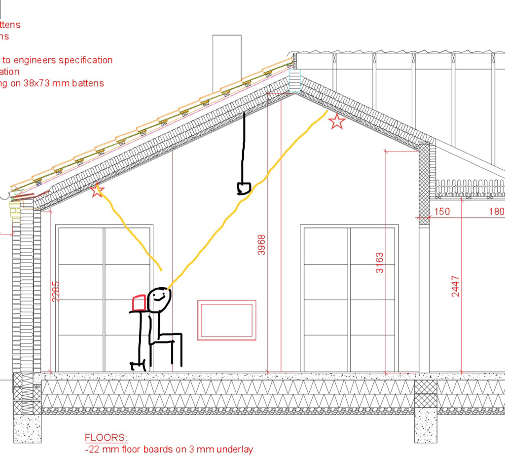

So, one solution I like for a ceiling like yours, is the pendant speaker by JBL(Dayton also makes one).
http://www.jblpro.com/www/products/installed-sound/control-60-series this allows you to set the speaker as if your ceiling were flat and IMO gives a fairly elegant look. They could even be decorated I suppose to fit in better?
I used rsl c34e’s in my ceiling, but it slopes up from left to right, and is only about 15°, which is almost the same as the baffle in the rsl. This basically has them firing straight down. How tall is the peak in your room?(sorry if I missed)
Apologies if my post is too perforated and I’m way off on your layout. I’ve been trying to write this over the last 5 hours while hanging with my family. Lol
I’m not super familiar with the arendal subs but on paper seem pretty good. I don’t love the passive radiator thing, but it can work. I’d love to offer you something on that front, but not sure where your located and what’s available. FWIW, I would go ported unless size really is a problem. Also, the PC(cylinder) models by SVS are IMO an elegant solution. They take up less real estate while sacrificing nothing in performance. You can probably see 2 of mine in the above pic.(yes I enjoy the appearance)
Ok. Let me know what I missed and maybe can better address later. I’m definitely not the ultimate authority on these things but I hate to not address something if I can help it.
myatix
Hi Again,
Thank you so much for getting back to me with all the valuable information above. I am actually based in Copenhagen, Denmark however originally from the UK. :)
Great stickman on a sofa! But yes you are spot on with the position of the screen and the sitting position.
One thing that is incorrect on the drawing I posted is that there is no window behind the sofa it's just a plain wall. The height to the apex of the ceiling is 4 meters (13ft) or 3968mm to be exact, as shown on the cross section drawings.
The distance from the front Atmos speakers to the sofa would be about 4 meters (13 ft).
My largest challenge here is my wife as she doesn't really want large speakers in the lounge and getting the B&W 702's in the lounge is purely luck due to the clean design offered by Bower and Wilkins. The same goes for the Arendal Sound 1723 Subwoofer 1, they are small and a number of AVForum experts recommended them as they a sealed and have extremely good reviews.
I can tell you now there is no chance in the world my wife would go with the pendant speaker. :(

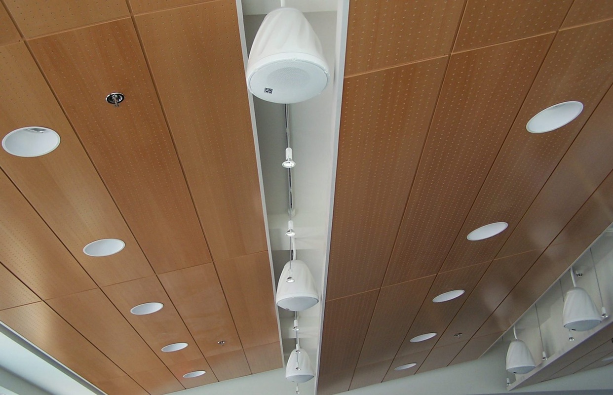

We are also installing diffusion acoustic ceiling boards just like that shown in the picture below. In fact this is a very good example of a typical Danish contemporary style. Hence the reason for B&W fitting into the room, which I kind of understand from an aesthetics stand point.

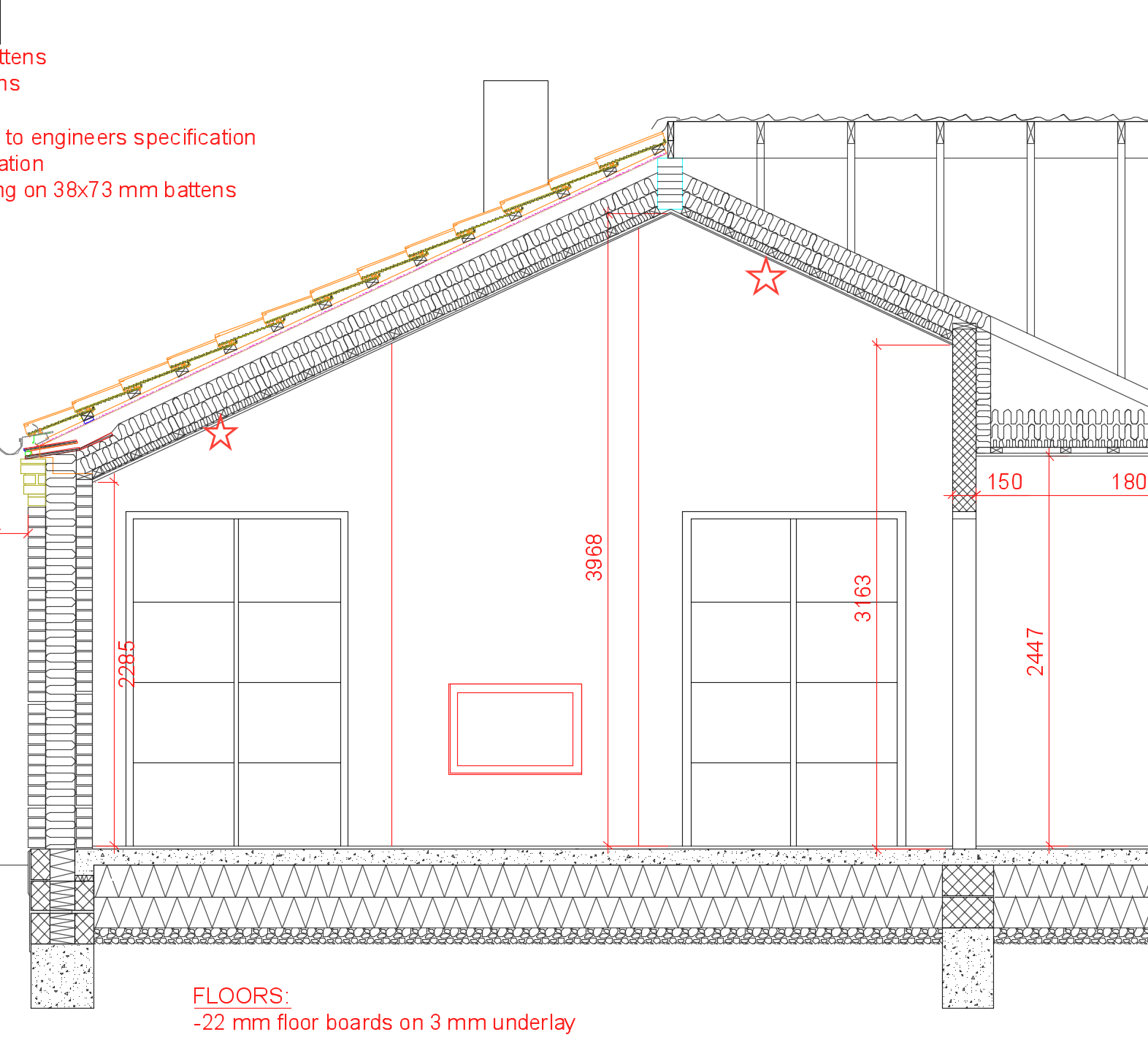

OK... The reason for me placing the front Atmos speakers where I did in the cross section was more to do with the directionality of the speakers rather than the actual location. I was a bit worried that if I move them 1 linier meter in front of the seating position they wouldn't be pointing at the audience. :)
But I can totally see @William Lemmerhirt's point... Hmmm... Maybe more of n Auro3D setup rather than Atmos! ;) Tricky!
Totally. The Aiming aspect is key. In the end, Your AVR will still make the adjustments... but the location becomes a hybrid between Front Height and Top Front. My lack of experience here won't allow me to say whether that would throw off the intended sound effect. However, We also have to work within our rooms! My Rears are mounted about 7'H, and aiming at my LP. When I get Atmos set up, There will not be a lot of distance between Top Rear and Surround Rear placement... maybe only 30". Not ideal, but if I move the rig to a larger room, I'll have all the parts in place for a more spacious set up. Will it work? Probably. Perfectly? Maybe not. Do what you can to meet the ideal, and accept the compromise where you need to for happiness and sanity! :)

I would also suggest moving the front l/r speakers closer together if your drawing is accurately illustrates location.
Same for the Atmos speakers.

@mtrycrafts yes I agree the front speakers need to be moved together as well as the atmos speakers. I just used the dolby drawing as an overlay to represent the placement approx. But having the front right in a doorway wouldn't be optimal! :D

So, I can definitely appreciate danish minimalist design. I love simple glass and stonework with some steel mixed in there. I’m not beating this drum necessarily, but to go back to the pendant design, if you look at my new doodle, lol you’ll see I marked where if you had a regular flat ceiling where the height speakers would be placed. Your initial front height location basically hits that mark, but IMO as mentioned it’s going to be very far away and also very high. IMO it’s also too close to the front vertical plane where the front main speakers will be. These things aren’t insurmountable but I don’t believe the AVR can account for everything.
So I’ve attached some images of some pendants just for inspiration lol. IMO, they can be elegant and even painted to match the room. This is what I would do with that ceiling, but maybe you’ll get some other answers. What do ya think?
One set is by Anthony Gallo which I think you’ll have access to, and sonance might be another. Anyway, gotta run.

Yeah. I think that would work. I won’t say it will work as well, but every room has its compromises. The angle looks a little bit tight so maybe go forward with the top front a little bit but it’s hard to get Atmos wrong so as long as your close, it will work. The one thing is that speaker in particular doesn’t have super high sensitivity and has a single 6” woofer so I might cross them at 100 or 110hz.
