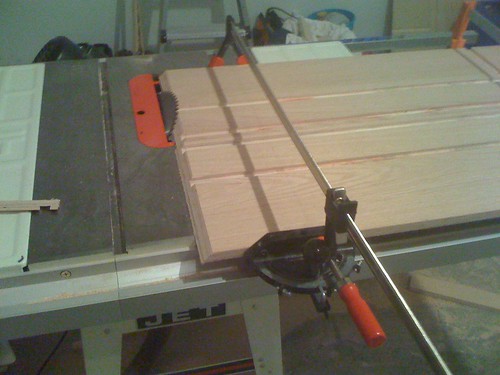

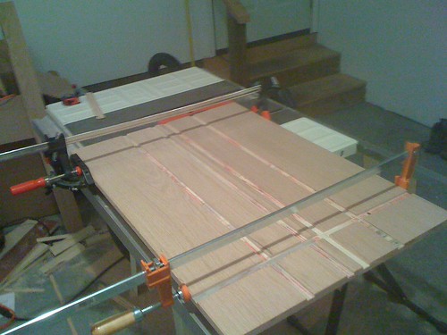

Found an interesting way to fix...
I am sure I gleeped this from somewhere. I had a side panel that was just 5/16ths of an inch too long (I HATE IMPERIAL MEASUREMENTS).
With the particular pieces being 40inchs long my table say fence runs out at 30. So I grabbed a piece that was correct and used clamping to the miter gauge. I lined the correct piece up to the blade and lined up the other end with each other to figure out my offset. After that it was simply push it through. It was real easy.
Wow you move fast. :D
