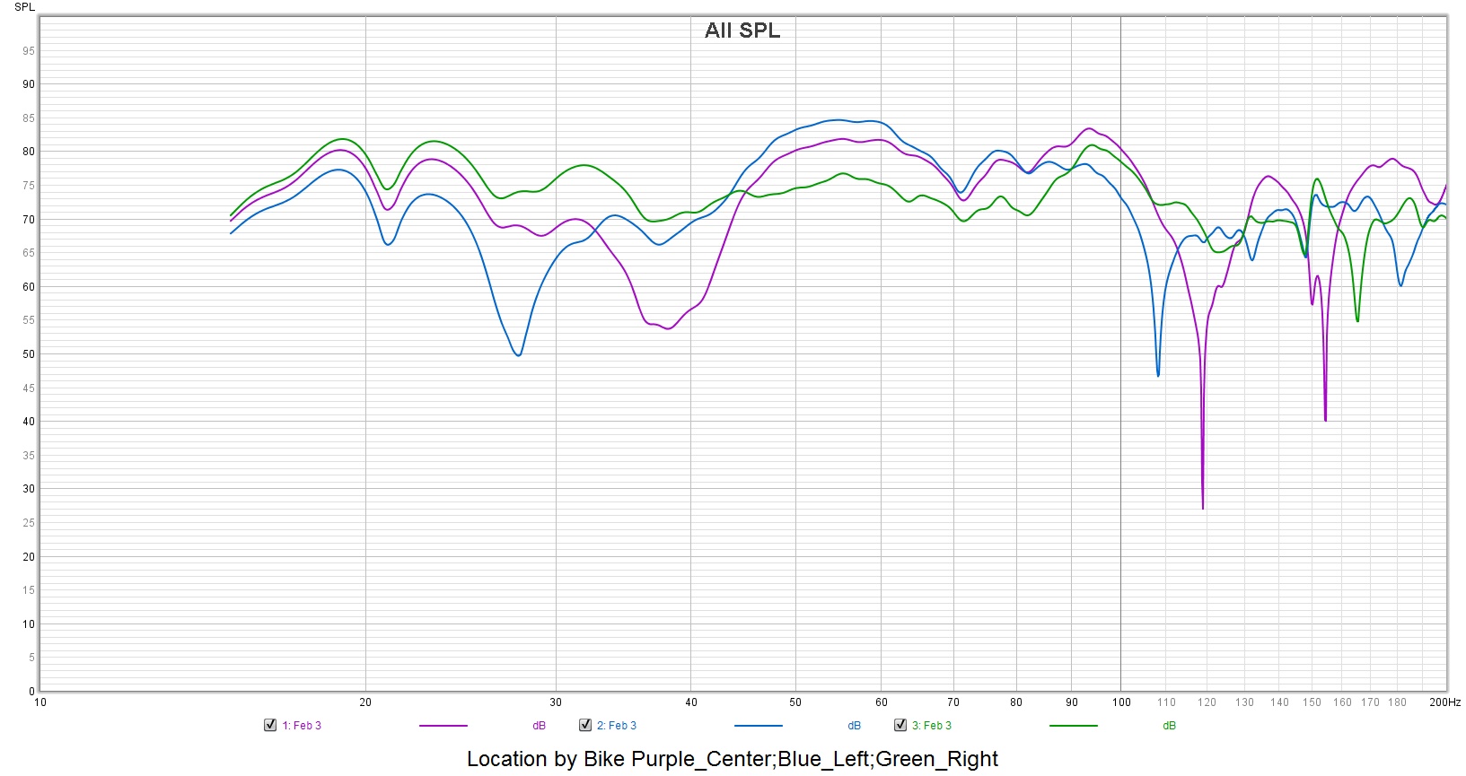

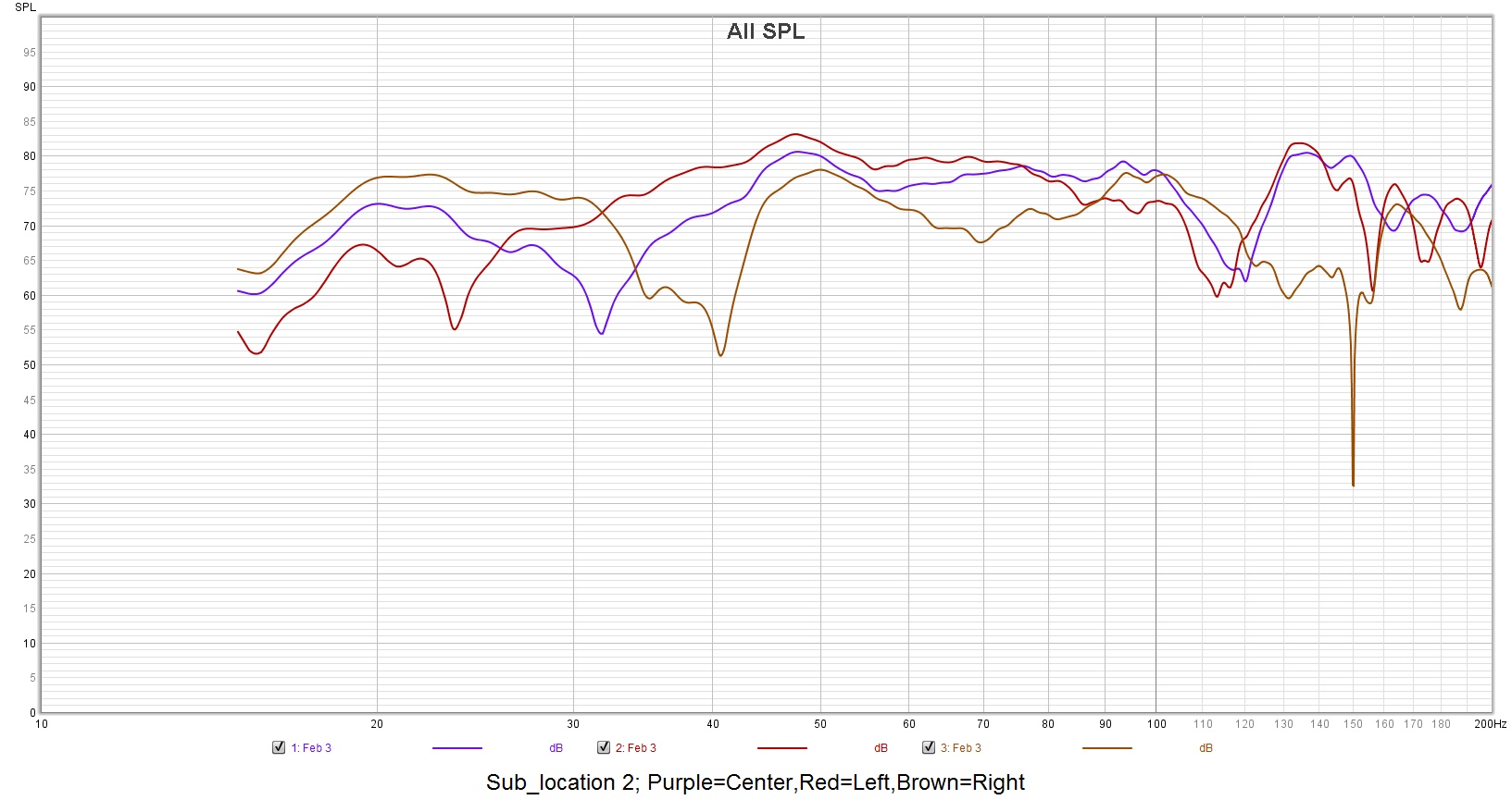

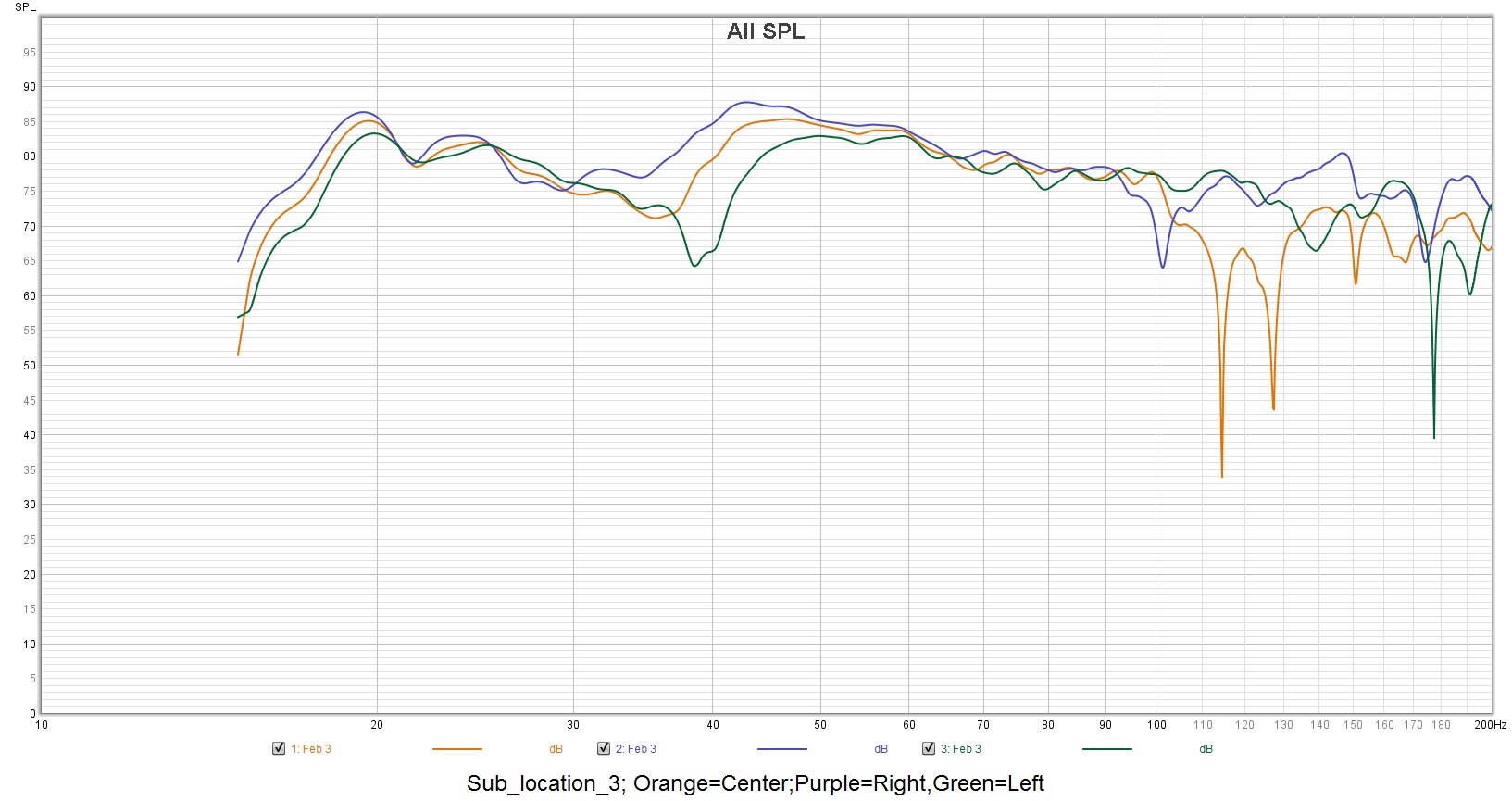

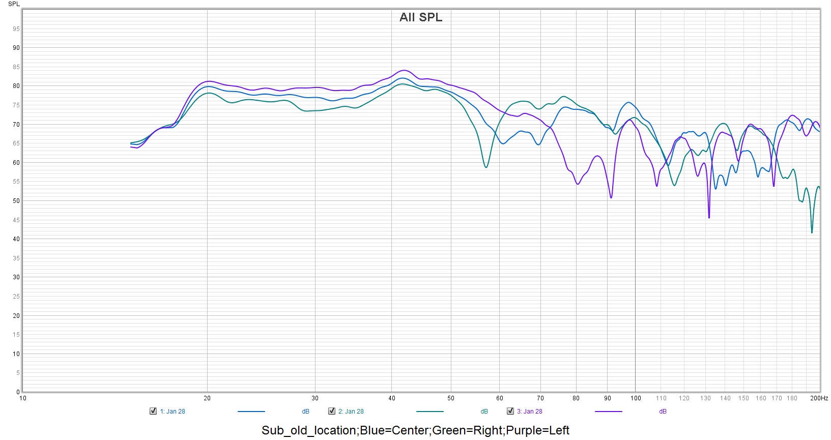

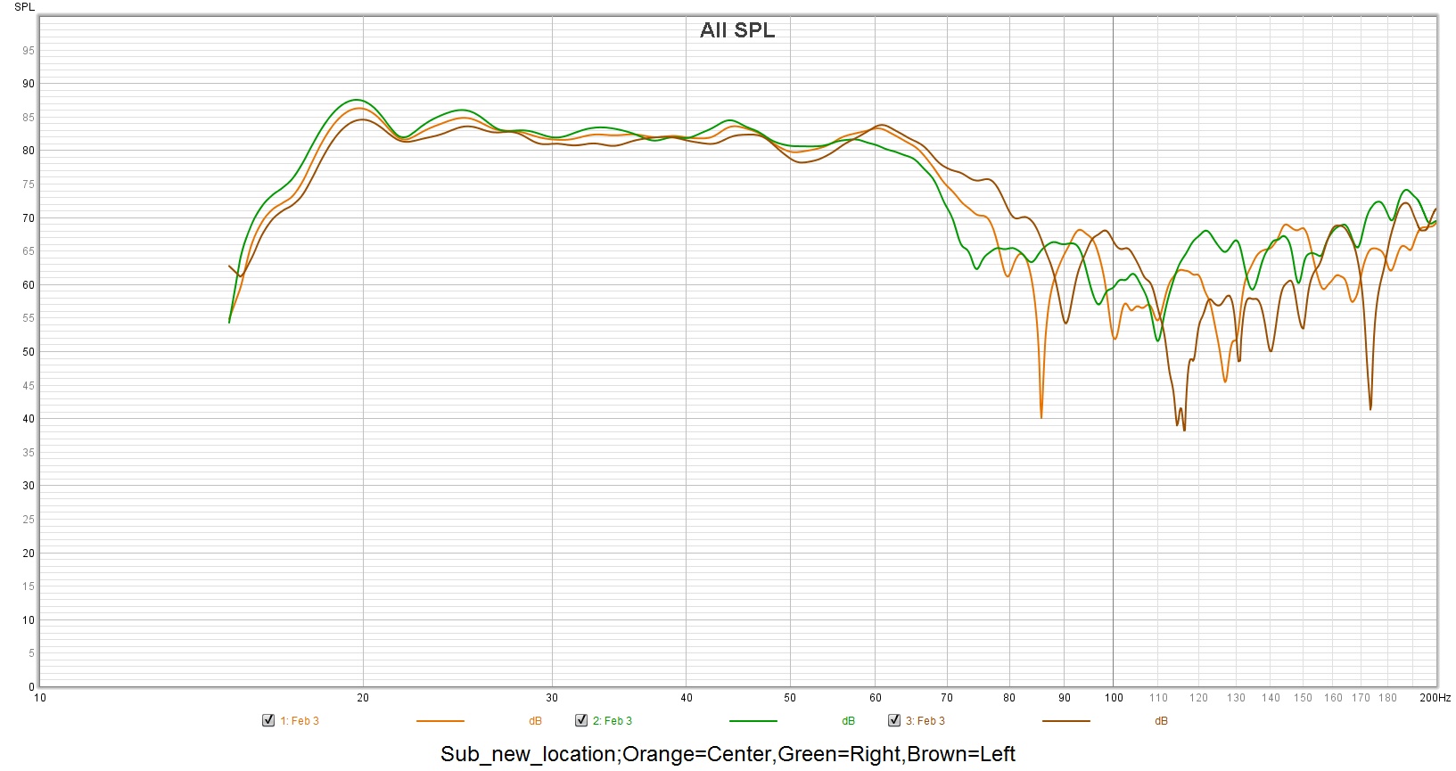

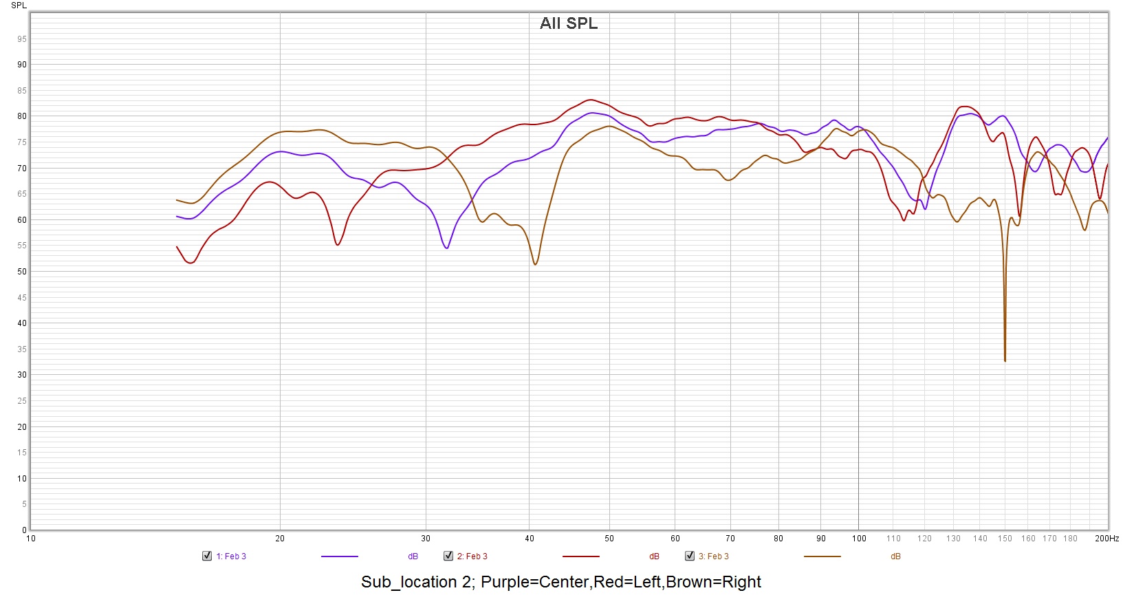

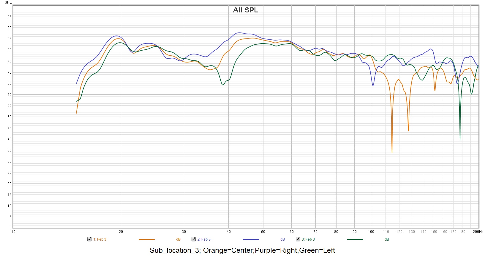

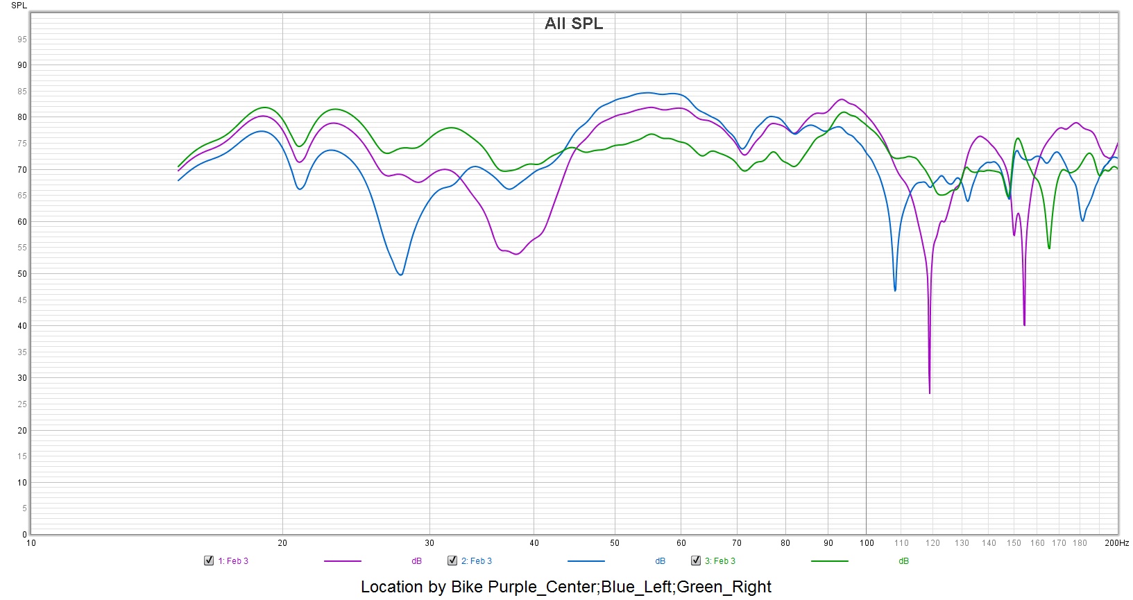

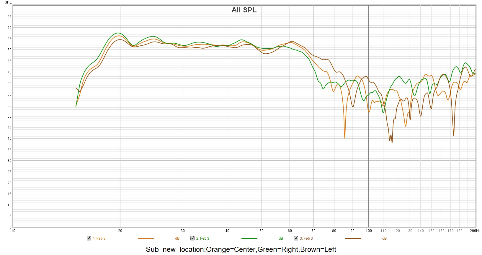

I've decided to tackle this again but in a different way. Room EQ was turned off, and the crossovers were set to 200Hz, the highest available setting on the AVR. Each graph has the 3 measurements across the width of the listener position (couch) but at a different location within the room.
sub_at_bike_location.jpgsub_at_left_of_sofa.jpgsub_at_right_of_sofa.jpgsub_at_old_location.jpgsub_at_new_location.jpg
I thinking I'm going with the new location as I get less variance across the seating position and another octave of response before it rolls off.
I have to play with Rythmik's settings next changing the roll-off of its filters and its EQ from extension to more midbass. I think I can get away with one sub based on what I'm seeing but I'm not sure.

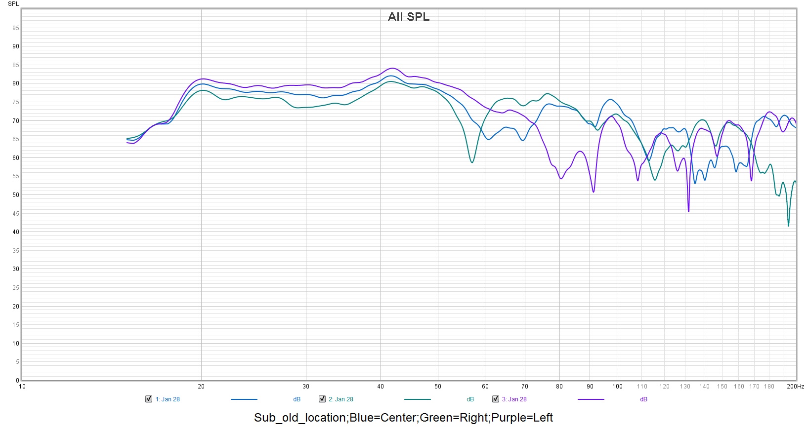

View attachment 44262View attachment 44263View attachment 44264View attachment 44265View attachment 44266
Yup, agreed. "New location" looks pretty damned good!
