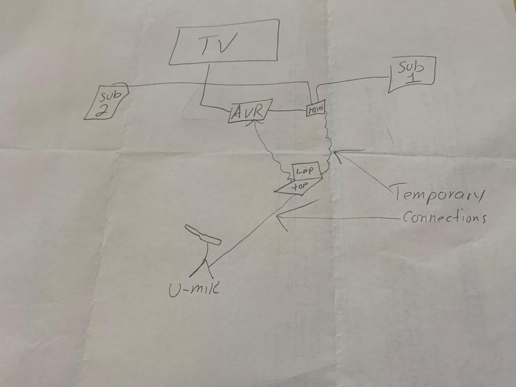

Ah so you take measurements then hook up the mini dsp so it can eq everything then you connect it between the sub and receiver to run the bass integration? Do you need any cables to hook it up or does it come with everything?
You upload the filters need from REW to the minidsp and then put it in the chain.
Does it come with everything to hook into the receiver I’m guessing the lfe cables hook into the other side?
They sent RCA and usb with mine, but I'd expect you might have to by buy one RCA if the length isn't right for you.
I can’t remember what mine came with. I think just power cable and wall wart. I have thousands of cables laying around so no big deal.
Also, the mini stays in place. It’s a permanent bridge between the AVR and subs. You just tap into it with the laptop to tune it. Then unhook laptop and leave mini wherever you decide to have it. Same with REW. When using it, the laptop connects to the AVR to send the sweep tones, the mic connects to the laptop to input sweeps to rew. I’ll make a doodle...

Once you calibrate it the way you want you don’t have to mess with it anymore do you?
