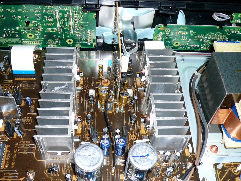

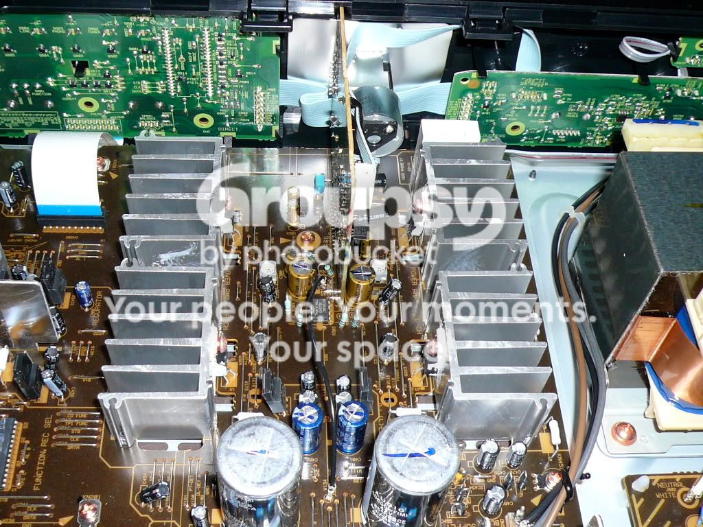

Here are some photos of the Pioneer A-35R Integrated Amplifier. The build quality is pretty good for a 179.00 amp that is stable into 4 ohms. I was impressed with the 4 individual heat sinks and rather large transformer for a 45 watt integrated amp. (65 watts into 4 ohms)

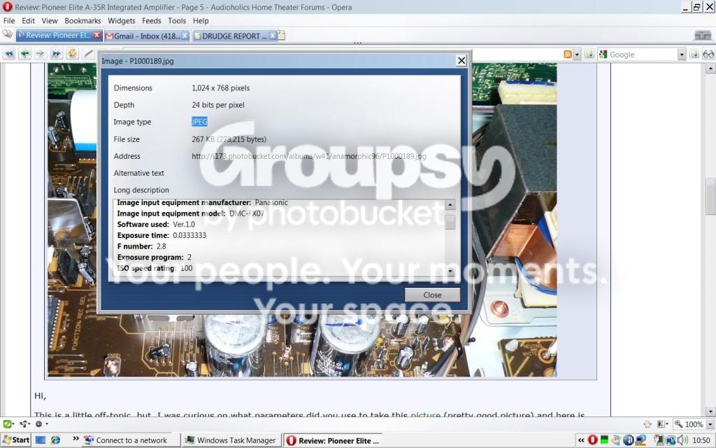

Hi,
This is a little off-topic, but, I was curious on what parameters did you use to take this picture (pretty good picture) and here is what I found in EXIF data.
Camera: Panasonic DMC-FX07
Focal Length : 5mm (Is that right??)
If so, you have a lens that can go to a focal length of 5mm? Sorry, if I understood it wrong.

Nice pics. It does indeed look like a solid piece of an equipment.

Wow! How did you know the model of camera ? To be honest I hate the camera. Hard to use. But then again I know nothing about cameras. I just pointed and shot when I took the photos. :)
right click on pic and choose image properties:)

The lense on that camera works in the range of 28mm to 102mm, is it possible it has something to do with the macro setting?
