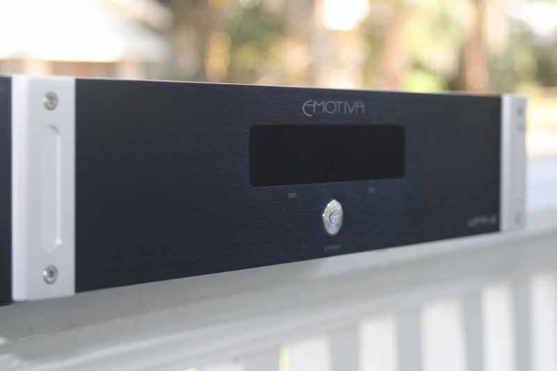

My Yamaha RX-V1 in all its glory finally had to be retired. I also have a Emotiva UPA-2 power amp and Rega RP-1 turntable. I used to run optical from my pc to this RX-V1....It sounded "good"....But I always planed to upgrade one day.
Currently I am simply running an RCA analog out directly into my Emotiva UPA-2 power amp, and basically using my PC sound card as a pre-amp/DAC. I dint want to do this anymore, as I understand its not ideal.

My amps "Input Impedance: 47K ohm "
full specs:
not enough total posts on my new account for posting links"
This amp I love but would probably upgrade some day and use it to drive my rear surrounds I have in waiting (Polk Lsim 703)

My amp Emotiva UPA-2 specs
One terabyte might do it....but you'd still need something to either physically connect it to or use wirelessly. None of your links has the input sensitivity voltage spec, but if it works fine with your phone now that's somewhat an answer already.
Yes it did work with my phone when tried in once. But it was just a test because Im used to controlling my music from my pc with a wireless keyboard/mouse for convenience.
sorry : Input Sensitivity Range (Gain): Channels 1-2 31dB
I was looking for a voltage spec. Seems Emotiva doesn't supply that altho I see a few mentions it should be around 1.2V. Don't know about your phone, tho.
Since you already have a two channel power amp, you may consider a network streamer/preamp such as this one:
