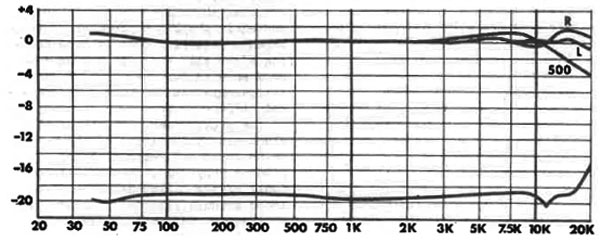

So here is a measured FR from Stereophile of the Shure V15 type III.
That agrees with what Shure published in the user manual.
Now I remember Geoffrey Horn publishing and FR of the Shure V15 xMR in Gramophone that was ruler flat. I know his set up was similar to mine
I think Shure were honest with their specs and measurements.
Here is the Shure 15 V xMR user manual showing a ruler flat FR.
The V15 xMR had a reputation for have a rolled off high end. I maintain this was due to improper loading, as few realized it requires low capacitance loading.
Here is what I mean here a member on Audio Asylum, measured the FR of his Shure 15V xMR, and it shows a rolled off high end. He did not state the loading conditions.
That would be audible. So you have to pay attention to the correct loading.
Properly set up, I think the Shure 15V xMR is the best sounding, and best tracking cartridge, that was ever produced.
