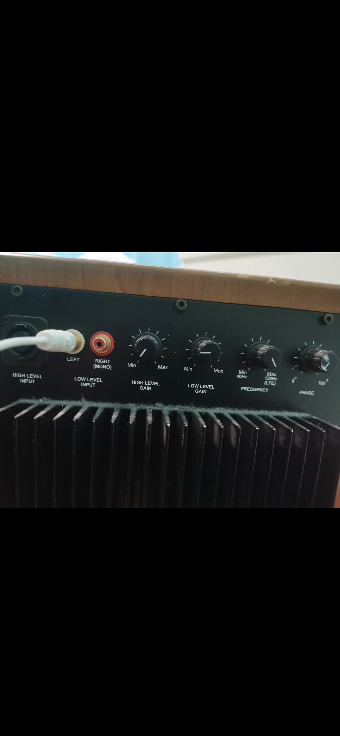

I'm familiar with their selling point in their literature and am not going to watch a video about it, but many subs have high level inputs if that's what you want.
Just trying to find out what its for and if its worth it as I have that input on my current sub
What sub would you recommend under £500?
Just a way to hook up old gear without sub pre-outs, or even stereo pre-outs (and from the manual it's hard to see if it even will sum a stereo signal in such a case, altho I suspect it does).
