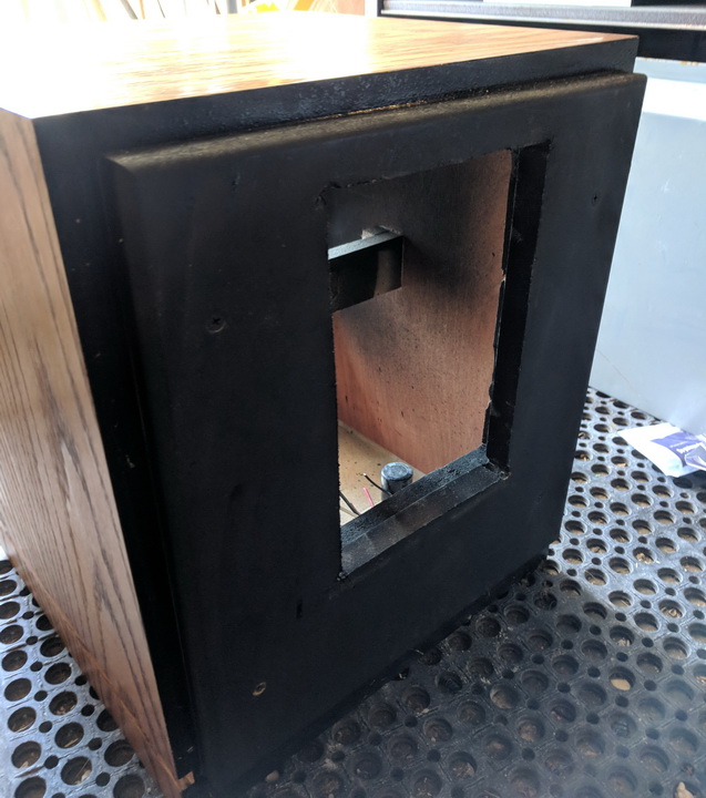

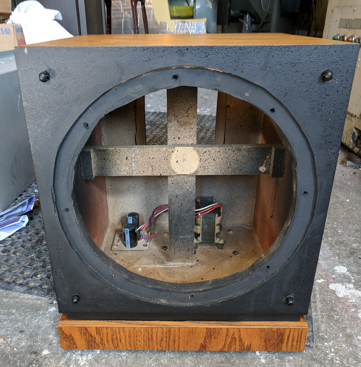

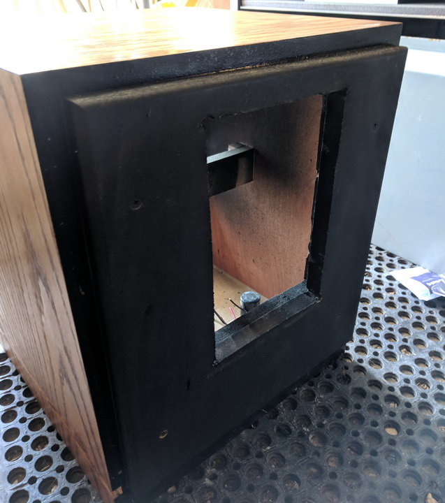

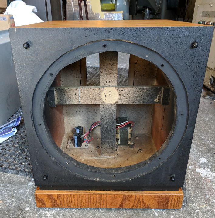

Subwoofer modifications underway over at my son's house now. :)
He has already opened-up the front baffle to accept the larger driver frame, and I picked up some 3/4" MDF to add a little more internal bracing and reconfigure the back for the different shape DSP-controlled amp. It'll get that much done soon, perhaps by the weekend, and we'll tackle making the grille a little thicker later.
Going in is the SB Acoustics SB345SWPL-76-4 driver and Dayton Audio SPA250DSP amp. Next report with have photos, perhaps a video of it working. Unfortunately, we have no measurement equipment beyond a Shady O'Rack handheld SPL meter, so we'll be dialing it in "by ear" for now.

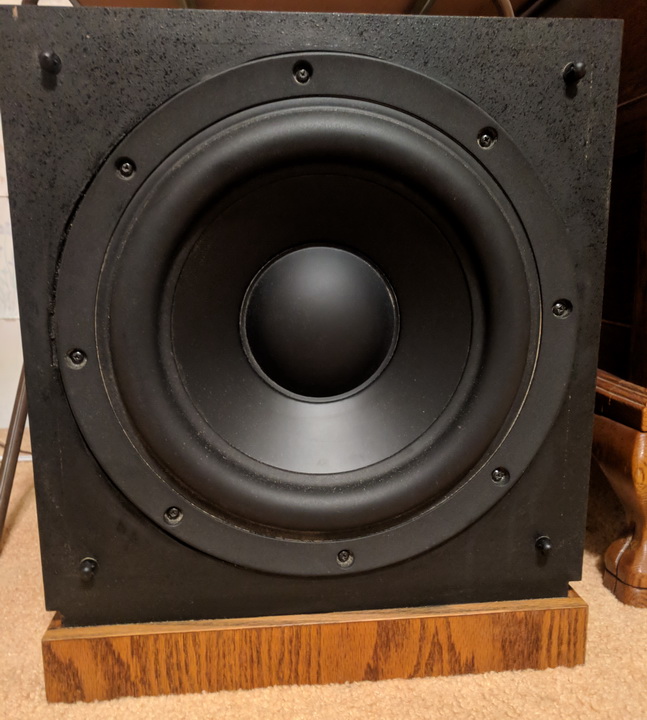

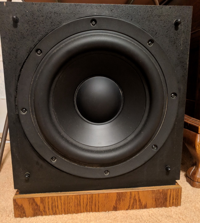

The M&K Sub is no longer a V-90! It's officially a "Frankensub." Brief test tells me this now outperforms it's original configuration SUBstantially. :D I have some work to do with the PEQ to get it working at its best, starting with loading the Dayton app onto my wife's laptop PC and connecting it. I did make some basic setting using the display and knob on the amp, and found that there's settings there I don't recognize from the "demo mode" of the desktop app, such as a setting for "Q". I don't know where that should be. It seems there's a lot more control over boost at various frequencies.
If any has used a Dayton SP250DSP or SPA500DSP amp and has some tips to share, I'm grateful!

Nice job. Yes, Eq will alter Q on a sealed sub. Set Q to 0.5 if you can. Your preliminary results sound most encouraging.
Your mod looks very neat and professional. Don't insult the sub, they have "ears" you know!

Thank you! I can indeed set the Q to .5, and will do that tomorrow. I'm researching the other settings, there's a lot of them with this amp!
I played a song from blues artist Gregory Porter, "Holding On", the second of two versions of it on the album. I think it's got frequencies down into the low 20's, perhaps mid 20's. Sounded very close to my SVS SB2000.
