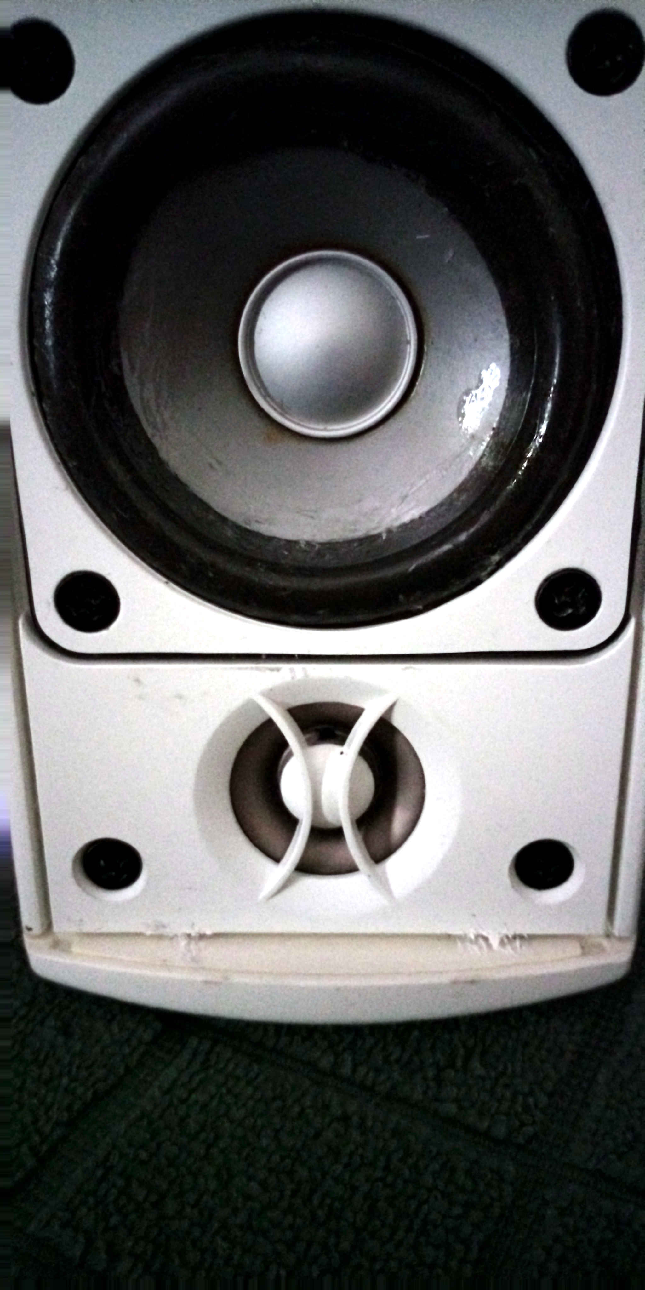

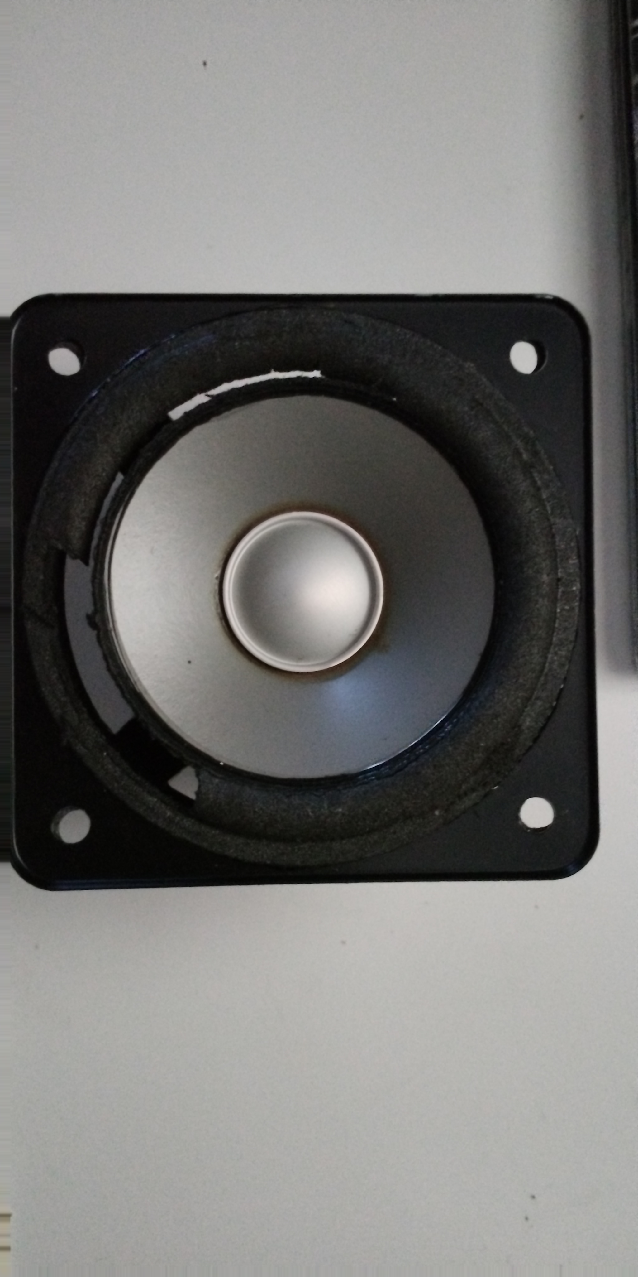

Thanks to TLS guy's thread I got my JBL satellite speakers back to work. No more rattle. Got three extras in the kit in case this happens eventually with the other speaker.
