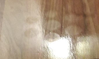

I didn't know about your education in biochemistry. You might even know an answer to a very strange situation I ran into. The bubble wrap left marks on a dry, transparent car lacquer. A piece of furniture was wrapped into bubble wrap while being sent. The choice of car lacquer was on account of gloss and some other properties. It dried for 7 days and should have been hard enough to be wrapped in bubble wrap plastic. It wasn't laying heavy on the wrap as it had stands and support. But it left marks. It looks more like some sort of reaction between the wrap and the lacquer.
But it wasn't the plain bubble wrap that came first and we all probably know the best. It was with much larger bubbles and softer plastic:
The traces
The traces
I know little about plastics and less about car lacquer. My guess is that the chemicals that keep plastics soft, the so-called plasticizers, leeched out of the bubble wrap, into the lacquer.
First try rubbing the surface of lacquer with a water/cleanser solution with an alkaline pH of 9 or 10. If you have an automatic dishwasher, try dissolving some powdered dishwasher detergent in water. If you stick your hand in that solution it should feel very slippery on your skin. If you don't have dishwasher detergent, try something called 'sudsy ammonia' (in the USA).
Have two bowls ready, one with the alkaline wash, and the other with water to rinse the stuff off before it dries.
If that doesn't work, I'm out of ideas. Sand and refinish the furniture.
