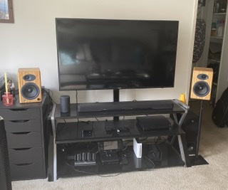

@shadyJ if it’s going to make a significant difference I’d rather spend the extra money on 3 CCB-8. How do the CCB’s compete in this price range? Also, did you see my setup, is it terrible placing a center channel on the bottom?

I think the CCB-8 compete very well in this range. I review speakers for Audioholics, and I still remember the CCB-8 as having an uncanny imaging ability. There are some caveats though, it is a large speaker, and a lot of people don't like the way they look. Hsu has since added a model with a black cone, but I think the yellow cone version has more personality. Also, they are intended to be used at a slight angle, so they can sound a bit crisp with the speaker aimed right at you. If you decide to get them, follow Hsu's placement guidelines to get the best sound. They are also intended to be used with a sub, so they don't have much bass extension into subwoofer range frequencies, not that you need that extension if you are using them with a sub.
I think they would work better than normal center speakers in the cavity in your entertainment shelf. The reason is that they have relatively narrow dispersion on all axes, so they won't reflect as much sound in the vertical axis. Normal MTM center speakers actually tend to have a wide vertical dispersion, so they will be more prone to diffraction from nearby surfaces in a vertical angle, such as your floor. In other words, the floor will have a more damaging acoustic affect on a traditional center speaker than it would o a speaker like the CCB-8.

...did you see my setup, is it terrible placing a center channel on the bottom?
No, you don't want to place the center too low. You have the typical space and placement issues we all face, the very reason those flawwed mtm center channel speakers exist!
CCB-8's are pretty girthy for your space, maybe too big to manage. Placement on the top shelf, which would be best, would force you to raise the tv up. They may not fit on the next shelf down, and you don't want to go any lower than that. But if you can make them fit and dig up the extra cash, three CCB-8 and the sub would be an incredible rig that would knock your socks off.

Thanks so much to both of you! I guess I’d have to figure out the placement if I were to get them. At least they now have the black cone (WAF or in my case GAF) and the left/right channels I could put right where my A5+ are. Might need to suck it up and mount the TV
