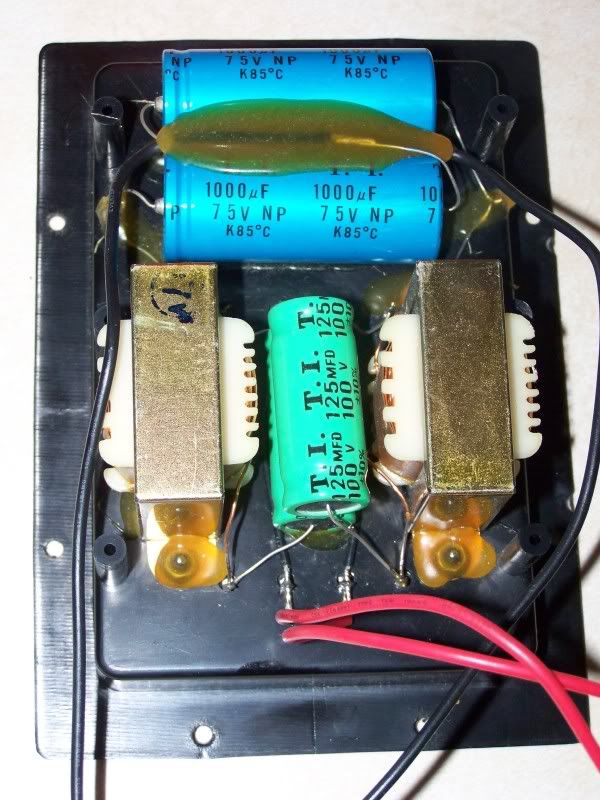

I should have asked for a shot of the other side of that plate. Does it have the crossover on the back?
here it is, is that a good enough pic? as far as getting an amp for this, no i really haven't thought about it, i actually had this box in the garbage along with the woofer but i thought if i can get a cheap woofer it would be worth keeping. i know this doesn't make much sense on a board like this but i swear my HT system will have quality stuff when it is done. this is so i can just hear a lil base in the garage when i am doing some woodworking.
Well, those are the strangest values I have seen for a passive crossover.
The 125uF after the coil calculates to about 325Hz @ 4 Ohms or 160Hz @ 8 Ohms (if the coil is close to 8mH) and I would love to see a circuit diagram 'cause I have no idea what they were doing with 1000uF caps in there. The only thing I can think of is that the coils are multi-tapped and are being used for both the high pass and low pass.

I just rebuilt one of these.... The 2 large caps are subsonic hi pass caps that cause a 35 hz and below rolloff with my NOS cerwin vega xl 12d woofer.. these can be bypassed unless you are using more than 100 wpc... parts express has a dual coil woofer for $30 dollars part #299 108 .. otherwise the emerson dual coil woofer should work.. 8 ohm coils will work better w/exsisting crossover better than 4 ohms...
These units are more boombox than high end, and will work best with minispeakers in the garage... lots of output at 100 hz...... Might also work well as a sub for the typically undersized center channel speaker..
