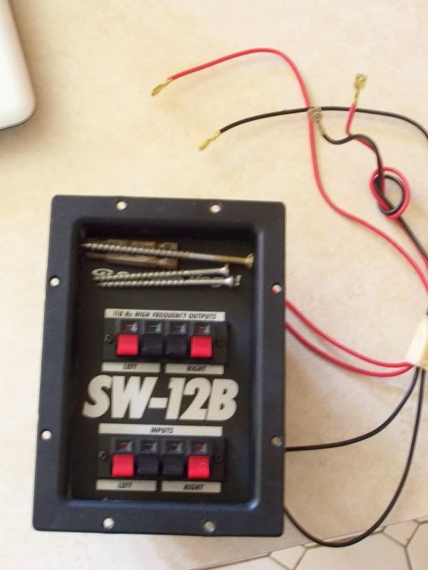

thanks for all your help with this. when i called CV the tech said it wasn't listed in his computer. i had emailed the tech support the previous nite. i got a response from someone who could look up the right info:
SW-12B Specifications
WOOFER: 12” Dual Voice-Coil (RW-12D or 122D2)
POWER HANDLING: 125 Watts/Coil
FREQUENCY RESPONSE: 29-100Hz
SENSITIVITY: 92 dB
IMPEDANCE: 8 Ohms/Coil
CROSSOVER FREQ: 100Hz with High-Pass Outputs
WEIGHT: 48 lbs.
DIMENSIONS: 13¼” X 25½” X 16¼”
MSRP: $320
CIRCA: 1990
so i NEED to find an 8 ohm 12 dual voice coil sub to make this work properly, correct?

ok thanks for all the help. i just checked the amp that it will be pluged into, an old old panasonic receiver that has ribbon cable connecting it to the radio. it says 8-16 ohms. so i will be looking for an 8 ohm dual vocie coil sub. wish me luck:D

The dual VC design only uses the force from the second coil to make it work in a smaller box than using two separate woofers. As long as you find a woofer that will work in that enclosure and it's a good match for the sensitivity of your main speakers, it will be fine.
If you still have the old woofer, you may be able to have it reconed, too.

how would i wire it to the right and left speakers from the sub then? would i put both right and left from the amp into the passover and just not connect one of those channels to the sub? i hope i am making sense. the passover had 2 sets of positive and negative for both channels plugged into the sub. would i combine them after the passover and into the sub?
Does the sub have an amplifier in it? If it does, the L & R signals are combined in the amp, so you don't need to worry about that unless the sub amp is actually stereo, which is unlikely. The general consensus for best use of dual voice coil woofers is to withe them in series or parallel and feed both voice coils the same signal. Not all stereo amps are perfectly time aligned, and if the signal from one channel is slightly delayed, phase cancellations will occur and that will cause all kinds of problems with the sound.
FYI- it's called a crossover.
tonydahose
Audioholic Intern
duh, crossover..my bad, and no it is a passive crossover
lsiberian
lsiberian
yep. so if i didnt go with a dual coil would i go right pos and left neg? or just pick one side and ignore the other?
It doesn't matter what you do as long as you run the positive power from your amp to the positive terminal on your driver. And vice-versa. You can use any wire you want in between. Though I do suggest you stick to standards and clip out the other wire for simplicity.
I'd actually wire one set to the other. In case you forget when moving or something like that.
