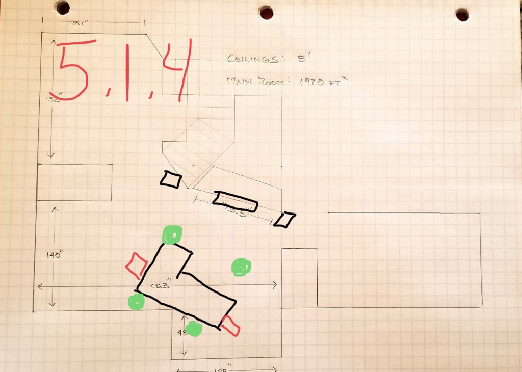

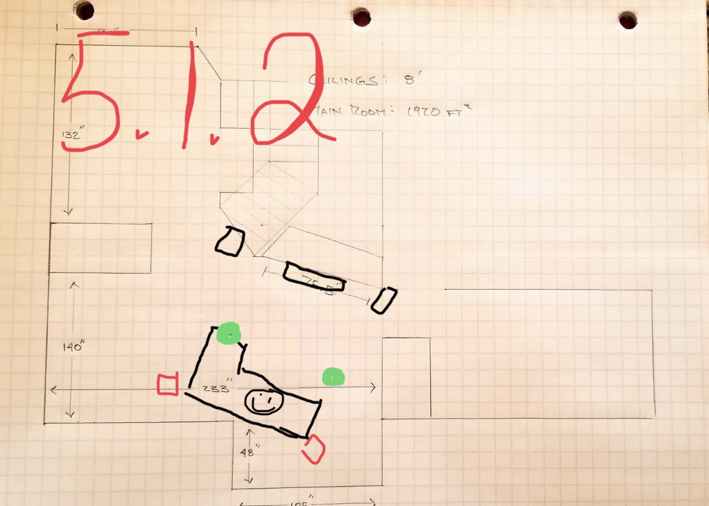

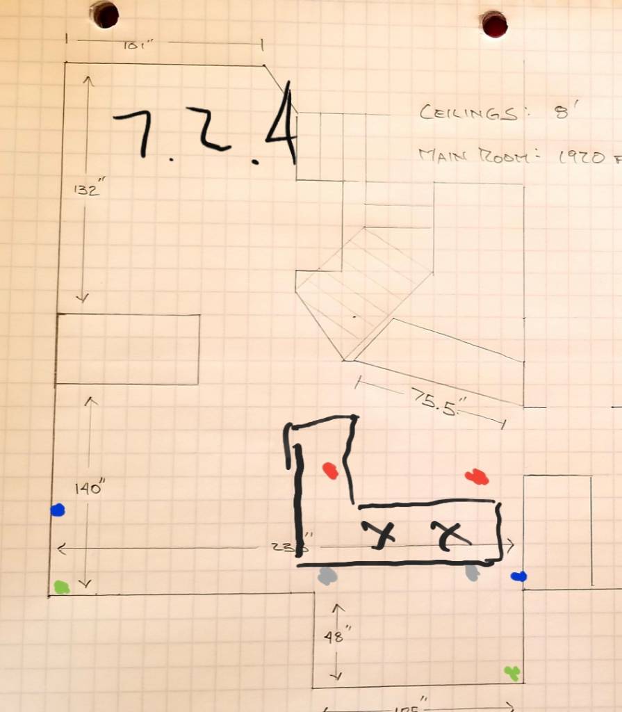

Here, maybe this will help with the questions I have about placement.
I have drawn, not well, what I am thinking about for 5.2.2 and then a potential 7.2.4 setup.
The left side is far away, the right side is very close, and the book behind the couch is slightly more narrow than the seating position.
Any suggestions?

I think RBH SV-61Rs are overkill for surrounds. Hell, they are probably better than your front stage speakers. If I were you, I wouldn't try to cram a 7.2.4 system in that room. I would just stick with 5.1, with the surrounds elevated at a height that does not place them too close to the listening position. A great choice for that is the SVS Prime Elevation speakers. I can see that you want a state-of-the-art sound system, but your room and your listening position is really fighting you here. If you are too close to any of the speakers, they will draw attention to their positions which wrecks the soundstage. If the speakers are too close to each other, there is no point in having discrete channels since the difference won't be heard.
Look at the Dolby Home Atmos Installation Guide. If you can't get your speakers close to similar placements to the ones outlined in that guide, I would forget about Atmos. Atmos depends on the speakers being in certain positions relative to the listener.

Shady you are right (I'm hoping) about the 61r's. This is more of a test to see what I think about the RBH signature reference line. If I like them, which I am confident I will, I plan to move them front, get a matching center, and put the 807v's either as surrounds (front ported), or move them to the bedroom.
The 7.2.4 setup is for sure a pipe dream. There just isn't enough room. I am hesitant about 5.2.4 even, because of the rear heights being too close to the surround channel on the right.
Currently I am shooting for the best 5.2.2 application I can get, with the idea of going to 5.2.4 if it would be worthwhile. Placement of the surrounds is less than straight forward. The difference in the right and left side of the room leaves me wondering how best to do this.

I don't think four height channels make much sense unless you have multiple rows of seating, and you don't. I would aim for 5.2.2 at the most in that situation.

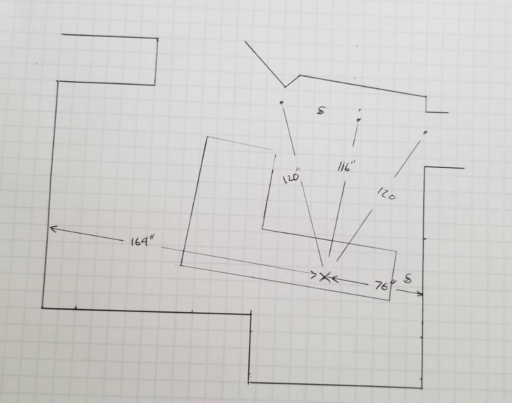

I've been doodling too. This helps a lot with the scale. The room is smaller than the layout seems. The couch helps scale it all, and the angle of the built in is not super extreme.
Plus I grabbed distances from seating position 1.
Does that help?

Here are some measurements to the listening position.
Had to move a sub to the right of the couch, not sure about it yet. But, now I more room for the surrounds.

@ShadyJ, wouldn't 5.2.4 give me the ability to locate overhead objects front-back, not just left-right? I am confused by your statement that x.x.4 wouldn't help in a single row config? I'm sure I'm just misunderstanding but want to check.

The reason why I said that is because while you can discern overhead sound, human ability to precisely localize sounds coming from above isn't very great. I think you will probably see very diminishing returns going from 5.1.2 to 5.1.4. It will make the install more complex, and also make greater demands on amplification, and I am not so sure the returns are worth the trouble. 5.1.4 will give you greater coverage over a larger seating area, but I don't think the sound will be tremendously better for a single seating location.

Aha, that makes sense! Good info.
The push for x.x.4 is settled... the room ain't gonna be able to handle it.
5.2.2 it is...at least for the near future.
