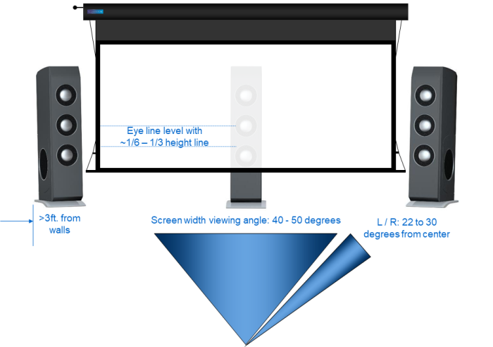

I just wanted to know that I would be able to have some lights on while watching TV (as you correctly surmised). I have the lights and dimmers set up so that all lights between the PJ and the screen are on the same dimmer. I'm very confident that I won't have issues in that area.
I was figuring on a 96" screen, so that I could place the floorstanders outside the screen. But now, I'm wondering about going to 108"-110" and placing them inside the screen. My biggest concern with that, is the bottom screen frame cross-member may have an adverse effect on the SQ, due to reflections from the lower drivers. The bottom driver is about 18" from the floor.
Of course, I could place them on short stands, in order to raise them above the frame a bit, but that would raise the tweeters above ear height accordingly. I'll be in a compromised SQ situation regardless, as the speakers will be quite close to the screen side frames, whether placed inside the screen, or outside. I'm really in a quandry as to what to do. Perhaps, I should just accept that SQ will be adversely affected and move them inside the screen. Any advise there?
J
jostenmeat
Good that you're comfortable with the lighting. I can't help you here anyways, but if it's little work, I'd consider doing multiple zones of lighting control. Especially for the bank of lights that are closest to the screen.
If short stands help the drivers clear the framing, I definitely would do it, and I am going to use cinder blocks after STRONGBAD's genius recommendation.
What you can do from there is simply tilt the speakers downward. Perhaps only using the rear feet as attached, or whatever else will work. My HT mains right now only have the front spikes I think right now, to help tilt them upward just barely. I'll probably put them as flush/level after raising. I know with my line of speakers, raising tweeter height above ear level changes the response, but it is not necessarily for the worse, depending on personal preference and room issues. But, you can just tilt them anyhow to be on axis. I don't think raising them say 8" from a distance of say 10' is all that huge of a difference.
For the spread between the speakers, that's a more complex subject I think. Ok, I opened your doc again. My guess is that I would prefer outside the screen, but that is because I like having significant spread with aggressive toe in, at least with conventional speakers.
I wouldn't worry about the screen's adverse effects. Just have them pretty close to flush to frame, and give them whatever space you can away from them, even if just a couple of inches.
I would be more worried about shoving them too far into the corners, or too close to the sidewalls. The closer you are to either, the more concerned I would be in treating them extensively with broadband absorption.
I think the best way to know, once absolutely certain about screen size, is to simply try both. Listen to them with speakers inside and outside. No issues I can foresee in trying that out, atm.
Hey, I never thought about tilting them downwards! Great suggestion! If I do place them inside the screen, it would involve pulling them away from the sidewalls a bit, so that may be a benefit as well. With a 108" - 110" screen, they would be about 87" apart, centre to centre. I think there would be sufficient channel separation with that distance and they'd be about 5" - 6" further from the sidewalls. I'm leaning more towards the larger screen now.
With a 7' 2" ceiling however, I'm going to bring the top of the screen to about 6" from the ceiling with a screen that size. Should I be concerned about that? Before you suggest it, painting the ceiling black will be a non-starter. I suppose, if there is too much reflection from the ceiling, I could persuade her to go a bit darker, at least.
Thanks again, for all the advise!

Something came across my mind for you to research and report back on with angling speaker, and that is if there is any increased audible comb filtering issue. The very high intensity of smaller holes with this weave is designed to move comb filtering into much higher frequencies where we won't notice. My guess is it it will be totally fine, but always better to know for sure. Here's a small portion from the Seymour site:
"For example, any fabric with holes will comb filter to a measureable degree, but in order for it not to have an audible effect the lobing needs to be as closely spaced as possible (our hearing will average frequency/special response) and at the highest frequencies".
However, like I said before, maybe even multiple times, I don't think even a foot higher for your speaker will create much audible issue at your double digit feet distance. I mean, I don't complain when I'm one foot off-center from center speaker in the horizontal sense from double digit feet away, and that's with the ubiquitous mtm.
As for the arguments for placing speakers outside vs inside screen. One argument would be the following, and I'll quote the Seymour site again (and out of order on purpose):
"If you have a very large screen and a narrow spacing between your left and right speakers you can get all three behind the screen. The advantages of this include better concealment (e.g. high WAF factor), and the minimal sonic effect that the screen imparts will be identical across your (hopefully) identical front speakers."
"What is the real world result from placing your speakers behind a Center Stage screen? If only your center channel is behind the screen, you will need to increase the volume of the center channel one to two decibels. If you have all three front speakers behind the screen, you will only need to trim your surround channels one to two decibels to match your slightly attenuated front soundstage. The qualitative effects of having a fabric in front of your speakers is that you will notice that brighter recordings are tamed down a little, with a slight loss of sparkle and air, because the attenuation is higher in the top octave."
I run Audyssey every time I change anything with my audio. Typically, the default curve is the "House" curve, and this has a rolloff of the HF. Therefore with this screen, I expect that it will already do for Audyssey what it was going to for itself. So, In my case, I'm really not worried about this.
For you, if there is lack of "higher end" calibration going on, it may behoove you more to have all three behind the screen. OTOH, I fully expect that the difference will be minimal, if even audible (outside of level, but that's easy anyways), and more importantly, I think the benefits of a vertically arrayed center speaker placed as it should be, all drivers on the same plane, best possible acoustic match, best horiz dispersion, yada yada, will all far outweigh the aforementioned issue.
Paint. Whatever color you pick, even white for example, you will have to research online and hopefully choose the correct people to trust (don't ask me how I know), or for best due diligence, you get a variety of paints, and put them all side by side on a board. After drying, just look at all the samples under a light source, and you will see which are the most reflective, and which are the least. Otherwise, the darker the better, but you already know that.
What you might not know is that it is the ceiling that is generally referred to as the most important boundary of all to treat for light. However, while this is said in the general sense, it is assuming the type of screen which is generally used, and that is angular reflective. If OTOH it was the Dalite HP I mentioned before, it would instead be the back wall, generally speaking.
Back to speaker placement, and viewing angle, I'm glad to see that Seymour pretty much advises what I have found to work best on my own. Greater spread, with more extreme toe in (he advises even more toe in than I use), and well I'll leave the viewing angle alone for the moment, but mine pretty much is in line with his recs, topping his max rec by a couple degrees, but you'll see him say that is more workable when sources are HD, or with stricter light control, and mine has both.
Crap, I almost skipped it, but the 6" from ceiling, no I don't think it's an issue at all, except possibly* if you have a bright colored ceiling. I dunno. Mine as white wasn't too bad, but that's also because it is unlike 99% of the screens used in HTs with its reflective properties. You'll probably be just fine, and I don't even need to repeat this, but you should figure out a darker paint that the wife will like, that is also the most matte/flattest possible. I might even myself take a lighter colored paint that is less reflective, than a significantly darker paint that is more reflective.

I am not exactly sure how you figured having the speakers all behind the screen will be the best solution, but ok. Obviously, there are a lot of things going on.
For my comb filtering worry, I'm really no longer worried. If Seymour advises experimentation with extreme toe in, then I am sure he would have mentioned any issue if all 3 were behind screen.
The recommended min distance between speaker and screen is 1". Old version was 2". If you pull the speaker further back, your results on a graph will look superior since the combing bands will narrow and go further up in frequency, but the difference is still inaudible. I believe he stated you can only even see the difference with 1/24th resolution. At 1/3 or even 1/6, it won't even show up on graphs.
Viewing angle is from a single spot. Your question regarding multirow means that in-between compromises come into play, and if you're going this route, let us know. Speaker positions, listener positions, levels, screen size, everything all of a sudden could be considered a compromise. Two philosophies here: Either perfect for captain's seat, damn the rest to hell, or, compromise throughout the seating. AH has an article on level matching multi rows, and obviously it's with the second philosophy in mind, including the usage of bipolar side surrounds.
36 deg is great, the de facto starting point, but I hope you don't watch much, if any, standard def. Even TV in HD can be a bit much, IMO.

Placing the speakers behind the screen isn't a goal, but just a way to increase screen size a bit. In order to maintain some distance between the speakers and the sidewalls, I would have to keep the screen a bit on the smaller side. Placing them inside* the screen would allow me to increase the screen size without pushing the mains towards the wall.
I had assumed that the screen viewing angle was based on a central postion, but I was just wondering what row the recommendation was based on. Maybe it isn't based on any particular row and that it's just the optimum viewing angle. I don't intend to set up multi-row seating. Any additional seating beyond a couch or loveseat will be temporary.
I'm going to aim for perfecting the setup, based on the "Captain's seat", as my wife and daughter won't be as fussy about it as I will.
I admit that in discovering the possibility of increasing my screen size, I forgot about the greater demands that will be placed on the projector. I guess I'll have to take that into account.

For reference to any helpful poster, the screen wall width is 129" wide (save you a moment of simple math, to compare with dimensions in link below).
96" vs 102" vs 108" vs 116"
Alrighty then, to jibber jabber some more. Yes, throwing the pic up without the actual screen is fine to find your viewing angle. I would personally not want to cut off any more material than you have to: what I mean is that you ought to look to maximize your "tilt" degrees to reduce the chance of moiré, and most particularly with an LCD PJ like the Pana. I forgot how much tilt I'll be putting in (though we figured it out at one point), even though I don't need it, because I might as well future proof just in case.
Ah right, yes it's the angle for the middle row indeed, in a movie theater, I think anyways. When I describe my setup to some AHers, they are shocked, but the reality is that I have had much* more immersive experiences in the theaters, of course depending on the seating.
I would think that I/we will be watching primarily HD programming, but point taken. I won't go 116". Perhaps I should pick something in the 102" - 108" range. Or, do you think I should stick with the original 96" size?
To replicate my current viewing angle, I would be making a 137" screen in your room. I am replicating the same viewing angle with my new screen. So, no, I'm not sure you want to be asking me*. I have a semi-cave (cave in front of viewers), I watch 99% BD as my source (and I'm finicky with even those), and I have a somewhat brighter unit in my JVC RS1.
When you say primarily HD programming, IMO, there can still be a big difference between some types of HD programming and others. Movies OTOH are very often in smaller ARs such as 2.35:1. If it was the case that all of my viewing was 1.78, I can guarantee you that I wouldn't go as big, but like I said, BDs are by far and away what I watch in the HT.
I will give myself more time to mull over your screen size. Could be days, I dunno. No comment yet . . .
I figured I would get Seymour to cut it, including the tilt, so that I don't take the risk of mucking it up. I figured that if I ordered it for the largest conceivable size for my room, I can always cut it again to a smaller size. If I order a smaller screen, I can't add material to it. I dunno - maybe I should just pick a size and stick with it.

Now that I actually compared dimensions of screen and wall, I am much more acutely aware of your dilemma as for "inside" vs "outside". I didn't really compare until now because in my experiences, I typically spend the time for no reason, as my suggestions often get shot down after spending the time. As for me being loath to compromise, I don't know. Everything is a compromise. Your situation is proof of that. You said yourself you want the best pic you can get here, and yet you also seem pretty uncompromising with audio setup, whether that is tweeter height, space from boundaries, speaker spread, and going AT or bust for that matter with a modestly powered PJ in a room with modest light control.
Well, now that I've looked, the way I see it, you only want to do the speakers "inside". Even at the smallest considered size of 96", that only gives you a total of less than 23" or so on either side, but then you have to subtract speaker width, as well as the screen frame on each side. So, then the question becomes, if only for consideration of what can even work well for you and your uncompromising audio needs, what is the smallest you can go and still not compromise your audio? My suggestion here is to grab a few cinder blocks, a folding chair, and temporarily setup your three speakers on the wall once demo is over. Make notes of not only the best width, but the available play in speaker spread while maintaining excellent audio.
IMO, it's all about experimentation in front of your own eyes/ears, whether that's pic size with PJ in possession, eyeing paint's reflectivity, etc. I've shared a story here at least a couple of times, though it's now been a while, but I remember a fellow "predicting" everything, with plenty on online research. He custom built cabinetry around the screen frame himself. However, once he threw up the pic, he realized he just absolutely had to go bigger, and that was pretty immediately. Welp, he ripped out all of his hard work and started all over again. This is just a story to support the premise of my advice above.
OK, IMO, for extensive HDTV viewing, I think even 30 deg viewing angle is more than desired, IMO. It depends on the sport too. For instance, the Winter Games at 30 deg, or even closer, was freaking awesome. OTOH, NBA or Final Four basketball is a bit much. I assume hockey would be too (I don't get hockey since I only have OTA). Well, if this was the path you followed, your screen would now be less than 96".
