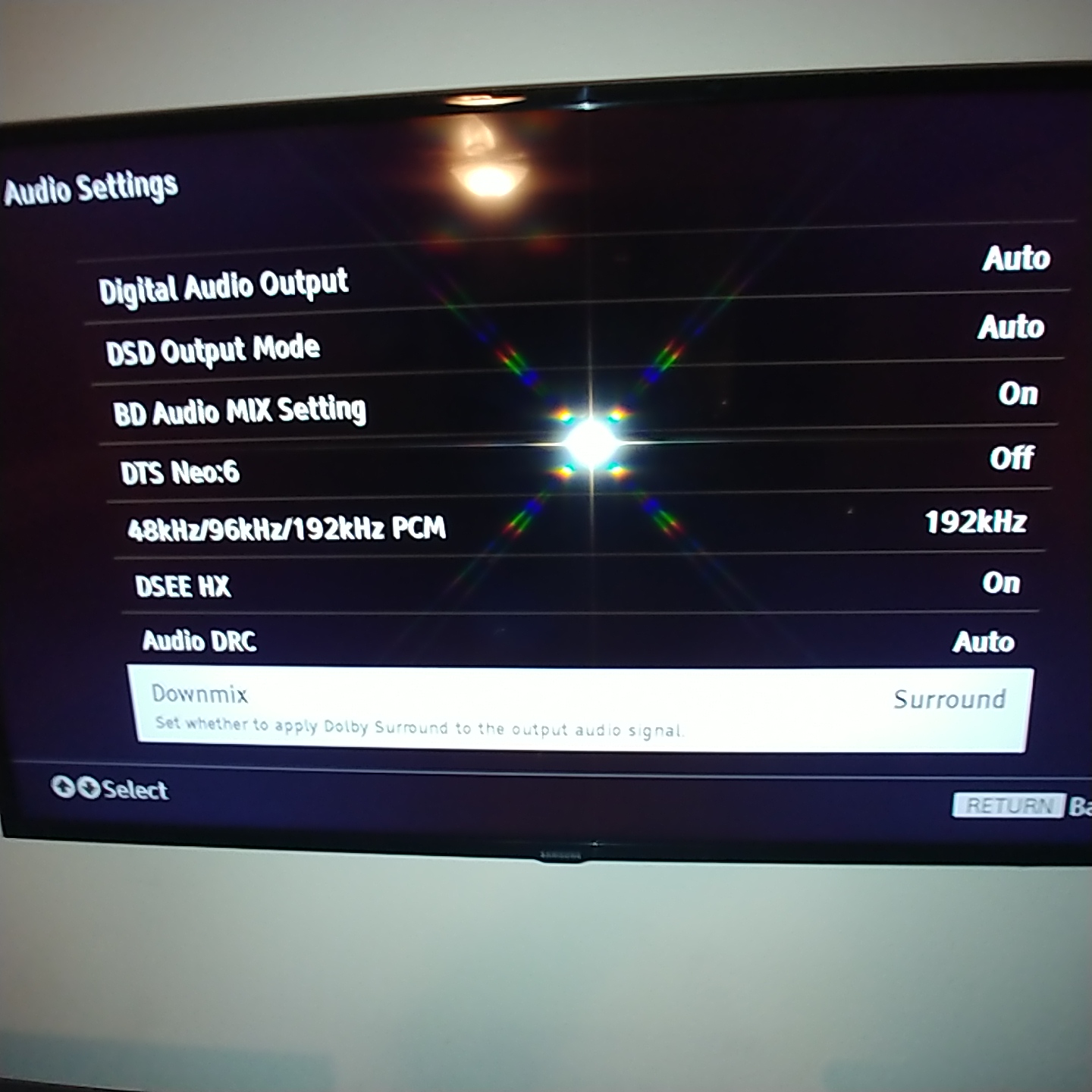

To do that on my Sony, you set digital audio output to the auto setting.

This is my screen right now do you see anything I should do?

Ok so far so good no noise let me try and switch formats see if it comes back
Danzilla31
Ok it's gone no noise that is friggin weird man. I wonder what we did to fix it?

Also, I noticed you both have DRC set to auto. I would turn it off unless you have a reason to use Dynamic range compression. Can’t think of a good reason. If you have people in the house that you don’t want to disturb, Dolby volume or Audysseys dynamic volume are probably easier to activate and disable.
