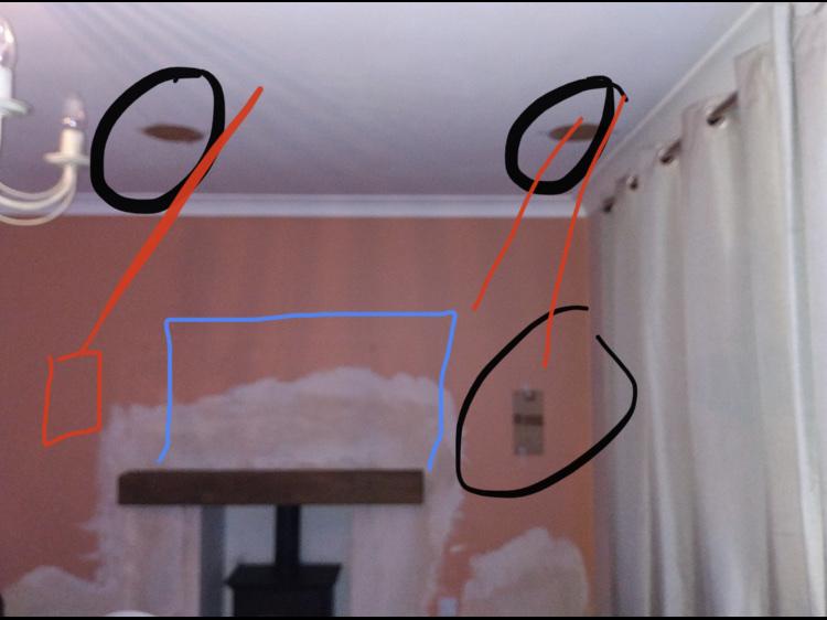

Thanks all, really sorry I haven't been clear thanks for your patience. The mantle/fireplace is actually the right side of the room, the cardboard circled next to the mantle is actually the right surround, not right front. The one above in the ceiling will be the Atmos right rear and the one to the left, is the front right Atmos speaker.
Ceiling height is 4.2m / 7'10"
The first two pictures were just intended for the dimensions, for whatever reason roomstyler wouldn't allow me to have the measurements around all sides of the room.

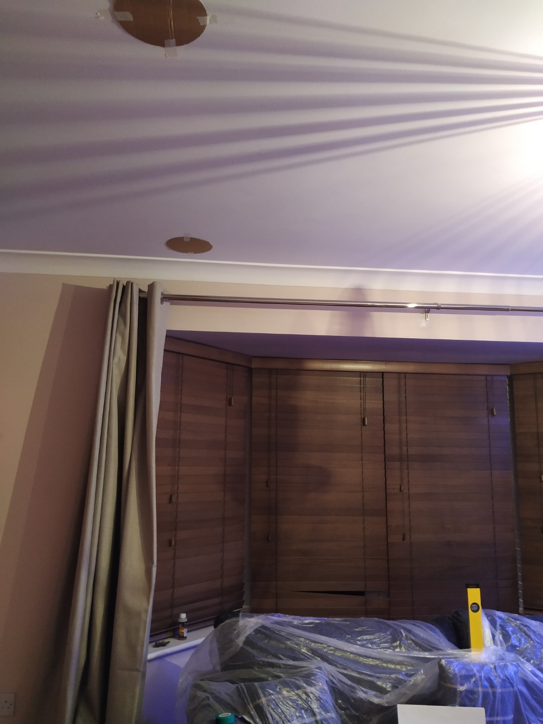

So I've tried my best, hoping these ones are a little better :oops:
I've done a panorama one which is going to look crazy but it's to give you a feel for where the rest of the stuff is. I've propped the spirit level on the couch where I'd expect the perfect listening position to be, allow for the front and back of someone's head though

Ok now I can see a little better. Your cardboard skills are amazing lol.
So, the surrounds look a little high. I’d maybe move them closer to ear height, or just above. The center channel, might be a problem if it’s going in wall as the top of the entertainment will cause reflections and acoustic issues. Still wondering what your bed layer speakers and sub/s will be. And, if you can get the couch forward at all would be helpful.

One more thought for you. Why not mount the rear Atmos in the dropped ceiling in the bay window?
Then it will be behind. Don't worry about the difference in the ceilings. Levels will be matched in setip.
