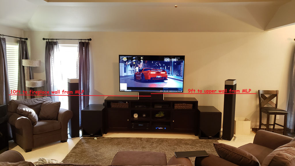

I obviously haven't finished painting in the house excuse the mismatch! I am currently running a 5.2.2 system but want to make it 7.2.2. My rear surrounds are currently positioned properly for a 7.x system and aren't ideal for how they are now as a 5.x system. Below I have several photos of the room I'm working with. My main limitation is the right side channel since I can only put it high up on the wall in that area. Is this okay to do if I angle the speaker down towards the MLP? I assume I would want to do the same for the left speaker so their locations match? It's unfortunate because I could mount the left speaker easily in the ideal position, but not the right speaker. Suggestions?

I'm not sure I can even consider the SR9080 since it seems to require being flush mount against the wall without a mount to tilt it and that would mean the speaker would be more like 9ft high up on the wall firing towards the ceiling fan and in the vaulted area of the living room for the right side. The left side would be on the vaulted portion angled down above the fireplace or lowered down on the vertical section of the wall making it lower than the right side.

From that list, go with the Promonitor 1000s. The 2000 center speaker will have lobing issues off-axis. The SR9080 will make a mess of a surround soundstage that needs more precise imaging. Dipole and bipole surround speakers are not appropriate for Atmos or DTS:X sound mixes, and not even 7.1 mixes really.

Here are the new issues if I attempt to run my new sides at ear level. My right side which is open to the kitchen as seen in the pictures would be approximately 3ft away on a stand where as my left side would be on the wall approximately 10ft away. So what is more important, equal distance or height?

Speaker position is important to pull off an Atmos system. If you can't accommodate the correct speaker positions for a 7.1.x setup, just go down to a 5.1.x setup. In other words, don't try to force speakers in placements that your room can't handle. Use the money to take your family out for a nice steak dinner instead.

Lucky for me it's just me myself and I. The way I see it is I have a not so ideal 5.2.2 setup now with bouncy Atmos tops on my front left and right. I don't notice them really. I think I might be better off trying to get the 7.2 setup working and not worry about Atmos unless I want to do dedicated in ceiling speakers later after I figure this out. My 5.2 isn't ideal because my "surrounds" are really in the position of 7.1 rear surrounds.
That being said am I better off with them at ear level and not equidistant or equidistant but not ear level?

Bring the surrounds to ear level. The distance can be compensated for in the AVR, but not the height.
