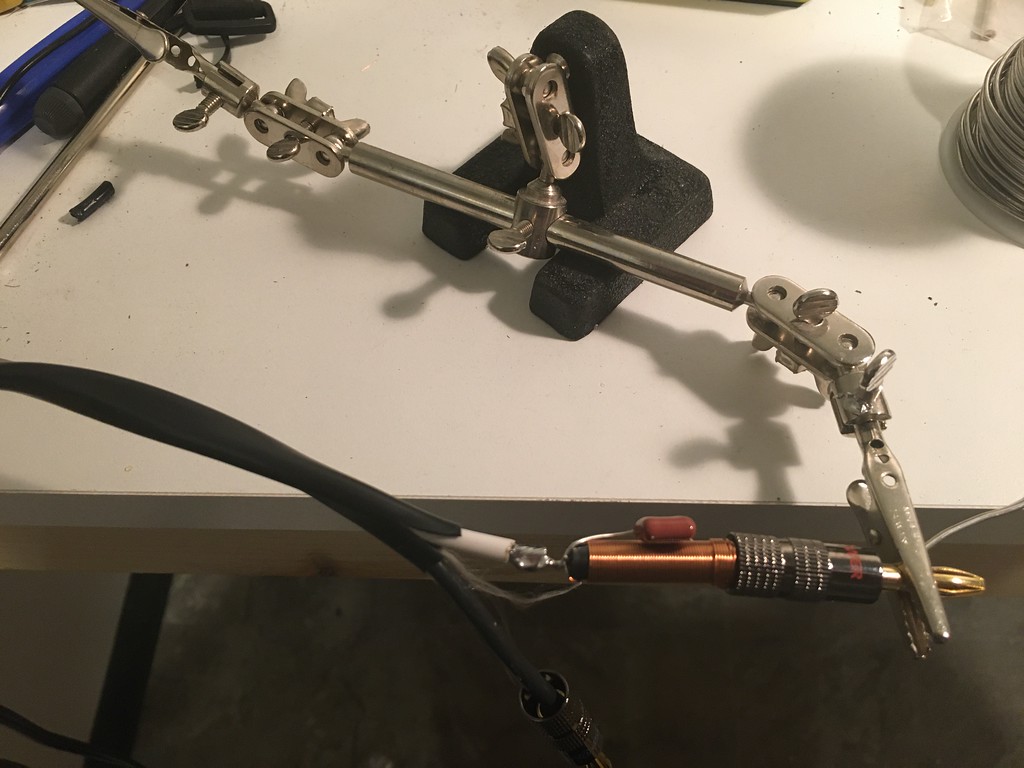

OK this what you need.
one of these for each speaker.
One of these for each speaker.
It will come one size or the other, you just need one cap per speaker.
Now you solder a cap and an inductor in parallel. Rap it in insulating tape so you do not get shorts. You solder one end of a combo to each +ve speaker lead, and connect the other end of the combo to each +ve speaker terminal.
If that does not do the trick, then your receiver will need modification to improve its RF rejection.
Mouser are very efficient and easy to deal with.

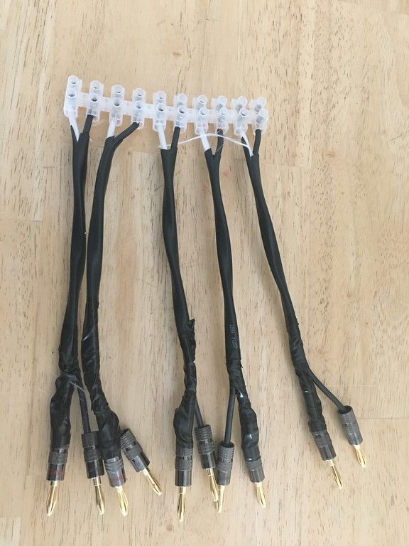

I have the unit made for the OP and sent him pictures to make sure he can install it. I had a couple of PMs from him but now nothing. I guess I will just ship it to him.
I have made it so that it should be robust. It should cut the radio signal at least 20 db by my measurements, and if he uses good twisted 10 AWG speaker cables, he should be OK I hope. He said he had ordered the Belden cable I suggested. That is probably the best speaker cable around.

Hey guys,
Unfortunately, TLS' Guy's solution didn't eliminate the RFI. It certainly reduced it, but I still hear mariachi music in the quiet parts of movies. It's certainly a step in the right direction, but now I'm going to try one of those wireless transmitter/receivers for the rear speakers (the ones picking up the most sound). Hopefully eliminating the long speaker wires will kill most of the reception.

Hey guys,

Hey guys,
I was afraid this might happen. My tests showed the device reduced the station by just over 20 db. The problem becomes that if you designed higher order filters then you would have too much resistance in the line.
At least now the nuisance problem is the longer speaker leaders to the surrounds. So it seems the front channels are now listenable.
After thinking about it he would be best trying an amp from the preouts. This quite likely would have better RF rejection from the negative feedback circuit. If it did not work he cold return the amp, and then pursue the radio solution. This is far from an optimal solution for many reasons, especially latency.
This amp would be a good choice and comparable to the cost of his radio solution. The chances of it working are good. It seems to me that his receiver power amps, have well below acceptable standards of RF rejection. This is one more episode that convinces me that receivers are miserable devices.
The OP's issue is well known in power amp design. There are known steps to stop it that would add minimal cost. I suppose a some bean counter wanted to shave about $5 bucks of the price and allow this problem to happen.
If the external power amps solve it and they likely will, he should consider powering all his speakers from external amps, and then he will not have to put up with any receiver power amps.
