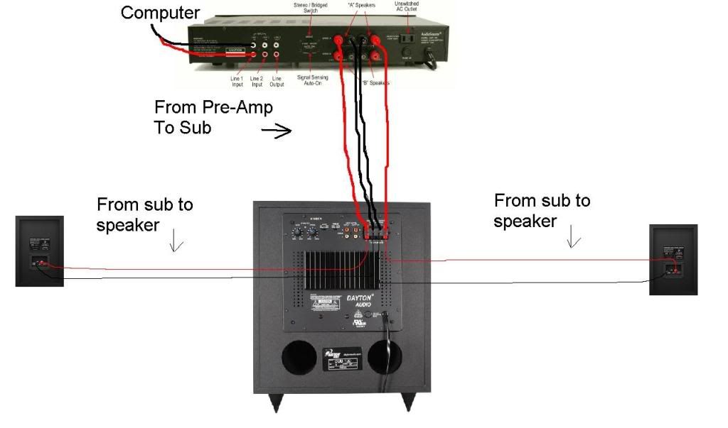

On the right is where all of the connections would go, one set would come from the amp, to the sub, then another set would go out to the speakers.
Here is a terribly made diagram off of paint, of what i was hoping this setup to look like without an AVR (with doesnt really need a diagram):
Final(-ish) questions:
1. Am i being logical? would this set up work?
2. would i need more parts to get this setup to work? (i.e. a power amp)
3. would i be able to control volume of both the sub and the speakers from the amp? (i dont care about fine tuning options, just plain old volume)

Yes, that would work (nice job :) ). You could use the A speaker outputs to the speakers and the B speaker output to the sub and then it the amp would be able to control the volume. I forgot about that. I was thinking you would use the line output from the amp to the sub and I am not sure that output is inline with the volume control. You can obviously also control the volume with your computer.
One thing to note, the speaker level outs from the sub are fixed, not variable. The variable crossover on the sub's amp only affects the amp, so plugging the speakers into the sub may not give you the best results if that crossover point is too high. Some subs have higher crossover points for use with smaller speakers.

Im not sure if my idea got mixed up, or i mis-read your post, but my idea was to run just from the 'a' output to the sub, (because it has a high-level amp in input) then run from the sub 'speaker' out to my speakers
http://junkies.files.wordpress.com/2007/05/sub-120c.jpg
if you squint a bit, you can see the labellings on the back of the sub. If that idea doesnt work, the line out might just work as well, if not it seems like i'd need an AVR.
Another thing is, the sub does actually seem to have a freq crossover control at the back, so that would be useful.

The way you have diagramed will work. What I am saying is, the speaker level outputs from the sub are FIXED, meaning when you adjust the sub's x-over, it will not affect the x-over point of the speakers, it will only adjust the sub.

Makes sense, i would need a AVR or something else to get the crossover to change the x-over, that shouldn't be too big of an issue.
