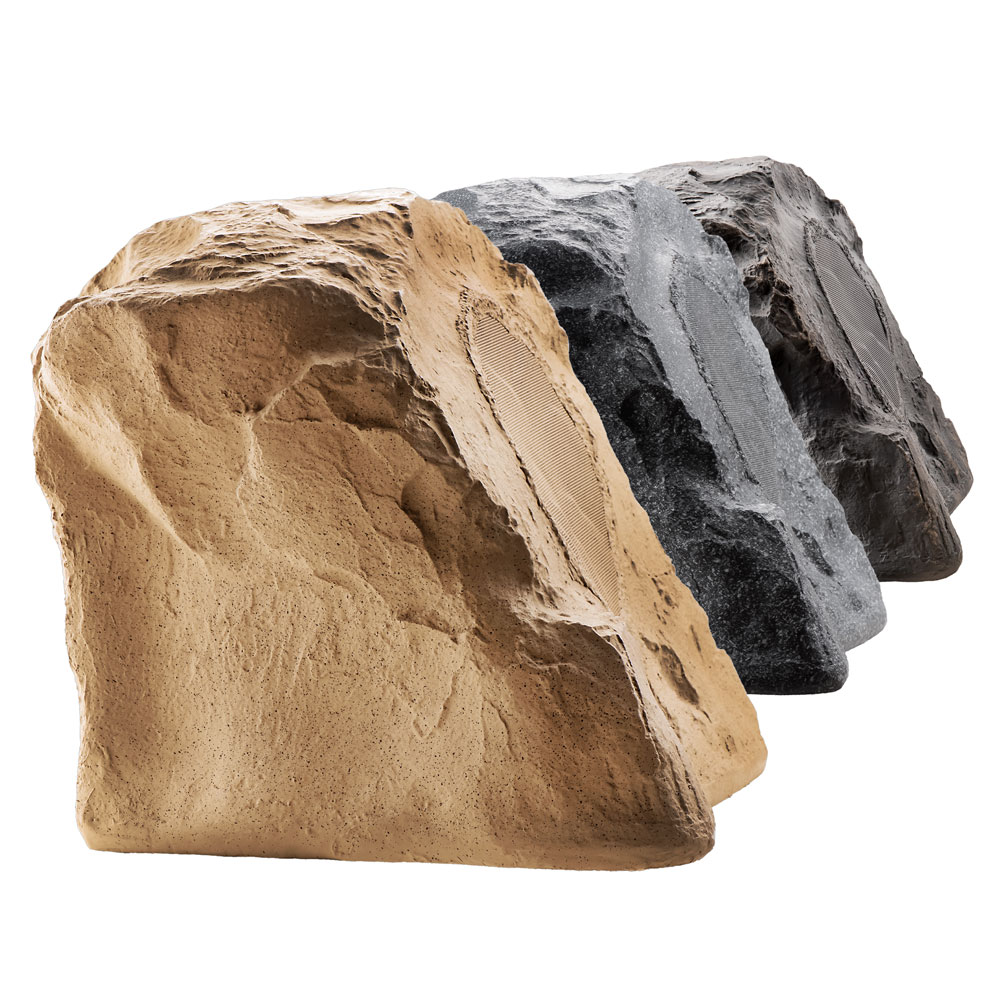

It's definitely the case that you would need some source for your outdoor speakers and that you would need to wire for them properly. Speakers are speakers are speakers is a simple reality. There are nuances, but they are pretty much all based on a very similar concept. Most consumer speakers from reputable manufacturers are 8 ohm. Some are 4 ohm speakers. But, outdoor, indoor, in-wall, bookshelf, floor standing, rock, planter, etc. they are mostly the same. Few normal residential speakers have internal amplifiers. If they do, they are typically referred to as an 'active speaker'.
So, you can buy any outdoor speaker which is appropriate for your specific setup and environment. Take a look at outdoorspeakerdepot.com for a wide selection of speakers designed for outdoor use as well as speaker wire that's designed to survive the outdoors.
Be aware that wireless speakers have internal amplification and will need a battery or a power outlet to work. No such thing as magic speakers that run forever without power. So, that's a consideration and generally why people just use normal wired speakers.
So, pick up a pair of these:
or these:
or something else that is appropriate to your specific location and environment. Then get a Sonos:Amp to run them if that's what you are using everywhere else.
