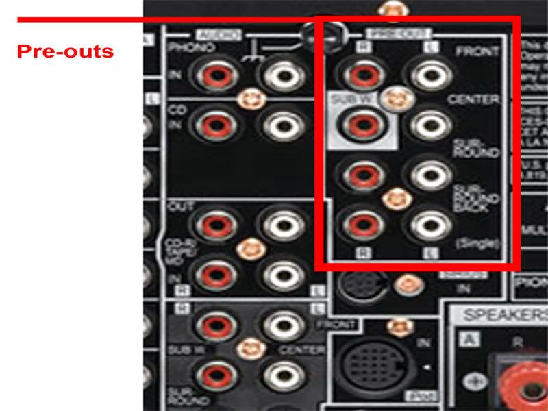

Alright, I'll try to illustrate some things to help you out here.
So this is what pre-outs look like. The difference between this and what you are trying to do by using the RCA's on your Video 1 output are significant.
Utilizing a receiver that has Pre-outs and using them allows all audio to be handled by the amps regardless of what Input Selection you make. So if you have a DVD player connected to Video 1, X-box to Video 2, and Satellite to TV/Sat and you select Video 1, or select Video 2 the audio will go through the designated Pre-outs to your amps.
What you've been trying to do is connect the RCA's to the Outs on the Video 1. The problem with this is that it will blast the amp as PENG has already mentioned. Further, the only time the Amp's will be in use is when you have specifically selected Video 1 as your input, if you ever wanted your Video 2 device to output audio over the Amp's you would have to re-wire your whole situation. cbraver's idea might work, though I don't think that would be the optimal solution. PENG's suggestion of using a seperate pre-amp also has the same problem of whenever you want a different source to output audio over the amps you will need to re-wire stuff/
From your original post, my guess is that you should be looking into buying a new Receiver or Pre-amp with the ability to do what you want more effectively. There are many in the $1000 range that can easily accomplish this task.

Thank you very, very much Thaedium for your reply. This was exactly what I wanted to know and you explained it in a way even noob like me could understand.
Now the only reason I want a receiver with pre out's is to control the 2 or more external amps I will be using to power some heavy duty cerwin vega's. I couldn't care less about hdmi, or 7.1 or dolby or any of that technical stuff. So, getting a $1,000 top-of-the-line amp would be an impractical route for me to go.
I'm taking your advice and junking the Sony receiver and am going to start over. Now I'm just a newly wed kid who doesnt have thousands of dollars to spend on my audio system, however, I did some checking on eBay and was able to find some decent looking Denon receivers with preouts in the 100-300 dollar price range.
Like this one
Surely something like this would suffice? It has preouts which is what we've determined I need. Anyways, I think I've found out what I needed to know. If anyone who is an eBay fanatic like me knows of some decent Denon models floating around in the 100-300 dollar price range that they use or like let me know!
