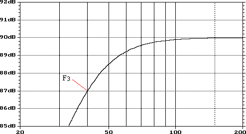

Frequency response plots
Hello all (again ;)),
Out of curiosity I clicked Audioholics' home page's link to the Axiom speaker package and more specifically the frequency response of the EP600 subwoofer (scroll down and click on 'Graph' on the left hand side of the page). I couldn't help but notice that for all intents and purposes, the graph falls off in a straight line below the natural limit of the driver.
Now, I'm not picking on this speaker in any way. I only chose it because it was handy. Any plot for a woofer would, I suspect, be similar but for the driver's limits moving further up or down the scale. My question is:
Why does the response fall off in an almost straight line? If a driver reaches its lower limit and then progressively struggles to output at the same SPL, why doesn't the graph show a slowly, but progressively steepening curved response falling off (such as in the attached plot below)?
Sheep
Sheep
Is that just a driver or a driver in a box?
When a driver isn't in a box (IE: Free Air) the back waves cancel out the front waves (in the low end). Thats why it rolls off steeper.
SheepStar
Buckle-meister
Sheep said:
Is that just a driver or a driver in a box? When a driver isn't in a box (IE: Free Air) the back waves cancel out the front waves (in the low end). Thats why it rolls off steeper.
The Axiom's response, which is the steeper of the two, is in its own enclosure.
Sheep
Sheep
Is it sealed? Looks similar to a sealed roll off in an anechoic chamber, but it rolls earlier then I've seen.

WmAx
WmAx
The Axiom graph is perfectly normal for a ported system. The graph that you attached to your forum post is probably a sealed system. A ported system attenuates at *24 dB/octave compared to *12 dB/octave for a sealed system. Also, your attached graph is not comparable to the Axiom graph. Please note the dB scales of both graphs.
*Note: The actual attenuation rate at any given point can vary dramatically, depending on the specific box alignment used. For example, one can design a non-conventional ported system with the roll off characteristic of a sealed system for much of it's attenuation range, only beginning to attenuate more rapidly at the lowest limits.
