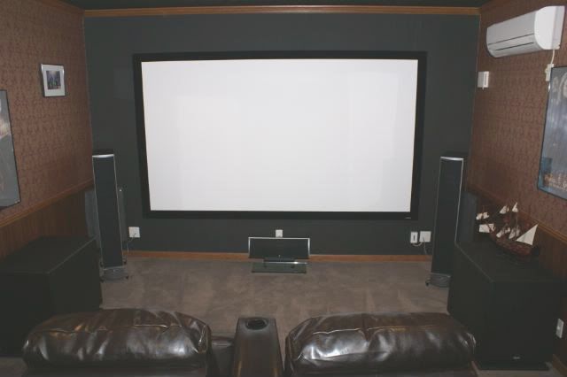

Another AH'ers setup. This is anamorphic, CIH type, belongs to mperfct:
Do it tRiXtA!
Man, that's a great looking theater! :D
I think my screen/PJ/Lens/materials was easily under $4k. I'd say it was probably about $3300. That includes the screen wall wood, SeymourAV material, frame, velvet wrap, AT cloth, Optoma HD80, Cavx MkII w/ CA coating, and mount.
I highly recommend it, and the only change I would do is to get a quieter, cooler PJ. The HD80 throws an awesome pic, but it's like one of those garage heaters.

In my opinion, considering the throw distance of 18', coupled with the fact that without doing major room arranging, I can't go with a screen less than 96" to be able to project an image properly at 16:9... even though the biggest screen my wall/equipment can handle is 72" is just a mess waiting to happen.
I have done some thinking and the original intent of this thread was "can this room function with a projector?" I think we have arrived at a definitive answer, which is one of these scenarios: "yes, but..."
At this time, I don't think all the "buts" are worth it for me. I do comprehend how kick *** a screen of a 100"+ would be. That picture you linked where it shows the plasma display under the screen is amazing.
All is not lost, however. This house I am in right now is not permanent. Asides from learning a ton of an area of home theater I was previously clueless about, I also am already starting to devise in my head exactly what I want in my next house... which just so happens to be an acoustically transparent 2.4:1 fixed screen with an electronic 16:9 screen mounted in front of that to accommodate several aspect ratios. ;)
Now that, gentlemen, will be something to regard.
As I was saying, I did not come out of this empty handed. I wouldn't even have known to do such a thing prior to this endeavor.
Thanks for all your help. It's been fun. I hope you're all still around for my next kick at the cat, because that's when I will really pull out all the stops. This room was never meant to be the best of the best... let's face it, there are certain pre-existing factors (such as the ceiling height, I could name more) that limit how fully functional this room could be. I really just view this as a practice run, and in my next house I can more confidently apply all my gained knowledge into a "true" dedicated home theater, not just a "rec room."
Cheers guys.
