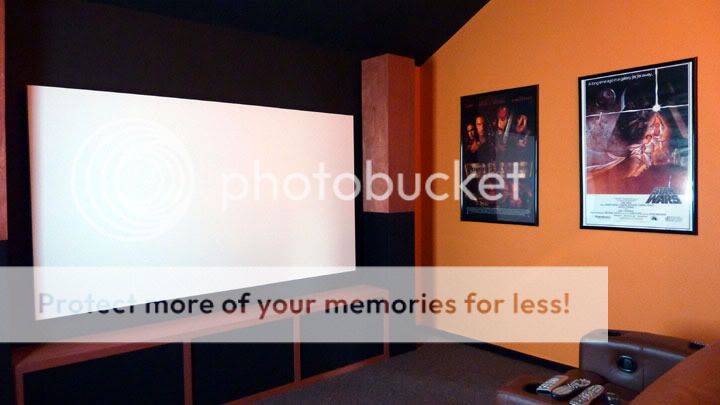

Just for the meanwhile and for things to chew on just in case, regarding fixed frame, well I wonder which brands of retractables might have a "black backing" (to reduce light bleed thru and reflection), if any of them. The official BB of Seymour is actually the exact same weave, a second layer, but colored black. The two biggest issues for me in order are, double the attenuation, def at least 4db now, if not more, and then the cost. I draped very cheap utility speaker cloth behind mine, and the wall is also darkened decently. The cloth does have a bit of sheen to it though. I wonder now if I'm better off removing it, but I'm guessing it's probably helping a bit, maybe it's all negligible for my setup. ANYWAY- if fixed, or shoot, even with retractables for that matter, and that there is no BB . . . if you cared* you can control the light reflections coming thru the screen and back again at your eyes. I think maybe the easiest/cheapest compromise could be to throw a cloth over the TV. Not so easy, a PITA and maybe for very limited effect could be throwing a big dark tapestry on hooks on most of the wall, besides covering the TV. Probably not worth the hassle. Again, I do wonder what kind of BB options the brands offer now for the retracatables if at all, never thought about that.

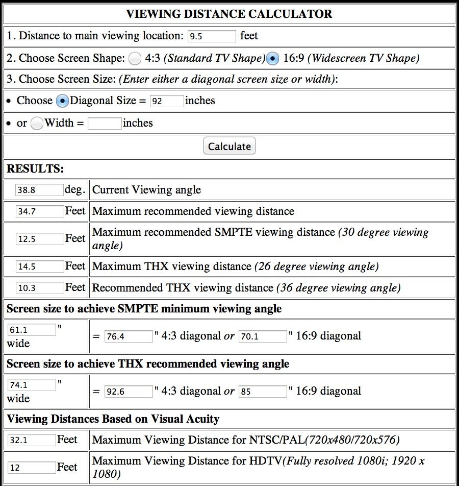

For the size of screen, use this calculator to find the viewing angles.
Viewing Distance Calculator
If for movies, I'm all for supersized, but still be careful, def share your viewing angle estimates. If for TV, the source is just simply less forgiving usually, but still can be pretty big. Superbowl is usually of decent quality, and I've watched that from a big angle before, it wasn't a problem. NBA regular season, not so much, or NCAA Final Four for that matter (I only get OTA).

Ah, I wouldn't go much past that. Many, many things on bluray will be fantastic at that angle, but certain things will already be too big as far as sports on HDTV, I guess namely basketball. I can watch most other sporting events at that size, but am not sure how much hockey I've seen with it. I have definitely played an NHL video game my brother brought over though, haha. Oh, Beatles rock band is impossible at that size. lol
IOW, I wouldn't go with the supersizing route with "covering all of the speakers". There is a chance you might welcome the smaller screen with the other option of fixed frame size. At this point it becomes the equipment+setup within the all important scope of personal preference. With my setup, I prefer a bit bigger than your current setup, but definitely not "way bigger". (Unless it was a 2.35 AR kind of thing, a can of worms that you shouldn't get into with what's going on there.) Regardless, let's hope for the best with Cinetension2!
