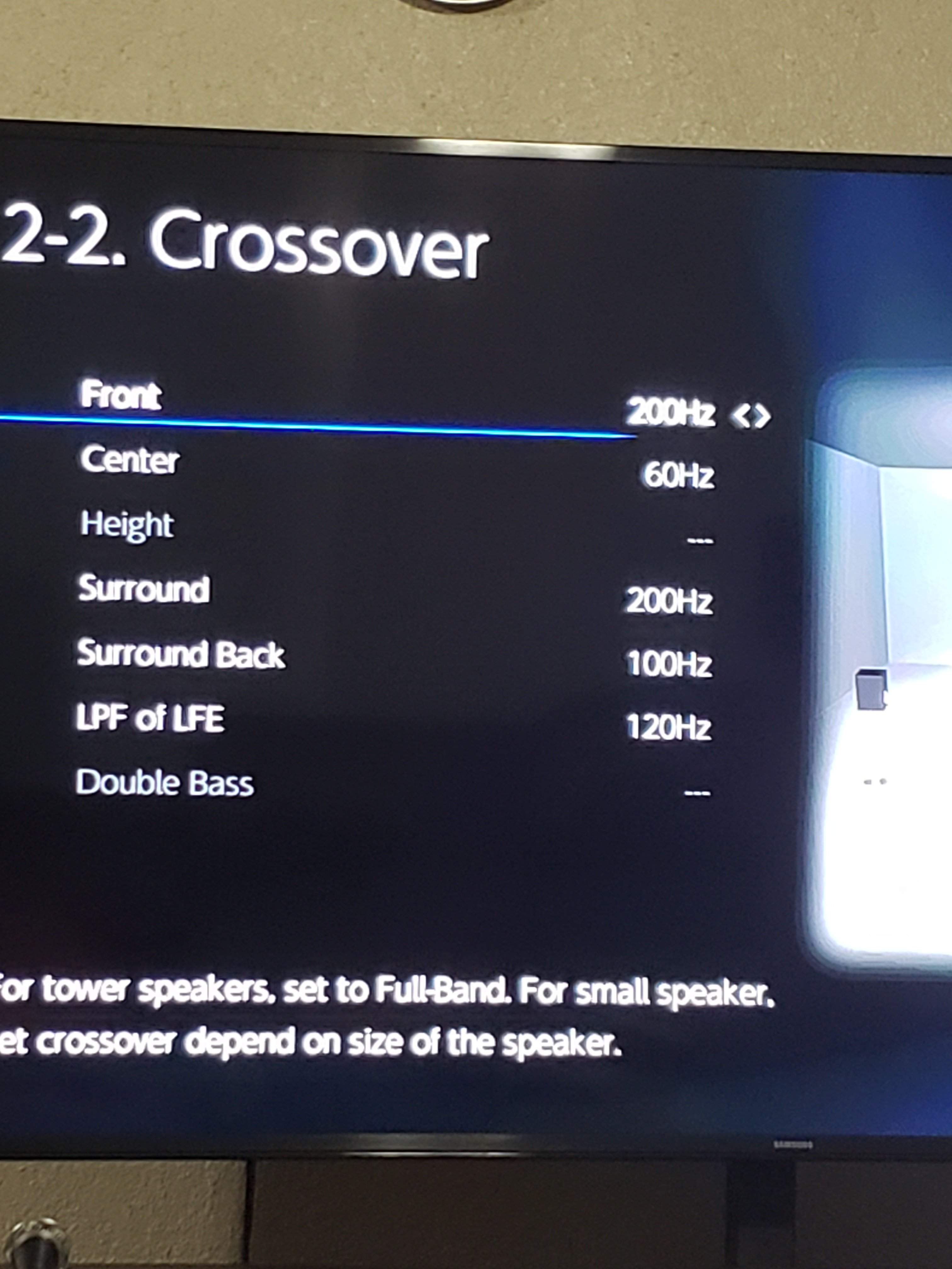

I just got my Onkyo RZ-620 but after doing the accueq calibration by putting the mic on a tripod on the couch, the subwoofer sounds way too loud and boomy. The other speakers however sound fine. I have polk monitor 60s as fronts, a 15-c as a center, r30s as surrounds, and t15s as surround backs. My subwoofer is a Klipsch r10-sw. I did some research and found klipsch speakers are historically sensitive. Could this be the reason why there is way too much bass? I also looked at the crossover frequencies and found this. Are they correct? I thought the thx standard was 80hz. If someone could help, it would be great.

Why are you crossing the front and surrounds at 200hz?

Just saw your other question. I would set the front and surround to 80hz to start. Then play from there. But as mentioned above I would first re-run the AutoEQ and see if it sorts it out. If not then set them manually for crossover and distance and see if that helps.

I ran it twice but it seems to always set those numbers. I guess I'll just set the crossovers to 80hz. I tried turning the level for the subwoofer down on the receiver but it didn't help much. Then I lowered the gain on the subwoofer which seemed to help. Is it ok to lover the gain on the subwoofer?

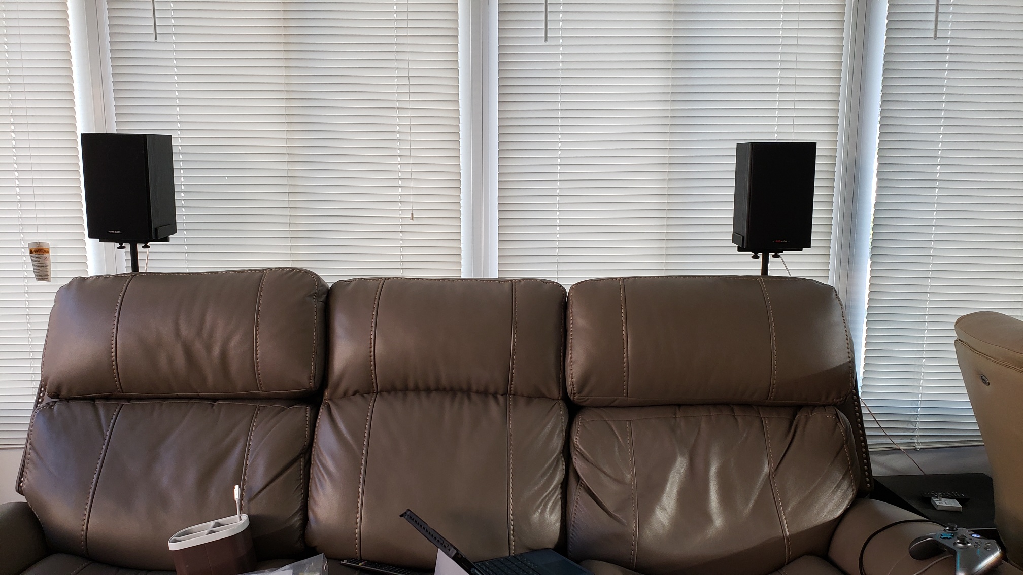

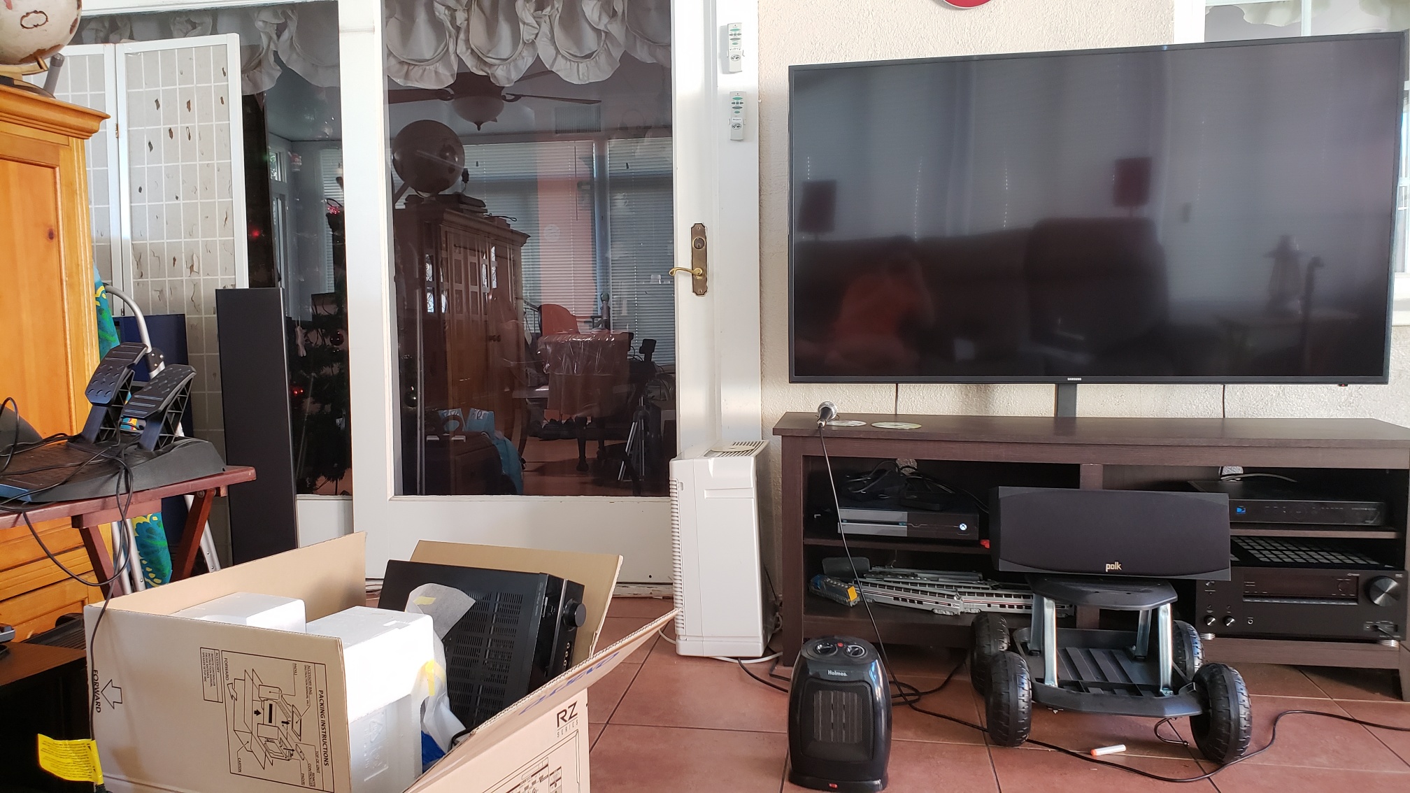

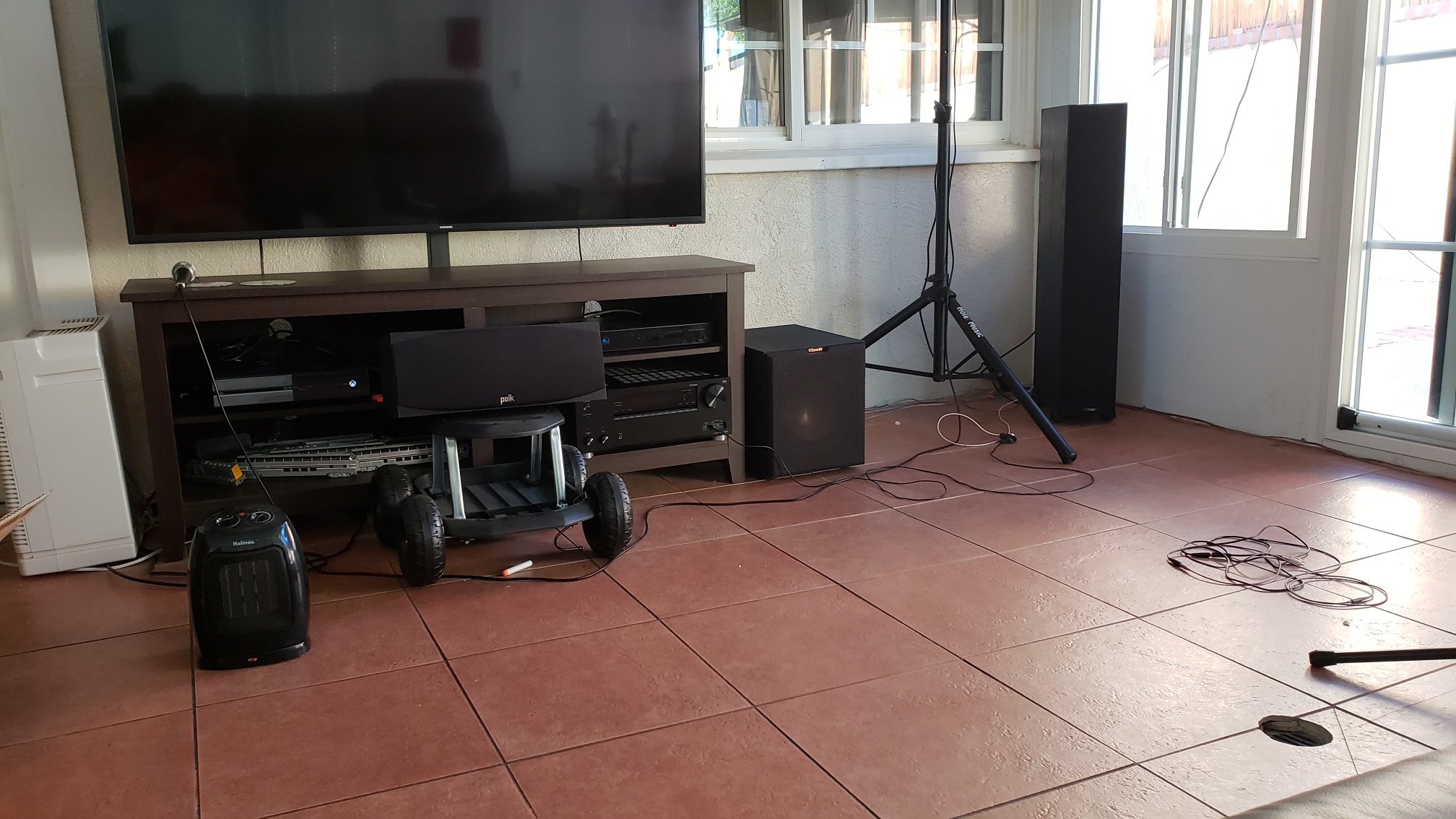

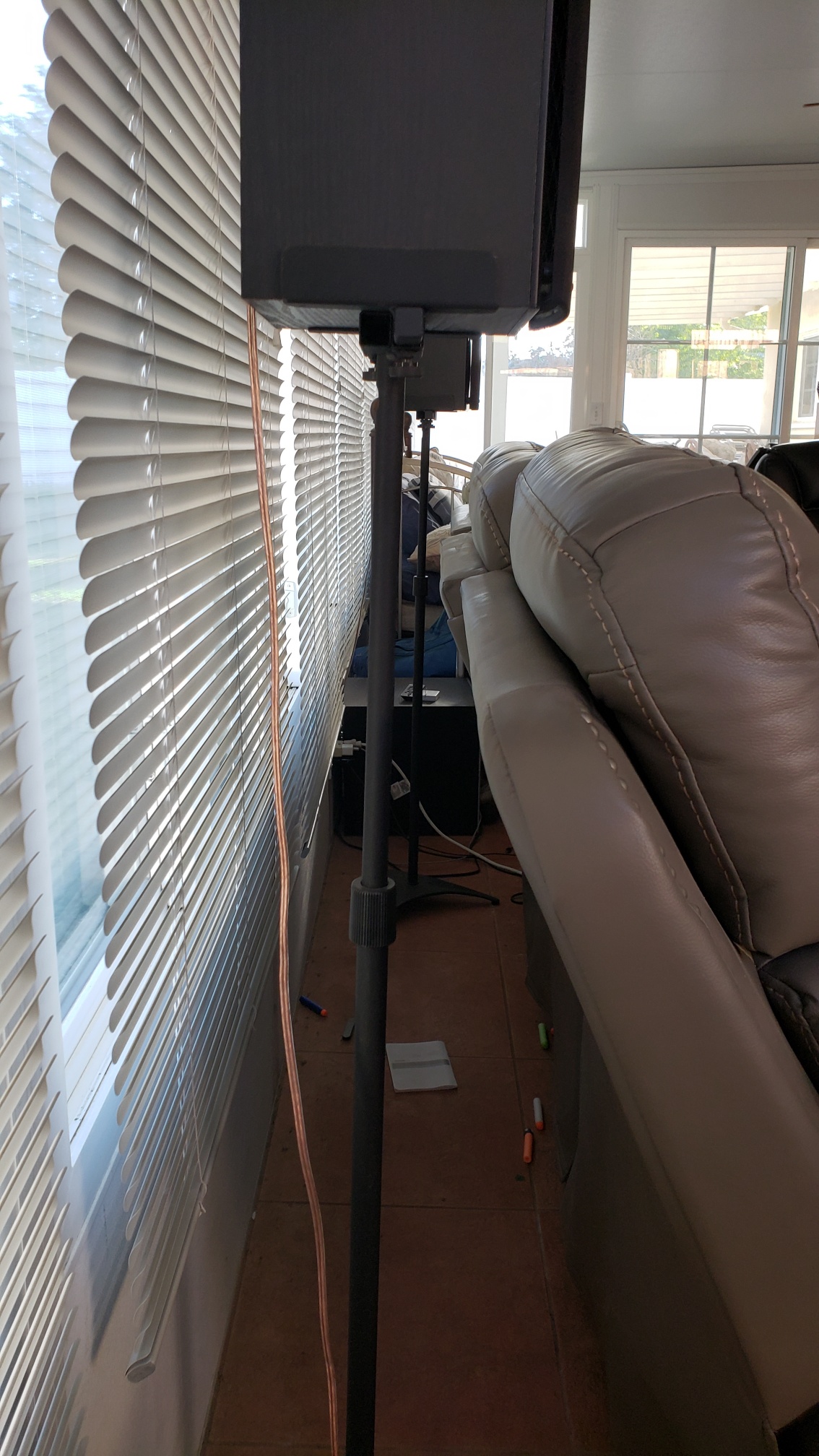

The couch is not up against the wall but it is close. There is enough space behind it for the surround speakers to fit. Here are some pictures(sorry if it's cluttered) 20181229_150518_resized.jpg20181229_150535_resized.jpg20181229_150603_resized.jpg20181229_150554_resized.jpg

The couch is not up against the wall but it is close. There is enough space behind it for the surround speakers to fit. Here are some pictures(sorry if it's cluttered) View attachment 27608View attachment 27609View attachment 27611View attachment 27610
It's pretty much up against the wall :) I'd not bother with rear surrounds like that myself (I'd want them a few feet behind). I would bring L/R speakers out into the room more. How did you choose sub location? Highly reflective room it appears, might have something to do with what AccuEQ is doing. You might be a better candidate to setup manually and skip AccuEQ altogether....do you have an spl meter?
