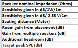

May be my question to AVUser in post#41 is not clear and I should add the following background info in the linked article (wrapped in quote)
A question that frequently comes up when designing a home theater is 'how powerful an amplifier do I need?'. The answer to the question depends on a few things, in particular how sensitive your speakers are and how far you sit away from them. When we design a home theater we want it to meet...
www.acousticfrontiers.com
So clearly the writer was counting on the 3 dB crest factor, the peak to average ratio of a sine wave that represents Power, the product of voltage and current to make his point about the 3 dB build in headroom that he thought we did not know about when using some of those online calculators such as Crown Audio's.
My question is, is the THX reference level of 85 dB + 20 dB peak based on the peak of the sine wave, or the average?
