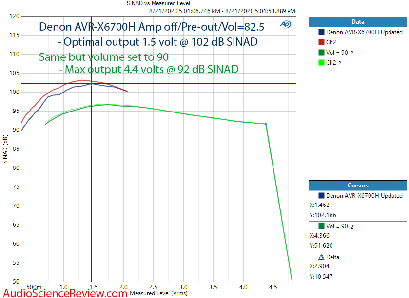

Below are the SINAD vs output voltage curves for the X6700H (Amir measured it up to higher than 4 V, but only for the X6700H), I think he assume the 3700/4700/8500 should be similar.
Note that to achieve 4.4 V, he had to set volume to 90, that would be +10, and that's with input signal at 0 dBFS, that would be about 110 dB from the listening position. Nobody does that in the real world I hope.:D

Please do yourself a favor and do not believe that 1.4 V max thing. Just look at the curve I posted earlier and you can see that the maximum is at least 3.5 V, most likely started to clip at just over 4 V.
Power Amp choice for X4700h | Audioholics Home Theater Forums
Amir mentioned the 1.4 V a few times for the Denon AVRs but you have to read the caveats, that at above 1.4 to 1.5 V, distortions and noise levels would start to increase so the peak performance in terms of THD+N is at around 1.4/1.5 V, that is very different than saying 1.4 V is the maximum.
