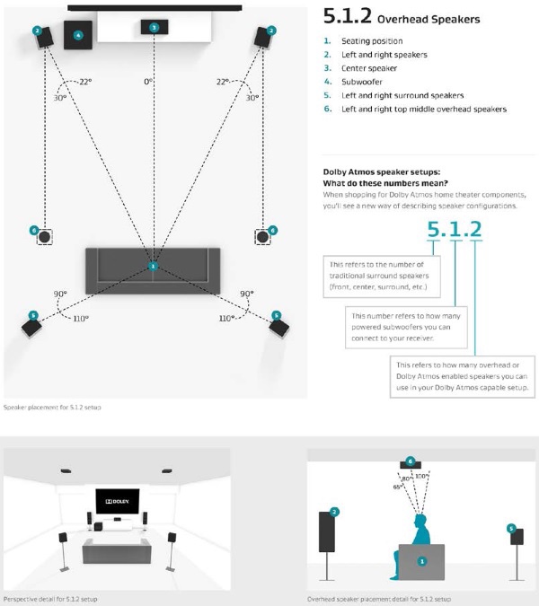

It’s 5.1.2 instead of 5.1.4 with slightly less power.

So for me, if you’re keeping the layout how it is. I would go with 5.2.2. Put the atmos speakers in the flat part as far forward as you can and use “top front” speaker designation like this.
If you put them in the front sloped part, you’d use the front height designation. IMO, front height isn’t as good as top front so I would use top front.
The reason you can’t put .4 above you IMO, is there’s not enough height combined with horizontal space.

Point 3 the reason Shady is suggesting against atmos where you currently are is due to spacing and dispersion issues. The atmos speakers in front and behind will be too close to you both front and back and your surrounds will be pretty close to your couch from that spot. Not enough room to make it work very well. However! Lol If we change the layout of furniture it works just fine.

So tell me, why a 5.1.2 versus a 5.1.4 again? Why can't I put four speakers in the ceiling to the side of the fan and all pointed at the LP? Move the couch us a little for the rears, move the coffee table, have my two towers in the front...why wouldn't that work again? Also, I have very little room to mount that TV if I leave everything as is. What is the mount I would use then that would push the TV out and up so I could have room to either mount the center channel under it, leave my current stand there in place and put the center channel on it, or build custom shelves? I have an Xbox One X and a Nintendo Switch set up and stored in my stand right now.

I don't think there would be a significant benefit going from 5.1.2 to 5.1.4 for such a small listening position area. I don't think there is ant harm in doing so, but I would guess its better to save that money and invest in better speakers/subs rather than more speakers. You might be surprised at how much of that "bubble" effect can be accomplished with just a properly set-up stereo pair of speakers, nevermind a surround sound system let alone an Atmos system.

Oh, and you do think that putting the Atmos speakers in the slanted part of the wall and facing the LP is the way to go versus in the ceiling overhead and pointed down towards the LP? If so what type of speaker would you get for each scenario? And what's this bipole speaker thing the other fellow was mentioning? I'll hunt down his responses, too, were also very detailed and helpful. I assume that makes them turn different directions?
I think that putting Atmos speakers in the ceiling segment facing your listening position is the way to go. Atmos speakers are supposed to project sound at a certain angle with respect to the listener. The problem with that room is if you mounted those speakers to the top portion of the ceiling, sound would badly diffract from the slanted segments. I don't think it would sound right, it might sound like you mounted them in a corner which could lead to a 'cupped' sound effect.

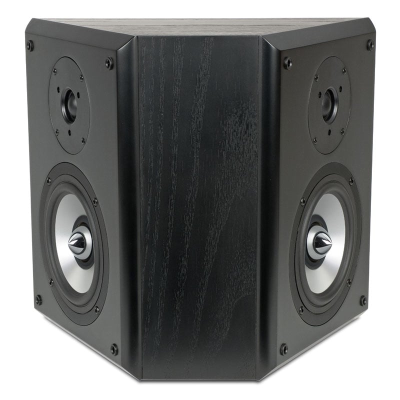

As for bipole speakers, those are speakers that project sound from two sides for very wide coverage, like so:
They have a more diffuse sound. I don't know that I would use such speakers in your situation. I think that you can use regular bookshelf speakers just fine so long as they are not too close to the listening position. Typical bookshelf speakers are monopole speakers meaning they project sound in one direction. It is easier to control their sound so I would go for those. Dolby Atmos mandates monopoles for all speakers in a system anyway.
