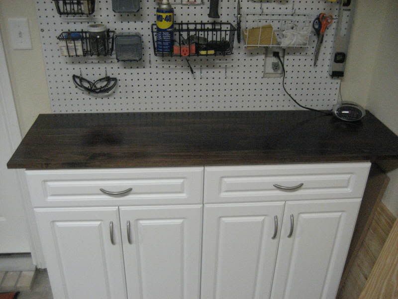

The work top of the garage cabinets was the first thing I have really cut. It turned out pretty darn nice and straight. I just used a skill saw and clamped a 2x4 to it as a saw guide.
I think my stain job turned out pretty good too.
That looks pretty darn good to me... Lots of sanding? Urethane?
