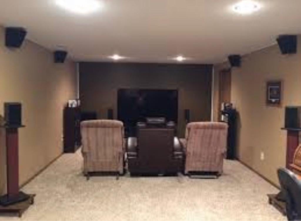

Anyways, I would go with a side height install if you can.( it’s closer to a TOP front instal). Imo the front height, where you describe can’t get enough “overhead” sound. The speakers should be just fine. But aim them at the LP.
This pic uses four side heights but you get the idea.
Ok thanks for advice. I'm not totally sure how I would do that because I think these just have the keyhole on the back for mounting. I do like this idea though as it will be closer to the listening position. Thanks again.

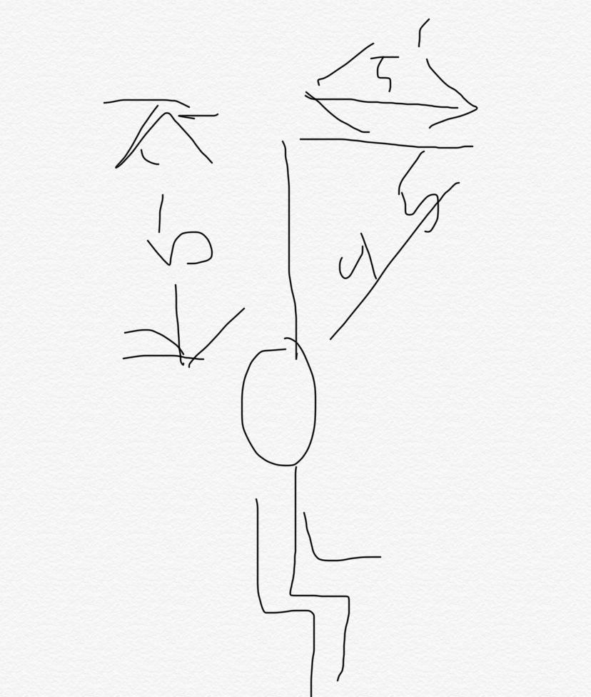

Like @William Lemmerhirt said, up-firing Atmos Speakers have a crossover specifically designed for the "bouncing" application. According to the XT90 manual the frequency response is 164 Hz–17 kHz. I don't know how Audyssey is going to handle them. I've avoid bouncy speakers since they came out. I just can wrap my head around the concept delivering.
Normally in ceiling or on ceiling Atmos speakers are the same distance apart as the L&R between the mains and the MLP. They are no to be confused with Front Height Speakers

6’ seems pretty close together to me. But I don’t know how wide the room is either. Iirc 60° apart for LR. The general recommendation for heights is 45° front to back and side to side. So if you had 4 tops, and the seated ear height was 36” that means with 10’ ceilings, you’d have 7’ from ear to ceiling. That would mean 7’ in front and behind.
For 2 heights, the pic that @jim posted is right. Having fairly high ceilings like yours means that you might get a good experience where you intend to place them. Lower ceilings wouldn’t allow enough separation. I still think side heights are better but that’s a lot of extra cable to pull.
