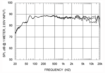

Here's the curves for the Synchrony ones which are now considered there flagship I think..
I don't see a hump at a 100Hz

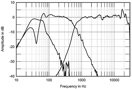

I'm talking about this hump in the response of the Synchrony 1.
From this review in Stereophile.

TLS, wouldn't the listeners (when sitting face on) here the overall response of the system as in the 1st graph measured at the NRC rather than the indvidual drivers as depicetd in your graph?
http://www.soundstagenetwork.com/measurements/speakers/psb_synchrony_one/
It is there. It shows in your graph as well. The bass end response is very lumpy. There are actually two humps in the bass decay. The higher one would be the most noticeable. A 5 db hump at 90 to 100 Hz would be very audible, and make the speaker very position sensitive.
The reviewer noted that, as well as imparting a humming sound to piano. That is exactly what I would expect from the curves.
The designer is trying to solve a big problem of ported speakers, which is port kick in. The port assists the driver over a very narrow frequency range. However having three tuned cavities with three ports radiating different frequencies would be very hard to pull off.
On the other hand a properly constructed TL will give the drivers a gentle smooth assist over 1.5 octaves. And the bass roll off will be 12 db per octave to the region a little below Fs of the driver, unlike ports the roll off 24 db per octave. So you get a stronger low bass from a TL.
I'm excited to see PCM blazing a trail. We have not had a speaker manufacturer producing a large line of TL speakers since TDL closed their doors, some years after the untimely death of John Wright. PCM seem to be making big waves in the professional studio world, and have been really noticed by Bryston, who are developing active speakers with them. I hope I can get a chance to audition them at some time.

If I measure 5db down from the highest bass bump (89db) , I get 84 db but at that point, I'm sitting down between 50 and 55 Hz. Are you speaking relative to the 50Hz point because a big part of the frequency curve lies at 89 db.
From the graph I'm estimating the average level at around 87 db. However the 90 to 100 Hz range is peaking to 89 then drooping and peaking to 89 db at 75 Hz, with a rapid fall off to a shelf at 82 db from 40 to 60 Hz followed by a typical Qb4 box roll off of 24 db per octave.
That will be perceived as too much energy in the 75 to 100 Hz range. A smoother roll off from 90 Hz would likely sound better. I have to say that was lot of work for little gain and some disadvantages.
