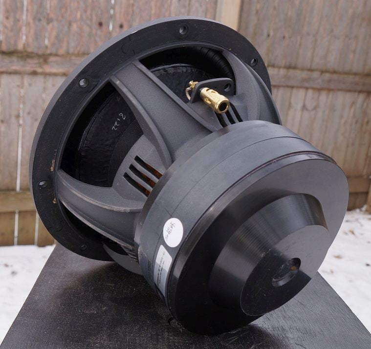

This is pasted from the specs on Monolith's product page. This is just for the 10":
Xmax18mm (one-way)
Xmech78mm (peak-to-peak)
Just look at the build on the Monolith 10" driver:
This guy is a goof. He either doesn't know how to read a spec sheet or is lying to you.
