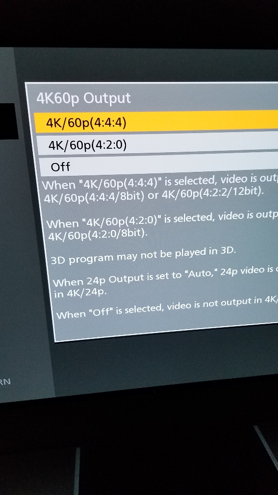

Also, Paris...I know you mentioned that I should be seeing "8-Bit" with SDR content as far as the player's output, but here's how things play back when I check that output information:
With regular DVDs, the player is outputting:
Source: 720 x 480 SDR/BT.601 - YCbCr 4:2:0/8-Bit
Output From Player: 4K/60P SDR/BT.709 - YCbCr 4:2:2/12-Bit
With 1080p Blu-rays, the player is outputting:
Source: 1920 x 1080 SDR/BT.709 - YCbCr 4:2:0/8-Bit
Output From Player:
4K/24P SDR/BT.709 - YCbCr 4:4:4/12-Bit
Now, what I think is happening is that, with 1080p Blu-rays at least, the player is using its chroma upsampling feature to bring the content to 4:4:4 chroma (from 4:2:0 on the discs)...with regular DVDs, I was told that the player is NOT sending these as 4:4:4 because of the limitation with 60FPS content (which the DVDs are).
Does this clear some stuff up? :confused::oops:o_O

Have you tried the exact same thing but disable the 4K/60?

Oops I meant if you change this setting to 4:2:0, what will the player do differently than what you just found out. Presumably it will output 4:2:2 (for 1080p and UHD?) and the TV will do the rest.
Then there are combinations with the Deep Color settings.

I never tried it; however, I just find it weird that when I first turned the player on, out of the box, this menu automatically selected "4:2:0" for my connected Samsung...when I did the factory reset, suddenly the player chose "4:4:4" here, and my Samsung CANNOT support 4K at 60P 4:4:4 (I don't think any current display can, am I right? This is a limitation with the HDMI implementation we're currently at, I think)...
Someone over at the vile Blu-ray.com forum told me that on his Panasonic -- I think it was one of the cheaper models, the 420 or 820 -- it did the same thing: That is, when he made some "tweaks," his player suddenly began reading that it COULD output 4:4:4 4K/60...
Very very weird.
What do you keep this on? And your 9000 is connected to a Sony OLED, correct? I may be wrong about that...
When you have a chance, I'd like to once again go over all my settings as it pertains to the UB9000 > Samsung NU8000 marriage to make sure I'm up and running correctly (I have already taken your advice regarding just leaving the HDR Optimizer ON and not touching any of those HDR picture controls, instead leaving them at default of "0")...if that's okay. ;)

Wait a minute -- I think I just discovered something, looking at that screen shot you provided of that "4K/60P OUTPUT" menu...
Reading the explanations under the settings a bit better, it seems that the "4K/60P (4:4:4)" setting here simply means that the player will output EITHER 4K/60P 4:4:4 8-Bit OR 4K/60P 4:2:2 12-Bit...but that's ONLY if the source is, say, Gemini Man or Billy Lynn's Halftime Walk...with THESE discs, the player will select 4:4:4 8-Bit if that setting is adjusted to 4K/60P (4:4:4) -- do I have that correct?
This ONLY applies to those kinds of discs, as you were attempting to explain to me early on in the thread, right?

Yes that makes sense. I do have Gemini, so I can test that
