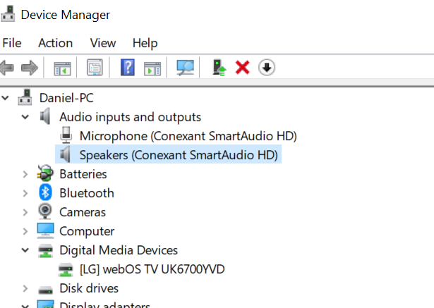

Honestly I don't know, but I doubt it, laptop is a lenovo yoga 3 (14" not the pro) about 4 years and a bit old.
That's the reason I was thinking in the direction of simply buying an external sound card (with a toslink output).
Here's a screenshot from the device manager

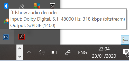

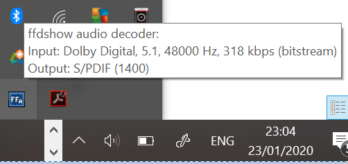

Right, so the DAC arrived today. Now I need to get it working...
Thing is the AVR only recognize pcm. I tried both BSplayer and VLC player.
Here's what's the DAC showing me during a DD movie:
Any ideas? Or is this device can only give me a pcm output?

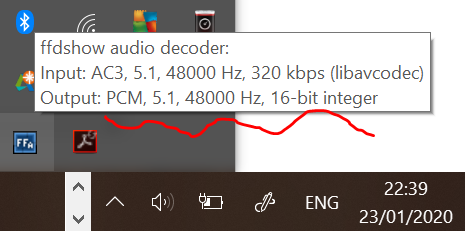

Edit:
played with the definition a bit, now getting this:
Still in pcm though

One thing is that I'd use LAV filters over ffdshow. They tend to do a great job.
Also, what do you have your output set to? Example:
2020-01-23 16_08_06-Playing movies through my pc using an external sound card _ Audioholics Ho...png
I only have a 2ch DAC hooked up to this PC, but when you select your interface it should have similar options.

My AVR support dts/DD, for example I do get DD from netflix or playing a DD file through my smart TV.
Connecting the DAC via toslink to the AVR yield only pcm.
Couldn't find a driver for this DAC.
Only found one evident online of someone mange to get DD/DTS with pcm2704 chip here:
With that specific DAC it looks like it is a 2ch only device. You'd need something that specifically supports bitstream DTS and DD. HDMI is the best/easiest route, but the DAC you have will work, but stereo only.
