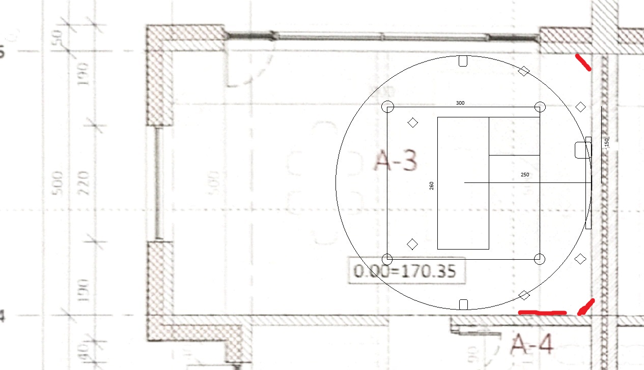

Hi,
I'm planning to move to another place and one of the motives of doing so is to plan a home theater in the living room.
The living room is 6x8 meters and is combined with a kitchen, my initial layout plan is attached:
The rectangles and diamonds are floor speakers, and circles are ceiling speakers.
From what I've googled/youtube'd my backs are too close, but I have to compromise here as I can't move them further away into the kitchen area.
Few questions:
1. Any general advice on how to easily improve this or avoid some obvious mistakes?
2. I'm considering Klipsch RP-8000F II as starting point for fronts and I need suggestions what would be best in this layout for center/sides/rears

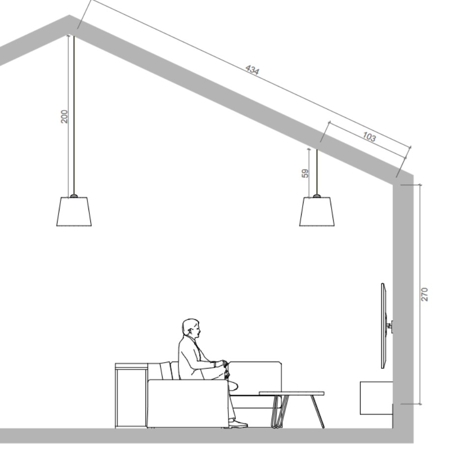

3. My main pain point is ceiling, it is vaulted ceiling so I'm looking into pendant speakers, Klipsch has some options like IC-800-T but I don't have a clue if it fits with this setup, or how do I choose a good fit from other brand?
4. AVR recommendations?
dolynick
Have you considered dropping the front wides and going with one set of more centralized overhead heights?
There's certainly no harm to having them but if I'm reading your diagram right, it's only about 15' or so from the front wall to the rears - which is not really that large a space. I'm not sure that front wide speakers are really necessary. I have two sets of heights in my 7.2.4 setup as well, but setup is stretched over a 25' long area. It looks weird to me to have the rear heights actually behind the rear speakers (although it may not really hurt anything either). You could narrow the spacing between the heights, but if the spacing isn't that much, perhaps one pair would do.
You might also want to consider a pair of subs instead of one. Take the money saved by cuttiong out some speakers and put it there instead?
I agree that a hanging speaker is the way to go here. With vaulted ceilings, reflection upfiring atmos isn't going to work very well and would likely be a poor substitute for an actual overhead speaker.
No really recommendations for speakers. It'll be pretty subjective to taste I think. I'm partial to something like a Paradigm but finding something with an offering actually designed to hang pendant style might be tough. I'm not sure if a traditional in-ceiling speaker will work properly if suspended, and it might look a little too unfinished for your tastes as well if you can see from a far enough angle. Perhaps you could build some housing boxes to mount them in and then suspend those? It would certainly open up your options.
For AVRs, I expect any of the major brands will do the job. They all have offereings over various price points and amp channels. I'm partial to Anthem and it's ARC system, but used Yamaha for years before that. I see Denon mentioned a lot in various forum discussion but have never personally used one. Onkyo gets mentioned as a high quality but cheaper alternative. Everyone has their favorite though so I'm sure opinions will vary.
Budget and what does the audio budget have to buy, you have anything now? Is it TV or projection? Is there a center or sub (or is the larger rectangle a sub, why only one in that case)? You're going 8/9 base layer four ceiling and using wides in the base layer? What kind of angle does the vaulting have? I'd figure out speakers before avr/amp.
I've added front wides as a last minute consideration, I guess I will get wiring for them, but not gonna buy them initially if there is little to no difference in this case.
If I'm reading scale well, I'd not bother with the wides myself. Really no advantage with the location of your surrounds/mains I think.
- In my current place I have q acoustics 5.1 setup with denon X3500H, but I will be replacing it.
- The budget allows mo to shell out 2K eur for pair of fronts and building it from there in comparable pricing range.
- It will be TV ~85'
- There will be center.
- Larger rectangle is the sub, only one because I don't know any better. Should I place the second one symmetrically?
- Wides same as no second sub, I just don't know what would create the best setup, this is based on few days of google searches and youtube videos.
- Vaulting is ~18 degrees.

TLS has some good points there, although I still think you could achieve an atmos (although sub-optimal) result if you wanted. The question is if the cost and effort are worth the partial success. Your call.
Two subs will likely just give you a more even bass result. Your room is also fairly large so the second will just help with filling the space in general.
With the length and the vaulted ceiling, I think your room is likely to have some (or a lot of) echo in it. The rear side vaulted ceiling slope in particular might be an issue. You may want to provision for some absorbers and/or diffusers if possible.
My room is 25'x14' with a 12' section open on the rear half of one side. It still sounds pretty good down there (in the MLP at least). But my room has a relatively low and flat ceiling. I don't recall every trying to get a surround system working in a room like yours.

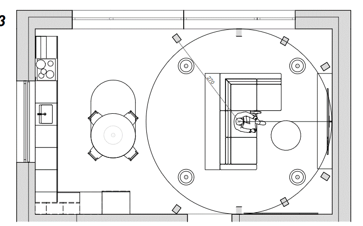

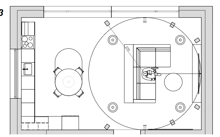

Found new place for rears, hoping this makes it a bit better?
Most of those speakers are in the wrong place. The surrounds are in front of you. I would get the surrounds in the right place, just behind you and definitely get rid of the backs. If you do this the ceiling speakers need to more closely follow Dolby Specs, Move then in a bit and the front and back ceilings a bit closer together.
That listening area is way too small for surrounds and rear backs. In fact you likely would be better off with just two ceiling speakers and not four.

I thought your original location for the rears was alright. The rear heights overhanging them was more what I was looking at.
Atmos is like a half-circle bubble around you. Try thinking about your speakers being on the wall of that bubble in terms of positioning. If your heights are well above head, then your diagram makes it more of a square with more vertical front and rear ends rather than a curing slope bubble. I would think they should move inwards towards the MLP a bit, and that puts them relatively close together then you might want to consider combining them into one pair - probably just a touch forward of the MLP.
If it was me, I'd also move the rears back in to a more behind the couch position again.
