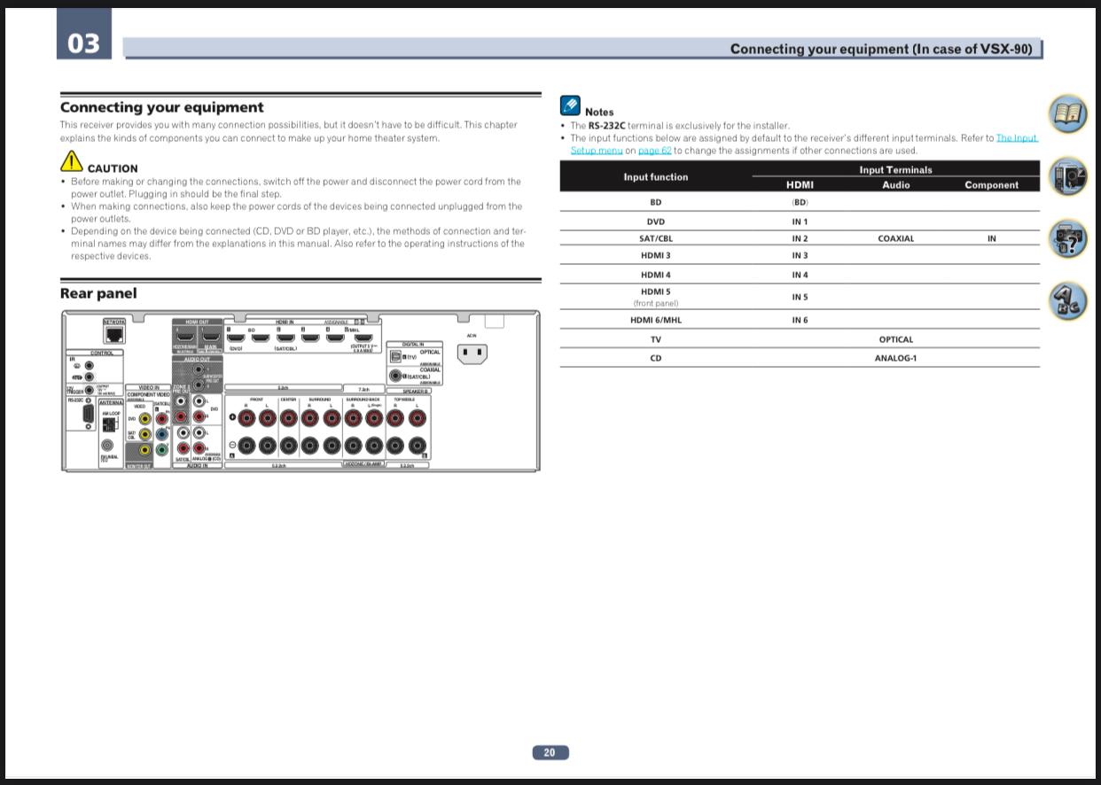

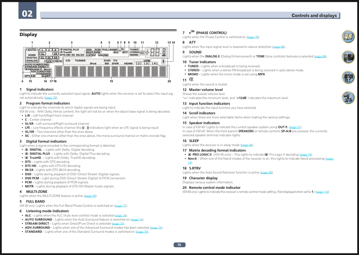

How are the devices connected to the receiver? The channel lights in the upper left corner indicate the input channels of digital signals. Notice the pic shows an analog signal from the AM tuner and no digital channels are lit up. There are also the digital signal format indicators including DD, DTS and PCM. They also will not be lit up when playing analog signals.

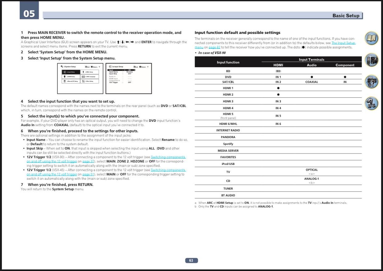

Not if you have not assigned your inputs correctly. I have a feeling this unit is fine, and you have no clue how to set it up.
Get the OSD menu on your screen, then get your inputs and speakers correctly set up.

Nobody can answer that question without knowing about ALL of the devices in the system and how each of them is connected to the receiver. The receiver defaults to certain ports for certain input sources. Make sure the cable used to connect a particular device is the appropriate cable for the corresponding input source default setting. If not so, the input source setting will need to be changed to the appropriate cable port.

I’ll have to look more into the details in the pictures and check everything thing over ether tomorrow or some time thine week when I have time. I’ll let you know what I can figure out.
