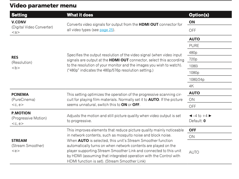

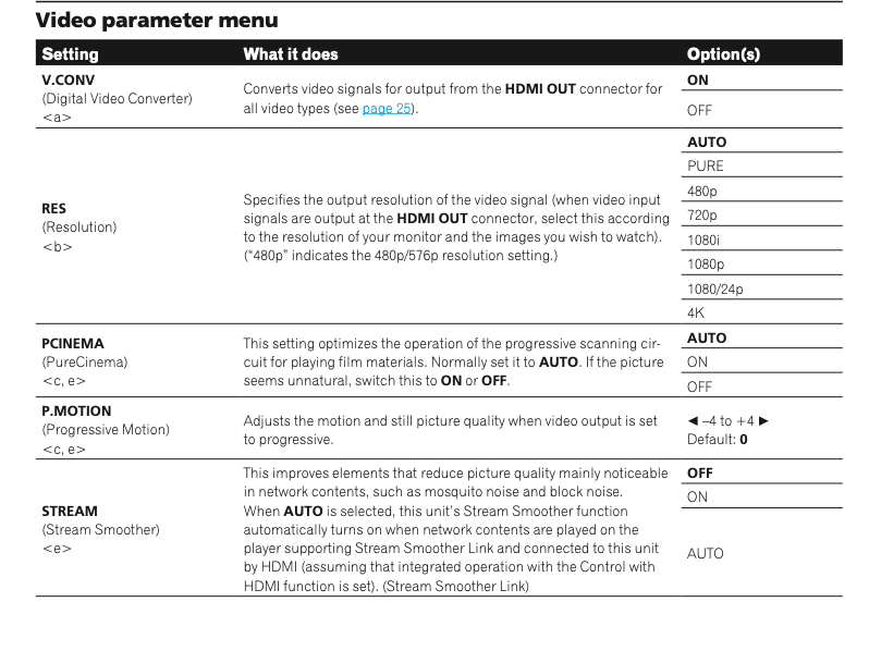

Yes I have tried multiple HDMI ports (Input 1, input 5 etc). the moment projector is turned on the audio gets cutoff the speaker (L R )icon in the SC-71 goes away. Tried all the setting in vidoe parameter like Vconv off/on Res 1080p 1080i, 720 p etc.

Firestick I changed it to 1080p from auto
Receiver I changed it to 1080p from auto

Again the V conv is on and RES is 1080p
Firestick Display is 1080p
Projector info shows 1080p
