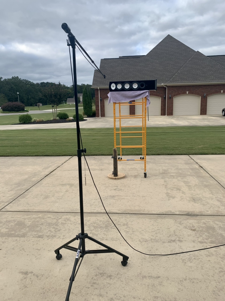

I think James would have needed a hot air balloon to get high enough to take a full set of verticals for the Spinorama protocol.

Aside from how you or I feel about the importance of SPIN data, I do wish you had the ability to provide the vertical data here (more than is provided). Namely because with the CTC spacing here of the mids I am curious how it compares to the intentionally-arrayed design of the Perlisten. The Perlisten has a vertical window of about +/-30 degrees above 1kHz and it is very, very well maintained. I'd be curious to see how this BMR (and other subsequent MTM designs) compare in this way. Even more so because you had such positive things to say about the Perlisten's vertical directivity.
And as an aside, I 1000% understand the issue with acquiring vertical response data for a speaker like this. I have the NFS now... but I was measuring the "hard way" before that and went through many, many rounds of testing methods to find one that allowed me to provide full vertical measurements of large/heavy speakers. So, if you wanted to do that, you might consider the method I landed on - which was pretty damn rigged but worked quite well - and had less "pucker factor" than my previous methods (my god, you should have seen the ladder/chair/cinder block rig I had before this). If you are interested, PM me and I'll give you my number and I can walk you through exactly what I did. $200 or less and you'll be able to provide a full set of data for these kind of speakers.

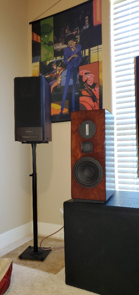

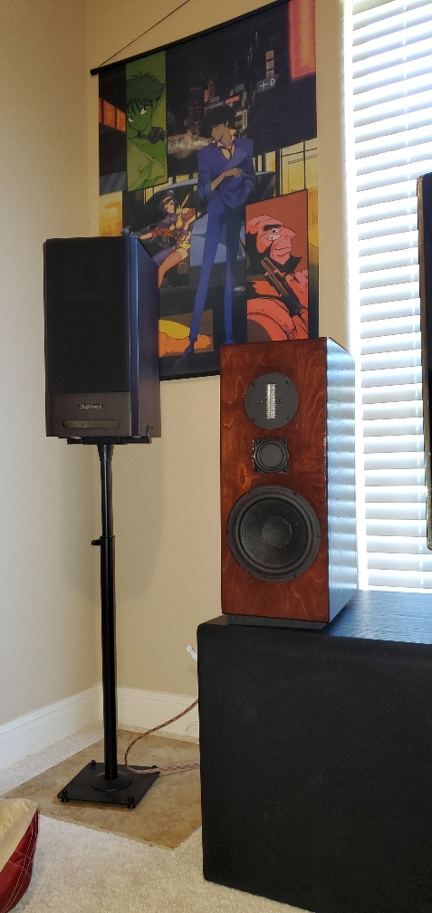

Nice job! Did you make a build thread for those?
nah, I just posted about it some and some pics in this thread

Hey Erin, I can see what you did there, and that is a clever approach to measuring tower speakers vertically, but for a number of reasons, that approach is not practical for me. Sometimes I try to get the 'listening window' verticals for towers, which I would consider the most important verticals, as I have done for the BMR Tower review.
As for the spin data, I am not dismissing it, but of the data I do provide in my reviews, I don't think it is as useful as the polar maps or waterfall response graphs. However, for some recent tower reviews, I get people asking why it's not there, yet I have even better graphs available for the same loudspeaker. I guess that's a change for the better from when I started posting spin graphs when few people even understood what those curves meant.

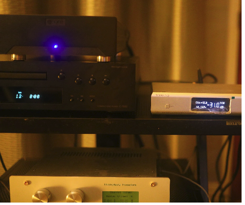

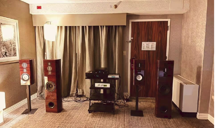

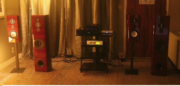

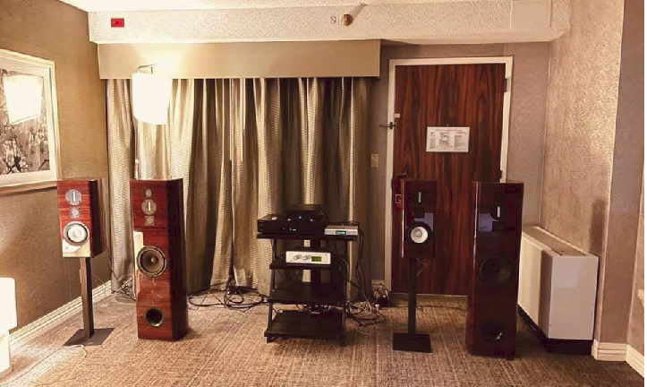

Yesterday morning I went to at Dennis Murphy's house to load up all the speakers (2 BMR Towers and 2 BMR Monitors) and other gear he wanted for the Capital Audiofest. We got nearly all of it in our two cars. The two large cartons, each with a BMR Tower speaker, were quite large and heavy. I believe these were the same two speakers that shadyJ used in his review. They were too large to get into my aging Volvo S70 sedan, but we slid them into Dennis's VW Golf hatchback – the hatch door just barely closed. All the rest of the stuff went in my car.
We then drove to the Twinbrook Hilton hotel in Rockville, MD, looking like we had just robbed a Best Buy store. Outside the hotel we saw lot's of trucks and trailers unloading their audio gear for the show. I was glad to see Jim Salk and his wife Mary among them.
At the hotel, room 306 is small, but we got everything in. At that point, I had to leave. Later in the afternoon Dennis's business partner, Ken showed up to help shove things around until they had reasonable set up. Ken took photos and posted them at AVS:

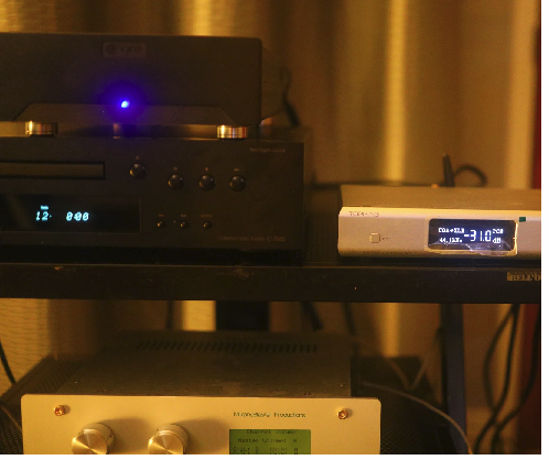

Of interest is the small and very light weight Hypex NC400 monoblock amps which will be used in the show. One of them is the small black box with the blue LED sitting above Dennis's old CD player. I don't know where the other one is. Some of the other gear allows Dennis to instantly switch between the BMR Towers and Monitors while playing at the same volume.
I'll go there tomorrow to see the whole show, and I'll bring my camera.

Early word is that the BMR Towers are the darlings of the show at Capital Audio Fest!
Can't wait for @Swerd to share his experience.
Again, @D Murphy , congratulations. :D
