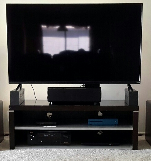

Is there a rule of thumb for when a phantom center is better than using a center channel (e.g., if the L&R are less than a certain distance apart)? I've been looking at a new, larger TV to replace the one in this pic, and if used on its stand the center channel will block the screen. The wall that everything is on is only 7 feet long so the speakers are only maybe 6 feet from each other.
There are potential issues with mounting the TV, so I'm trying to decide if I should just go with a. phantom center. IMG_0291.jpg

You could paint a block of wood black and set your tv on it. Looks like you only need to raise it a little bit. Otherwise phantom should work just fine too. That one is easy to test. Just turn your center off in the speaker settings and see how it sounds. If you play with your speaker toe-in that can help bring the center image into focus too.
But yeah, I'd just find something to put under the monitor and raise it up a couple of inches.
*Edit: It might not hurt to tilt your center up a little bit too. Try to aim the tweeter up so it points at your head at ear height.

Thanks. The pic is my current set and the screen is only blocked a fraction, so not a big deal. A newer set would be much lower on a stand and wouldn't have bezels so much more of it would be covered. I would have to build a stand to raise it about 6 inches.

I agree with Pogre in that getting the TV raised up a bit would be the path I would choose. If the Mains were more dynamic like towers can be, I would say you could probably rock the Phantom. May work with your standmounts, too.
Some blue museum putty and some peices of 4x6 spray painted satin black is all it would take, from the sound of it.
One note... make certain you know where the Remote sensor is... my Center interferes with it... have to hold my remote at nose level to get any traction. ;)
I don't know if this would work with your new tv, it depends on the feet, but here's what I did with an older setup I had.
I had a spare chunk of 4" x 6" lumber leftover from a project. I cut 2 lengths and stained them black. I don't think it looked too shabby and it was a cheap solution.
