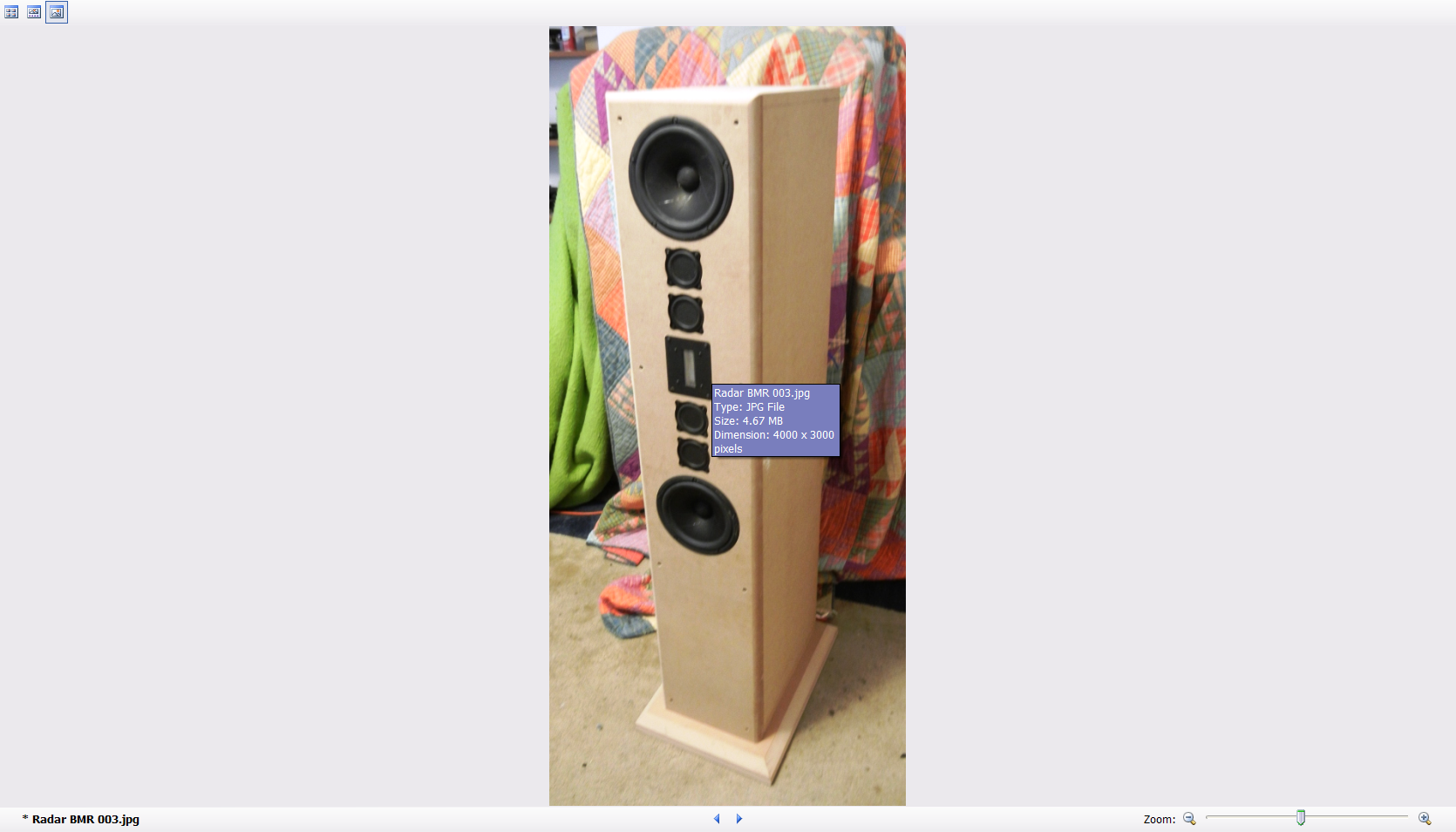

The much more complicated issue is that of controlled vertical directivity. Reducing floor and ceiling reflections in a controlled manner certainly has intuitive appeal, and I participated in an experiment with a local electrical engineer to see whether such a response pattern could be implemented in a tower version of my BMR using concepts borrowed from radar radiation theory, which was my friend's specialty. The approach required 7 drivers critically spaced and integrated drivers with asymmetrical crossover slopes, and differing output levels for the two sets of BMR midrange drivers. It could be that the theoretical basis was similar to that used by Perlisten, although as the picture below shows, no wave guide was involved. In addition to the "radar" crossover slopes used to control and restrict vertical directivity, I also developed a perfectly conventional crossover using garden-variety 4th order Linkwitz-Riley slopes with no particular consideration of vertical directivity, which was quite ragged given the layout of the drivers.
The Radar version of the tower pretty much hit the target radiation pattern, and the vertical dispersion was definitely narrower and more even than for the conventional crossover slopes. I thought the Radar version sounded great--clear as a bell and very neutral. I thought the regular tower sounded great--clear as a bell and very neutral. I just listened to Erin's very interesting interview with Floyd Toole, which touched on vertical dispersion issues. In uncharacteristic fashion, Floyd punted when it came to whether or not there were audible virtues to restricting vertical dispersion. He claimed that people are so used to hearing floor reflections in real life that listeners thought one of his speakers that limited floor bounce just sounded kind of weird. His remarks on ceiling reflections were less focused, but unlike his opinions concerning just about every other aspect of sound reproduction, Floyd just shrugged his shoulders on this one.
All of this isn't to throw any doubt on the quality of the Perlisten speaker. The measurements pretty much tell the story. But I don't think we're at the point where we can say with any certainty that Perlisten's attention to vertical directivity is an important contributor to James' enjoyment of the speakers. I think we all need to keep an open mind on this issue and recognize that the returns aren't in on this one yet.
All of this isn't to throw any doubt on the quality of the Perlisten speaker. The measurements pretty much tell the story. But I don't think we're at the point where we can say with any certainty that Perlisten's attention to vertical directivity is an important contributor to James' enjoyment of the speakers. I think we all need to keep an open mind on this issue and recognize that the returns aren't in on this one yet.View attachment 47823

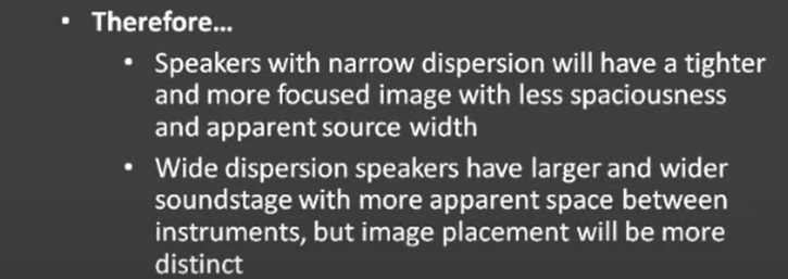

Just a followup:
Watching the first video, and I screencapped this specifically:
This, along with your assertion in the video about live recordings versus studio recordings et al, seem weird to me, because I have a pair of extremely narrow dispersion speakers (Belle Klipsch), and we listen to a ton of live recordings. Even my wife, who is a complete novice regarding acoustics and sound, finds it remarkable how immersive an experience it is listening on this system, "as though you're right there in the audience" is a frequent comment from her.
Granted, there are a lot of moving parts involved here, such as the fact that I do NOT toe the speakers inward to our primary listening space (an aesthetic choice I had to make to keep the peace) and the fact that this is a very, very live room, with glass sliders and tiled floor (though there is a carpet and the furniture is fabric), and I haven't treated it at all yet. The big advantage I have regarding treatment in this room is the utter lack of bass nulls, because the room is L-shaped and has numerous outcroppings and doorway/entry points that disrupt virtually all the parallel surfaces except floor/ceiling.
But I did find it interesting, anyway. Otherwise, it's a fascinating discussion.
These are well established phenomena backed up by lab experiments. Though apparently I had a typo. That second bullet point should say image placement is less distinct, not more.
But live recordings isn't the same thing as a symphony. I think you have to keep in mind what we are comparing here. it is not live vs studio. It is large natural acoustic recordings vs those which lack those large natural spatial cues.
For the most part, a speakers radiation pattern has no impact on apparently source width in an anechoic environment. We hear all speakers as essentially point sources. That is why evaluating speakers in an anechoic chamber tells you so little about its sound. Place it in a room with reflections however and the dispersion pattern dictates the ASW. This is a fact, not an opinion. The wider the dispersion, the greater the ASW.
But something else comes along with this, the wider the dispersion, the higher the ASW, the lower the phantom object specificity. That is, it becomes harder to hear exactly where a phantom image is coming from. With a large orchestra in a symphonic hall, this is quite natural. If you look at David Griesinger's work on proximity, you will see this is a phenomena he finds to be true in symphonies too. But his work also raises an issue. He finds that the higher the proximity score the better someone perceives the quality of the performance. That means that the greater the direct to reflected sound ratio (caused by sitting with greater proximity to the source, among other things) the better we can delineate the instruments in the sound stage and prefer this. That suggests that overly reflective rooms with overly wide dispersion is not a good thing. It's a balancing act.
Again, that is what is true for a symphony.
