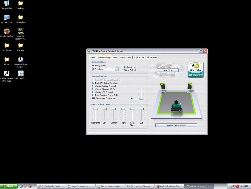

Creative uses the 1/8 size jack on they're digital output as well. The 1/8 to RCA cables works there. That's weird how you can't have both running at the same time... My soundstorm is probably the best on board audio ever made..
The only reason to stay socket A :)
