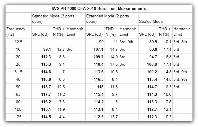

@bravo79 - All I got from that is Sealed RULES and ported is a compromise created by a need for more output efficiency at the cost of accurate reproduction. You're at least a full cycle off (distortion of a sort) before it even exits the port. Period. No getting around the fact ALL ported enclosures are distorted. If you can live with knowing your system is not accurate, well more power to you (literally). If you need to know it's accurate, you NEED Sealed (and not just sealed, but sealed with a damn good driver and enough power to drive it).
Too simplified? Well, that's the only thing the guy really needed to say. The rest is just subjective opinion by people that make unsubstantiated claims. ;)
Keep in mind none of that is my personal opinion, simply what I got out of the video. :D
The video is kind of right. Ported subs will have more group delay in port generated output. However it is almost exactly 1 cycle behind the driver signal, so it really sounds matched to the driver output. The only way it would ever sound unmatched is if the signal changed so drastically that one cycle is entirely unlike the next cycle. That doesn't really happen very much, and our ability to discern group delay and phase distortion at low frequencies is not very good as it is. So a cycle of delay centered around a really deep port tuning frequency like say 25 Hz is just fine. It's more of an issue in port tunings in upper frequencies where our hearing is far more acute. In fact this is where ported subs get a bad reputation for sound quality, its from crappy bandpass subs that come in HTiB sets with port tuning around 50 Hz. A GOOD ported sub sound is as sharp as a tack.
And a qualitative disadvantage regarding sealed designs that is only mentioned once and glossed over by the video is the toll taken on the driver from trying to reproduce low frequencies in a sealed design. In a ported design, at port resonance, the driver's motion actually lessens, so the coil stays in a very controlled region within the motor. So ported designs can be seen to lower in distortion as they approach the port tuning frequency from higher frequencies. But the coils in sealed design's have to move way more to achieve the same SPL, and this means much more distortion. It also means much more compression and a lot less headroom. In this respect, sealed designs are less linear and less accurate than ported designs, all other things being equal. And what's more, they are more inaccurate in a way that is more readily perceivable.
VonMagnum
VonMagnum
@shadyJ - So what you're really boiling it down to is that sealed designs have less output and therefore more distortion if pushed past a certain point, which all in all congeals with the aforementioned idea that ported boxes produce MORE OUTPUT, MORE EFFICIENTLY (at the cost of group delay distortion, however inaudible it may be).
Thus, you need a larger sealed sub with more power to achieve the same output levels with lower distortion as a ported box. But a sufficiently large sealed sub will always outperform the ported sub in basic design (i.e. group delay) as that flaw is inherent to the design of the ported sub and cannot be removed no matter how much money you put into a ported design. In other words, money no object, you'd still wanted sealed for the lowest possible overall distortion because there is no way possible to overcome the one flaw of a ported design, which is the delay induced by the back wave of the driver.
If cost, power requirements and/or space issues are a serious impediment you would likely have to consider a ported design for such constraints and generally speaking those are the only reasons to consider a ported design in the first place.
Would you say those are accurate statements?
shadyJ
Speaker of the House
Staff member
I would agree with those statements. One thing that shouldn't be understated is how much more clean headroom that a ported sub offers over a sealed sub around port generated output. Let's take a look at an example:
Compare the huge headroom advantage that the port gives the ported operating mode over the sealed operating mode at port tuning. It can be as much as 12 dB and with less distortion. That means you would need four of the sealed mode subs to equal a single port mode sub at 16 to 25 Hz. Keep in mind that is just talking about dynamic range limitations and nonlinear distortions. Ported can also have an advantage in linear distortion as well, because it can hold a flatter response shape over a greater range.
You might say that there is no reason not to go full sealed in an all-out cost-no-object system, and I might agree with that. But the very moment that other criteria enters the picture regarding performance, ported can become a viable alternative, even in a pricey system.
